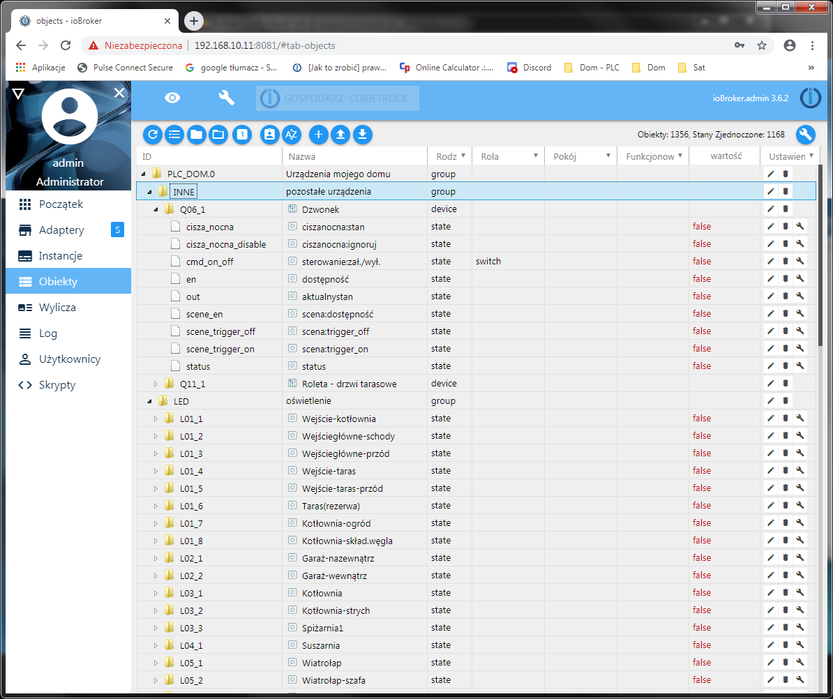

    I try to update my nodejs in my iobroker from version 6 to version 8.
    And now i have big problem - after every iobroker restart objects disappear from a objcets tree in "obiekty" ("Objects") card.
    See picture before restart:
    .. and after (missing objects and states):
    upgrade version are:
    node/nodejs: 8.16.0
    npm (downgrade) 4.6.1
    ioBroker.admin 3.6.2
    Any idea for them ?

          mguc
          @liv-in-sky
          No, it isn't any adapter. It's my own structure. On nodejs6 all works very well. After upgrade (with npm rebuild) to nodejs8 (and nodejs 10 too) not work.
          Yesterday i removed all (nodejs and iobroker) and install from begin nodejs8 and iobroker from install script. And still not work.
          Other question - where are property place to add my own data structure (like in top picture called "PLC.DOM"?

            liv-in-skyL Offline
            liv-in-skyL Offline
            liv-in-sky
            @mguc I think your structure seems to right - this is e.g. my strukture
            "controll-own.0 is the start of my datapoints
            one difference is that your typ (rodz...) is a GROUP - I don't know what this means - try to make a new strukture
            make a new datapoint like - my-datapoints.0.PLC_COM.Q06_1.en and save it - than you have a new strukture whre you can use
            make sure that nothin on the righjt side is marked -
            also choose "Datenpunkt" and "zahl" even if it is already standing there - mark it - sometime there a problems
            maybe this helps

              mguc
              @liv-in-sky
              Thanks for info. For test i created 2 nodes: "DOM-PLC.0" and "DOM.PLC". For create I use only "device", "channel", "data point" from edit window.
              A now it's look some like that:
              After up to 4 server reboot (and refresh browser window) all still looks fine.
              Maybe incorrect was used other words for "rules" like group, meta and others.
              I don't know is "DOM.PLC" is correct name, but it's work ;)
              Thanks for help.

                AlCalzone
                @mguc sagte in Disappearing objects:
                This might generate some problems in the long run.
                All object trees are supposed to start with the pattern <some-name>.<number>. That means DOM-PLC.0 should be okay, DOM.PLC might not be.

                  mguc
                  @AlCalzone
                  Ok. I use DOM-PLC.0 or somethink like that (with number on end).
