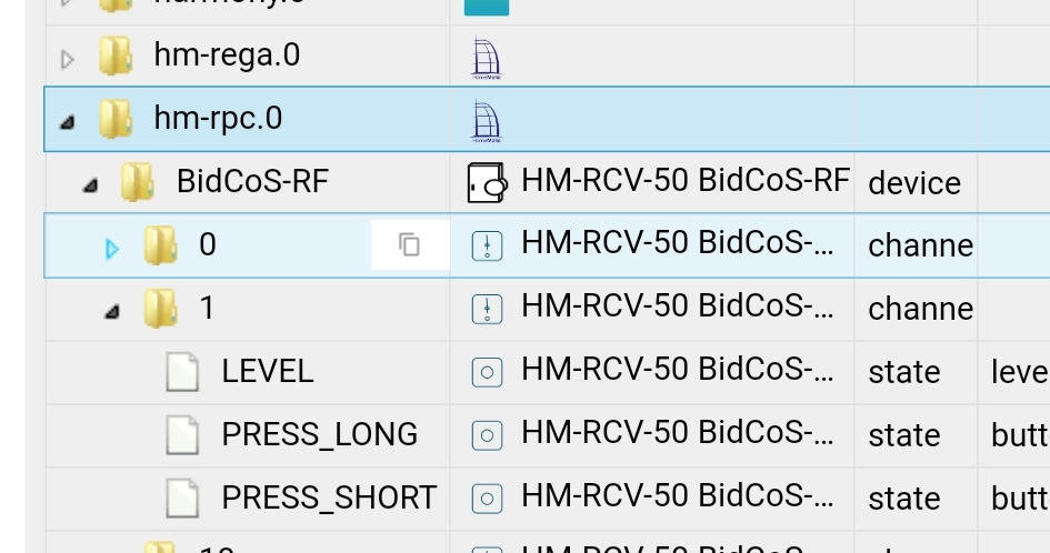

      Den virtuellen Taster siehst du aber unter den Rega Objekten?

        Ich vermute, es hängt damit zusammen, dass die Widgets nur boolsche Bedingungen (true/false) können.
        Die VT machen ja so was wie "shortpress" und "longpress".

          Und das sind zwei Datenpunkte, die musst du je nach bedarf mit dem widget steuern.

            Also ich mache das z.B. so:
            Virtueller Taster von hier (hoffe du meinst diese):
            Und nutze z.B. das Widget:
            [{"tpl":"tplJquiButtonState","data":{"oid":"hm-rpc.0.BidCoS-RF.48.PRESS_SHORT","visibility-cond":"==","visibility-val":1,"buttontext":"Auf","value":"true","visibility-groups-action":"hide","signals-cond-0":"==","signals-val-0":true,"signals-icon-0":"/vis/signals/lowbattery.png","signals-icon-size-0":0,"signals-blink-0":false,"signals-horz-0":0,"signals-vert-0":0,"signals-hide-edit-0":false,"signals-cond-1":"==","signals-val-1":true,"signals-icon-1":"/vis/signals/lowbattery.png","signals-icon-size-1":0,"signals-blink-1":false,"signals-horz-1":0,"signals-vert-1":0,"signals-hide-edit-1":false,"signals-cond-2":"==","signals-val-2":true,"signals-icon-2":"/vis/signals/lowbattery.png","signals-icon-size-2":0,"signals-blink-2":false,"signals-horz-2":0,"signals-vert-2":0,"signals-hide-edit-2":false,"lc-type":"last-change","lc-is-interval":true,"lc-is-moment":false,"lc-format":"","lc-position-vert":"top","lc-position-horz":"right","lc-offset-vert":0,"lc-offset-horz":0,"lc-font-size":"12px","lc-font-family":"","lc-font-style":"","lc-bkg-color":"","lc-color":"","lc-border-width":"0","lc-border-style":"","lc-border-color":"","lc-border-radius":10,"lc-zindex":0,"name":"Schalter Rollladen alle AUF"},"style":{"left":"1019px","top":"114px","width":"125px","height":"228px","font-size":"xx-large","z-index":"5","border-width":"1px","border-style":"solid","border-color":"#FFFFFF","border-radius":"2px"},"widgetSet":"jqui"}]

              Auf die Lösung bin ich letztendlich gekommen, als ich das Widget von wendy2702 importiert habe:
              Als Wert muss "true" eingetragen werden. Ich hatte immer 1 probiert. 1/0 funktioniert m.E. auch bei z.B. boolschen Systemvariablen.

                @hmanfred sagte in [gelöst] Virtuellen CCU-Taster direkt in VIS betätigen:
                Es muss immer das eingetragen werden, was unter Objects steht
                Es gibt Datenpunkte die das intern umwandeln
