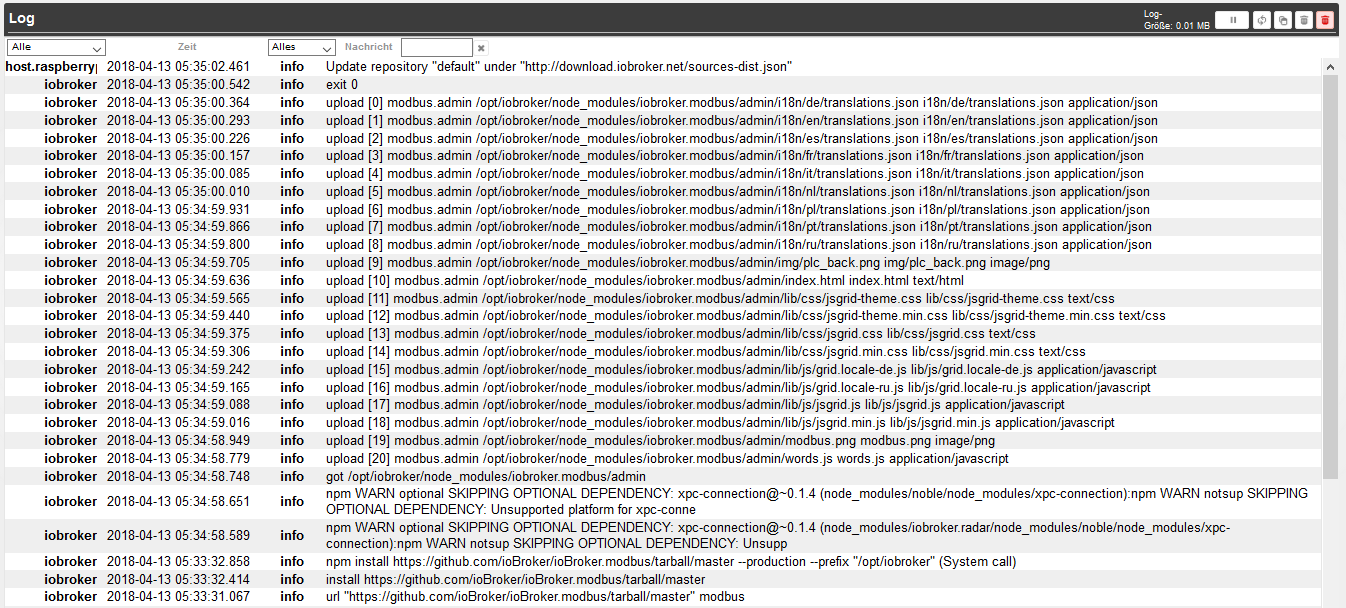

                                modbus.1 2018-04-03 22:06:35.343 warn Poll error count: 4 code: "App Timeout"
                                modbus.1 2018-04-03 22:06:29.137 warn Poll error count: 3 code: "App Timeout"
                                modbus.1 2018-04-03 22:06:22.930 warn Poll error count: 2 code: "App Timeout"
                                modbus.1 2018-04-03 22:06:16.707 warn Poll error count: 1 code: "App Timeout"
                                mbus.0 2018-04-03 22:03:22.131 info Process: 2
                                mbus.0 2018-04-03 22:02:54.655 error M-Bus Devices errored: 1 from 4
                                mbus.0 2018-04-03 22:02:54.652 error M-Bus ID 1 err: Error: Error: Failed to receive M-Bus response frame[1].
                                mbus.0 2018-04-03 22:02:45.628 info Process: 1
                                host.ioBroker-RPi1 2018-04-03 21:56:43.053 info Update repository "default" under "http://download.iobroker.net/sources-dist.json"
                                iobroker 2018-04-03 21:56:42.079 info exit 0
                                iobroker 2018-04-03 21:56:41.922 info upload [0] modbus.admin /opt/iobroker/node_modules/iobroker.modbus/admin/i18n/de/translations.json i18n/de/translations.json application/json
                                iobroker 2018-04-03 21:56:41.851 info upload [1] modbus.admin /opt/iobroker/node_modules/iobroker.modbus/admin/i18n/en/translations.json i18n/en/translations.json application/json
                                iobroker 2018-04-03 21:56:41.780 info upload [2] modbus.admin /opt/iobroker/node_modules/iobroker.modbus/admin/i18n/es/translations.json i18n/es/translations.json application/json
                                iobroker 2018-04-03 21:56:41.699 info upload [3] modbus.admin /opt/iobroker/node_modules/iobroker.modbus/admin/i18n/fr/translations.json i18n/fr/translations.json application/json
                                iobroker 2018-04-03 21:56:41.634 info upload [4] modbus.admin /opt/iobroker/node_modules/iobroker.modbus/admin/i18n/it/translations.json i18n/it/translations.json application/json
                                iobroker 2018-04-03 21:56:41.565 info upload [5] modbus.admin /opt/iobroker/node_modules/iobroker.modbus/admin/i18n/nl/translations.json i18n/nl/translations.json application/json
                                iobroker 2018-04-03 21:56:41.500 info upload [6] modbus.admin /opt/iobroker/node_modules/iobroker.modbus/admin/i18n/pl/translations.json i18n/pl/translations.json application/json
                                iobroker 2018-04-03 21:56:41.432 info upload [7] modbus.admin /opt/iobroker/node_modules/iobroker.modbus/admin/i18n/pt/translations.json i18n/pt/translations.json application/json
                                iobroker 2018-04-03 21:56:38.056 info upload [8] modbus.admin /opt/iobroker/node_modules/iobroker.modbus/admin/i18n/ru/translations.json i18n/ru/translations.json application/json
                                iobroker 2018-04-03 21:56:37.915 info upload [9] modbus.admin /opt/iobroker/node_modules/iobroker.modbus/admin/img/plc_back.png img/plc_back.png image/png
                                iobroker 2018-04-03 21:56:37.845 info upload [10] modbus.admin /opt/iobroker/node_modules/iobroker.modbus/admin/index.html index.html text/html
                                iobroker 2018-04-03 21:56:37.774 info upload [11] modbus.admin /opt/iobroker/node_modules/iobroker.modbus/admin/lib/css/jsgrid-theme.css lib/css/jsgrid-theme.css text/css
                                iobroker 2018-04-03 21:56:37.708 info upload [12] modbus.admin /opt/iobroker/node_modules/iobroker.modbus/admin/lib/css/jsgrid-theme.min.css lib/css/jsgrid-theme.min.css text/css
                                iobroker 2018-04-03 21:56:37.623 info upload [13] modbus.admin /opt/iobroker/node_modules/iobroker.modbus/admin/lib/css/jsgrid.css lib/css/jsgrid.css text/css
                                iobroker 2018-04-03 21:56:37.564 info upload [14] modbus.admin /opt/iobroker/node_modules/iobroker.modbus/admin/lib/css/jsgrid.min.css lib/css/jsgrid.min.css text/css
                                iobroker 2018-04-03 21:56:37.506 info upload [15] modbus.admin /opt/iobroker/node_modules/iobroker.modbus/admin/lib/js/grid.locale-de.js lib/js/grid.locale-de.js application/javascript
                                iobroker 2018-04-03 21:56:37.442 info upload [16] modbus.admin /opt/iobroker/node_modules/iobroker.modbus/admin/lib/js/grid.locale-ru.js lib/js/grid.locale-ru.js application/javascript
                                iobroker 2018-04-03 21:56:37.370 info upload [17] modbus.admin /opt/iobroker/node_modules/iobroker.modbus/admin/lib/js/jsgrid.js lib/js/jsgrid.js application/javascript
                                iobroker 2018-04-03 21:56:37.304 info upload [18] modbus.admin /opt/iobroker/node_modules/iobroker.modbus/admin/lib/js/jsgrid.min.js lib/js/jsgrid.min.js application/javascript
                                iobroker 2018-04-03 21:56:37.236 info upload [19] modbus.admin /opt/iobroker/node_modules/iobroker.modbus/admin/modbus.png modbus.png image/png
                                iobroker 2018-04-03 21:56:37.100 info upload [20] modbus.admin /opt/iobroker/node_modules/iobroker.modbus/admin/words.js words.js application/javascript
                                iobroker 2018-04-03 21:56:37.073 info got /opt/iobroker/node_modules/iobroker.modbus/admin
                                iobroker 2018-04-03 21:55:16.281 info npm install https://github.com/ioBroker/ioBroker.mo … all/master --production --prefix "/opt/iobroker" (System call)
                                iobroker 2018-04-03 21:55:15.732 info install https://github.com/ioBroker/ioBroker.mo ... all/master
                                iobroker 2018-04-03 21:55:14.543 info url "https://github.com/ioBroker/ioBroker.mo ... all/master" modbus `

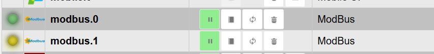

                                Was mir gar nicht gefällt ist die Status-LED vom Adapter. Diese zeigt nun dauerhaft gelb.
                                Ich habe den Adapter neu geladen und dann ging die LED wieder auf grün.
                                    Ich habe den Adapter neu geladen und dann ging die LED wieder auf grün. `
                                    Hattest Du nach dem Github install das manuelle restart vergessen? Er hat im letzten Log immer noch bis >18 gezählt …. Aber inzwischen hat er ja neu gestartet. Wie ists jetzt?
                                    Das Gelb heist "Adapter läuft, aber connection ist aktuell "Nicht da" ... weist also auf Verbindungsprobleme hin.
