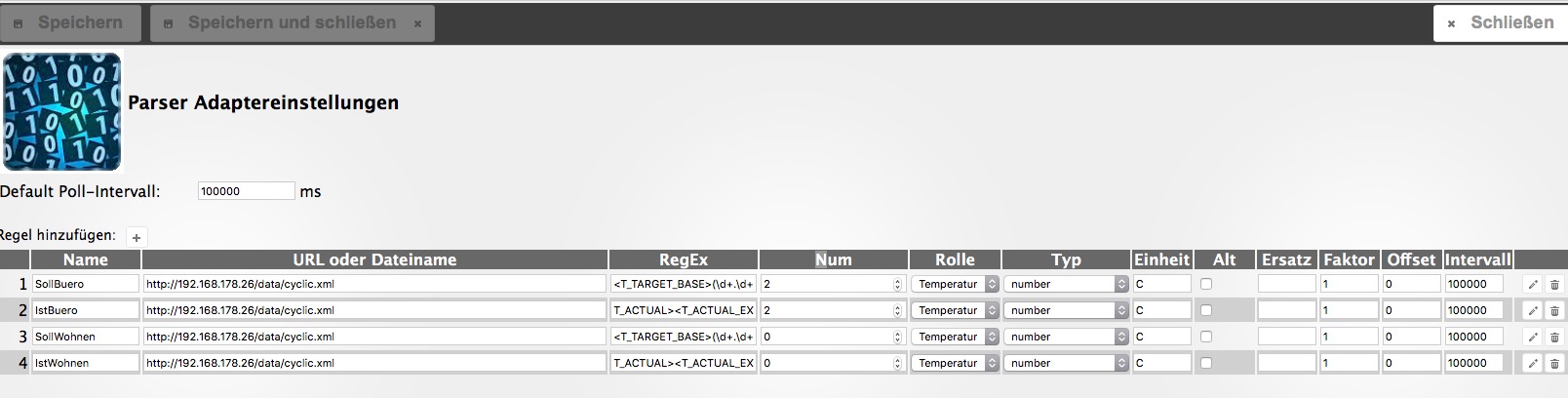

          Ich habe nun endeckt, dass mir die Daten auch über XML zur Verfügung gestellt werden. Somit kann ich das XML File mit dem Parser einlesen :-)
          Das Problem ist aber jetzt, dass ich die Werte teilweise orange sind und den Fehler 0x44 device error melden.
          Ist hier evtl meine RegEx Funktion schuld?
          <t_target_base>(\d+.\d+)</t_target_base>
          T_ACTUAL><t_actual_ext>(\d+.\d+)</t_actual_ext>
          <heatarea nr="1"><heatarea_mode>0</heatarea_mode><t_actual>23.5</t_actual><t_actual_ext>23.5</t_actual_ext><t_target>22.6</t_target><t_target_base>22.6</t_target_base><heatarea_state>0</heatarea_state><program_source>0</program_source><program_week>0</program_week><program_weekend>0</program_weekend><party>0</party><party_remainingtime>0</party_remainingtime><presence>0</presence><islocked>0</islocked></heatarea><heatarea nr="4"><heatarea_mode>0</heatarea_mode><t_actual>22.0</t_actual><t_actual_ext>22.0</t_actual_ext><t_target>22.0</t_target><t_target_base>22.0</t_target_base><heatarea_state>0</heatarea_state><program_source>0</program_source><program_week>0</program_week><program_weekend>0</program_weekend><party>0</party><party_remainingtime>0</party_remainingtime><presence>0</presence><islocked>0</islocked></heatarea><heatarea nr="6"><heatarea_mode>0</heatarea_mode><t_actual>22.7</t_actual><t_actual_ext>22.7</t_actual_ext><t_target>21.4</t_target><t_target_base>21.4</t_target_base><heatarea_state>0</heatarea_state><program_source>0</program_source><program_week>0</program_week><program_weekend>0</program_weekend><party>0</party><party_remainingtime>0</party_remainingtime><presence>0</presence><islocked>0</islocked></heatarea><heatarea nr="7"><heatarea_mode>0</heatarea_mode><t_actual>21.8</t_actual><t_actual_ext>21.8</t_actual_ext><t_target>20.0</t_target><t_target_base>20.0</t_target_base><heatarea_state>0</heatarea_state><program_source>0</program_source><program_week>0</program_week><program_weekend>0</program_weekend><party>0</party><party_remainingtime>0</party_remainingtime><presence>0</presence><islocked>0</islocked></heatarea><heatarea nr="8"><heatarea_mode>0</heatarea_mode><t_actual>23.5</t_actual><t_actual_ext>23.5</t_actual_ext><t_target>21.0</t_target><t_target_base>21.0</t_target_base><heatarea_state>0</heatarea_state><program_source>0</program_source><program_week>0</program_week><program_weekend>0</program_weekend><party>0</party><party_remainingtime>0</party_remainingtime><presence>0</presence><islocked>0</islocked></heatarea>

            @0815broker:
            Ist hier evtl meine RegEx Funktion schuld? `
            Was willst du denn auslesen?
            Dein Regex funktioniert nicht, wenn es denn eins ist.
            Aufgeteilt in 2 Teile ergibt jeder 5 Ergebnisse.

                etwas kürzer geht es auch mit
                SE>([^<]+)

                  Es soll der TARGET BASE und den ACTUAL EXT für jede Nr. ausgelesen werden.
                  Ich dachte die Spalte Num bedeutet, dass ich den erkannten 1 und den 3 erkannten Wert auslese.

                    @0815broker:
                    Ich dachte die Spalte Num bedeutet, dass ich den erkannten 1 und den 3 erkannten Wert auslese. `
                    korrekt!
                    Ich habe dir jetzt auch nur den RegEx für Target Base gegeben, der für Actual_ext sähe verkürzt so aus:
                    XT>([^<]+)

                      TOP !!!
                      Vielen Dank und schon läufts :D
