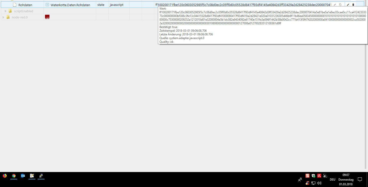

    Hallo Franz,
    doch, es landet etwas in dem Datenpunkt.
    Aber immer nur das letzte der Ausgabe und nicht der komplette String.
    z.B.
    Ergebnis der Abfrage in der Console:
    08:54:57.546	[info]	javascript.0 script.js.Parser: Data: ff
    08:54:57.562	[info]	javascript.0 script.js.Parser: Data: 100200171fbe120c0603052918
    08:54:57.577	[info]	javascript.0 script.js.Parser: Data: 33cdc01191bfc0ffe9d3c0fb56
    08:54:57.592	[info]	javascript.0 script.js.Parser: Data: d8413d84de4165fb0742d3
    08:54:57.608	[info]	javascript.0 script.js.Parser: Data: ff334212c928425238dec20000
    08:54:57.625	[info]	javascript.0 script.js.Parser: Data: 704156ee5abeefa68dc0d000
    08:54:57.640	[info]	javascript.0 script.js.Parser: Data: 01c1c5c011429a9999bf0000
    08:54:57.656	[info]	javascript.0 script.js.Parser: Data: 0000b1e7933f61560341fb56
    08:54:57.673	[info]	javascript.0 script.js.Parser: Data: d8413d84de41000090413d84de
    08:54:57.689	[info]	javascript.0 script.js.Parser: Data: 4112c928421333090103126a
    08:54:57.704	[info]	javascript.0 script.js.Parser: Data: 2f5d46eaf01b46ea05834500
    08:54:57.720	[info]	javascript.0 script.js.Parser: Data: 00000001010101010101010101
    08:54:57.737	[info]	javascript.0 script.js.Parser: Data: 01010000000000c753000002
    08:54:57.752	[info]	javascript.0 script.js.Parser: Data: 09252a1212010d01e3200000
    08:54:57.768	[info]	javascript.0 script.js.Parser: Data: 4e5b1dc082e9434092e61740
    08:54:57.785	[info]	javascript.0 script.js.Parser: Data: e151fe3e096f1442b58b0042cc
    08:54:57.800	[info]	javascript.0 script.js.Parser: Data: 771b413f3f474202000000
    08:54:57.816	[info]	javascript.0 script.js.Parser: Data: a04100000000000000002cc502
    08:54:57.833	[info]	javascript.0 script.js.Parser: Data: 0002a320002000000002000000
    08:54:57.848	[info]	javascript.0 script.js.Parser: Data: 0000000003010808000000
    08:54:57.864	[info]	javascript.0 script.js.Parser: Data: 00000000012700890127002835
    08:54:57.880	[info]	javascript.0 script.js.Parser: Data: 1210039197ff
    Eintrag im Datenpunkt:
    Das versuche ich jetzt zu lösen…

      Also vorausgesetzt die Antwort der WP ist immer 253 Zeichen lang kommt es jetzt so im Datenpunkt an:
      Kannst du das so mit deinem Script weiterverarbeiten oder musst du die Leerzeichen haben?
