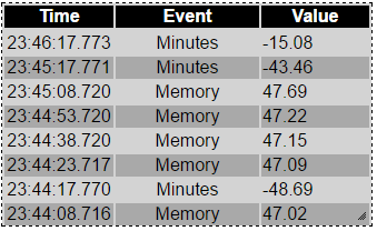

                                  • Bluefox
                                    Bluefox last edited by
                                    Vielleicht wird so was interessant.
                                    Alle events werden aus dem history/sql Adapter gelesen.
                                    `/* Read events from history adapter.
                                       Define the list of IDs, that must be shown.
                                       Additionally for every ID the display name and number of events can be defined.
                                    var historyInstance = 'sql.0'; // can be history adapter too
                                    // ofcourse all IDs must be enabled for history
                                    var states = {
                                        "javascript.0.graph.minutes"/*graph.minutes*/:      { name: 'Minutes', count: 15},
                                        "system.adapter.admin.0.memRss"/*admin.0.memRss*/ : { name: 'Memory'}
                                    var timeout = null; // de-bounce
                                    // create variable, where the list will be stored
                                    createState('eventList', '', function () {
                                        //first execute
                                        readAllEvents();
                                    function publishEvents(events) {
                                        // AS HTML
                                        /*var table = '';
                                        for (var e = 0; e < events.length; e++) {
                                            table += '';
                                        table += '
                                    | ' + formatDate(events[e].time, 'hh:mm:ss.sss') + ' | ' + states[events[e].id].name + ' | ' + events[e].val + ' |
                                        // as JSON
                                           events[e].time = formatDate(events[e].time, 'hh:mm:ss.sss');
                                           events[e].id   = states[events[e].id].name || events[e].id;
                                        setState('eventList', JSON.stringify(events), true);
                                    function readOneId(id, number, events, cb) {
                                        var end = new Date().getTime();
                                        sendTo(historyInstance, 'getHistory', {
                                            options: {
                                                end:        end,
                                                aggregate: 'none',
                                                count:      number || 10
                                        }, function (result) {
                                            if (result.result) {
                                                for (var i = 0; i < result.result.length; i++) {
                                                    events.push({id: id, time: result.result[i].ts, val: result.result[i].val});
                                            cb();
                                    // read events for all IDs
                                    function readAllEvents() {
                                        timeout = null;
                                        var ready = 0;
                                        var events = [];
                                        for (var id in states) {
                                            ready++;
                                            readOneId(id, 10, events, function () {
                                                if (!--ready) {
                                                    events.sort(function (a, b) {
                                                        if (a.time < b.time) return 1;
                                                        if (a.time > b.time) return -1;
                                                        return 0;
                                                    publishEvents(events);
                                    // subscribe on all changes
                                        on(id, function () {
                                            if (timeout) return;
                                            // de-bounce creation
                                            timeout = setTimeout(readAllEvents, 500);
                                     ![48_2016-05-25_23_51_20-edit_vis.png](/assets/uploads/files/48_2016-05-25_23_51_20-edit_vis.png)

                                            um eine Ereignisliste:
                                            filename="Bildschirmfoto 2015-09-06 um 20.46.22.png" index="0">~~
                                            zu erzeugen, kann man folgendes Skript verwenden:

                                                mit den Funktionen sensorsXX Frage ich alle Sensoren, die zu einer Gruppe gehören ab,
                                                bei VS = Verschluß, BW = Bewegung und ST = Statusänderung/Schalter
                                                mit vAlarmanlage Frage ich einen einzelnen Datenpunkt ab, hier eine Variable.
                                                Im unteren Bereich des Skriptes muss zu jeder Funktion eine *.on Funktion dazu erstellt werden.
                                                Diese kann je nach Geräteart die Ausgabe umformulieren.

                                            Ich bekomme es nicht so schön dargestellt mit diesem skript. Welches widget nutzt ihr?
