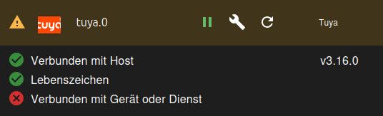

    • Tuya Adapter V 3.16.0 Instanz bleibt rot
      Mein io-Broker läuft als Docker in einer Synology Nas.
      Der installierte Tuya Adapter zeigt folgendes:
      danach ein Login zum Cloud geht jetzt erstmalig:
      Dbug Log:
      tuya.0
      	2025-08-15 17:47:41.337	info	bf10c708588fe2f665pgtk: Connect locally to device
      tuya.0
      	2025-08-15 17:47:41.294	info	bf8009fd481520527b87z0: Connect locally to device
      tuya.0
      	2025-08-15 17:47:40.384	info	bf609dad6ee86ab803yfhc: Connect locally to device
      tuya.0
      	2025-08-15 17:47:39.965	info	IOT Cloud ID/Secret not configured, disabling real time State updates from Cloud MQTT
      tuya.0
      	2025-08-15 17:47:39.739	info	Listen for encrypted local Tuya devices on port 6667
      tuya.0
      	2025-08-15 17:47:39.738	info	Listen for local Tuya devices on port 6666
      tuya.0
      	2025-08-15 17:47:39.532	info	Try to sync devices from Cloud using stored cloud credentials
      tuya.0
      	2025-08-15 17:47:39.529	info	Existing devices initialized
      tuya.0
      	2025-08-15 17:47:39.528	info	bf609dad6ee86ab803yfhc: Connect locally to device
      tuya.0
      	2025-08-15 17:47:39.527	info	bf10c708588fe2f665pgtk: Connect locally to device
      tuya.0
      	2025-08-15 17:47:39.487	info	bf8009fd481520527b87z0: Connect locally to device
      tuya.0
      	2025-08-15 17:47:38.552	info	starting. Version 3.16.0 in /opt/iobroker/node_modules/iobroker.tuya, node: v22.18.0, js-controller: 7.0.6
      host.buanet-iobroker
      	2025-08-15 17:47:36.414	info	instance system.adapter.tuya.0 in version "3.16.0" started with pid 11037
      	2025-08-15 17:47:28.621	info	instance system.adapter.tuya.0 terminated with code 11 (ADAPTER_REQUESTED_TERMINATION)
      tuya.0
      	2025-08-15 17:47:28.080	info	Terminated (ADAPTER_REQUESTED_TERMINATION): Without reason
      tuya.0
      	2025-08-15 17:47:28.079	info	terminating
      	2025-08-15 17:47:25.114	info	stopInstance system.adapter.tuya.0 send kill signal
      tuya.0
      	2025-08-15 17:47:25.076	info	Got terminate signal TERMINATE_YOURSELF
      	2025-08-15 17:47:25.073	info	stopInstance system.adapter.tuya.0 (force=false, process=true)
      tuya.0
      	2025-08-15 17:47:25.064	info	Set data for tuya.0 to appDeviceId=hwihbsdshylho8a4qt0dtjhfvi555113rux8psesml61 / sid=eu175033N2830543eq4dzkm3ddf409efd1973b2032d1820836b12d0b. Restart adapter now!
      tuya.0
      	2025-08-15 17:47:25.064	info	Cloud login successful. Adapter restarts in 5s
      tuya.0
      	2025-08-15 17:47:22.142	info	Listen for encrypted local Tuya devices on port 6667
      tuya.0
      	2025-08-15 17:47:22.141	info	Listen for local Tuya devices on port 6666
      tuya.0
      	2025-08-15 17:47:21.942	info	Try to sync devices from Cloud using stored cloud credentials
      tuya.0
      	2025-08-15 17:47:21.939	info	Existing devices initialized
      tuya.0
      	2025-08-15 17:47:21.938	info	bf609dad6ee86ab803yfhc: Connect locally to device
      tuya.0
      	2025-08-15 17:47:21.933	info	bf10c708588fe2f665pgtk: Connect locally to device
      tuya.0
      	2025-08-15 17:47:21.888	info	bf8009fd481520527b87z0: Connect locally to device
      tuya.0
      	2025-08-15 17:47:21.013	info	starting. Version 3.16.0 in /opt/iobroker/node_modules/iobroker.tuya, node: v22.18.0, js-controller: 7.0.6

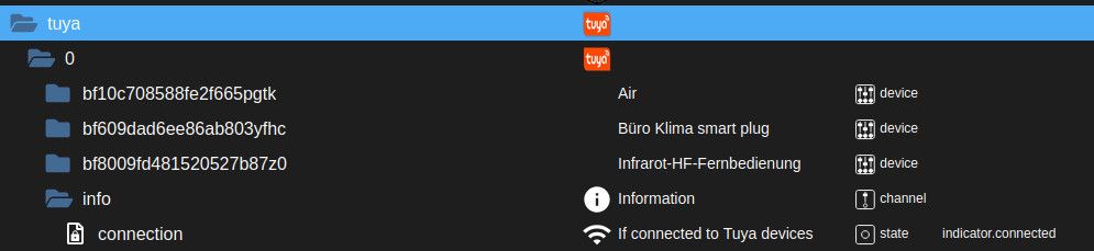

      die Daten werden im Objekt-bereich angezeigt:
      Frage:
      wie bekomm ich verbunden mit Gerät auf Grün, wenn doch Objekte angezeigt werden und lokal alles Verbunden ist?
      Was mach ich falsch??
