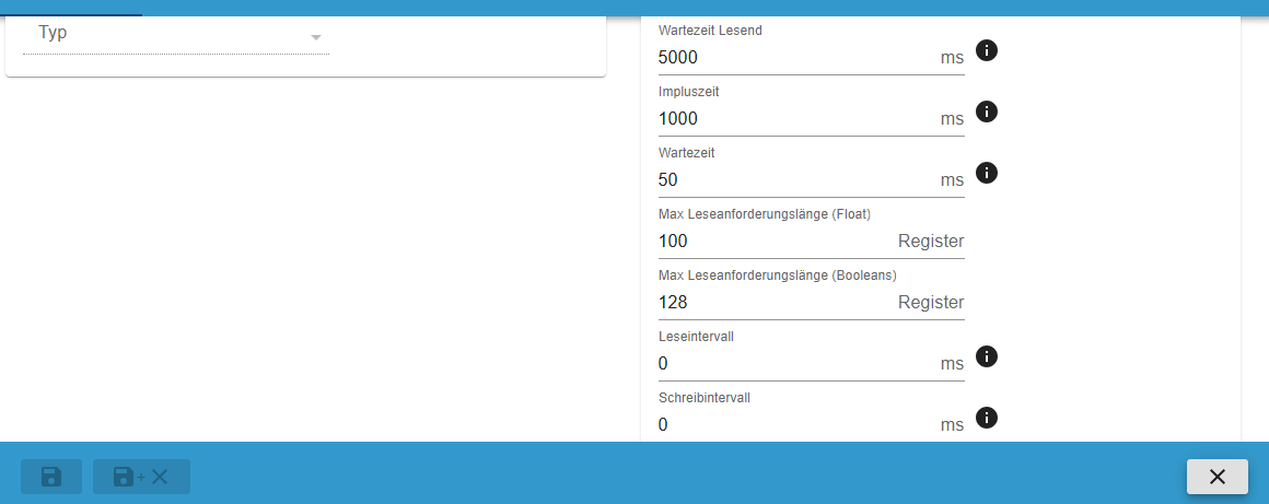

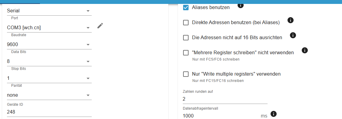

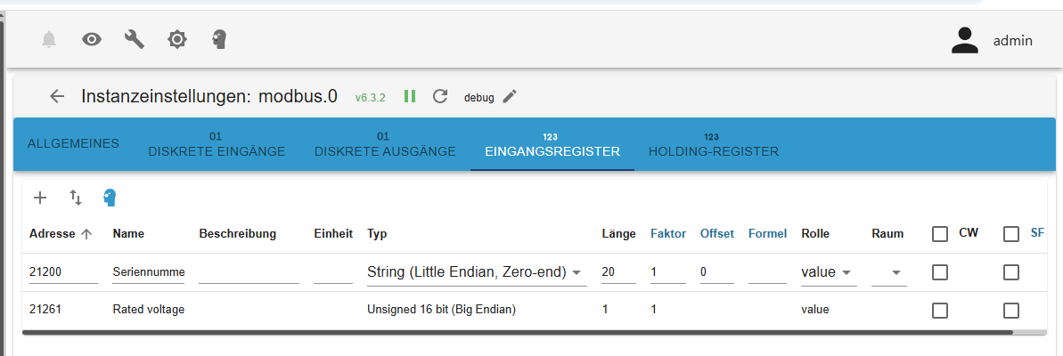

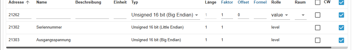

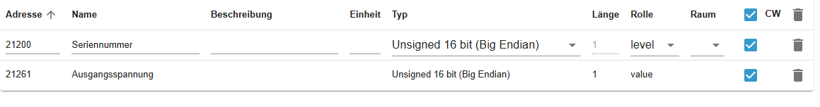

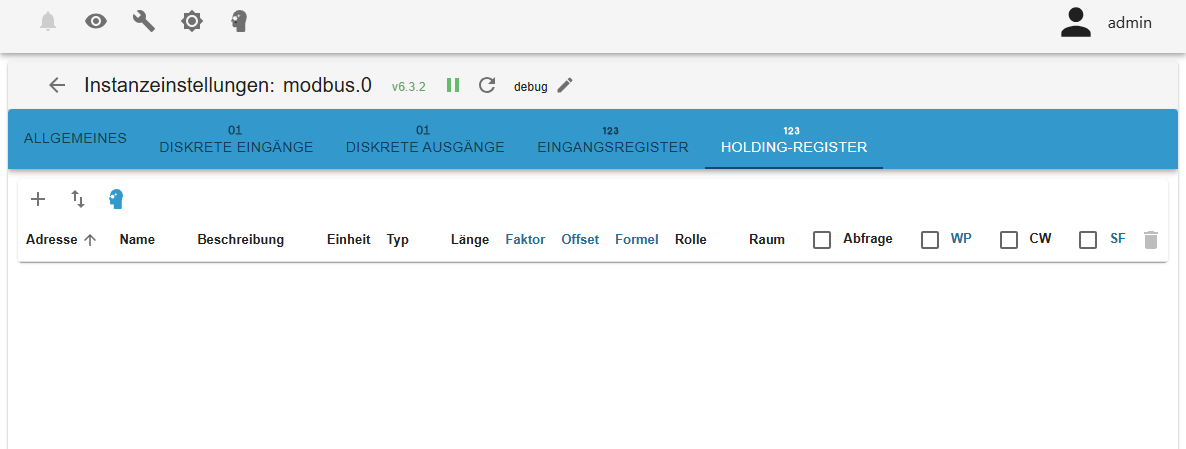

    versuche seit einigen Tagen unsere Wallbox in EVCC zu integrieren. Die Wallbox ist per RJ485 angeschlossen. Leider laufe ich in EVCC immer in einen Timeout.
    Jetzt habe ich eben mal versucht die Wallbox per ioBroker anzusprechen. Bin mir zwar nicht 100% sicher, aber für mich sieht es so aus, also wenn die Wallbox verbunden wäre- Trotzdem bekomme ich keine Daten.
    Habt ihr einen Rat für mich?

    2025-10-01 11:29:39.571 - info: modbus.0 (11564) starting. Version 6.3.2 in C:/ioBroker/node_modules/iobroker.modbus, node: v22.20.0, js-controller: 7.0.7
    2025-10-01 11:29:39.698 - error: modbus.0 (11564) Invalid inputRegisters address: -8701
    2025-10-01 11:29:39.698 - error: modbus.0 (11564) Invalid inputRegisters address: -8702
    2025-10-01 11:29:39.698 - error: modbus.0 (11564) Invalid inputRegisters address: -8740
    2025-10-01 11:29:39.699 - error: modbus.0 (11564) Invalid holdingRegisters address: -18699
    2025-10-01 11:29:39.699 - error: modbus.0 (11564) Invalid holdingRegisters address: -18700
    2025-10-01 11:29:39.699 - error: modbus.0 (11564) Invalid holdingRegisters address: -18801
    2025-10-01 11:29:39.699 - debug: modbus.0 (11564) Initialize Objects for disInputs: []
    2025-10-01 11:29:39.700 - debug: modbus.0 (11564) Initialize Objects for coils: []
    2025-10-01 11:29:39.700 - debug: modbus.0 (11564) Initialize Objects for inputRegs: [{"_address":21261,"name":"","description":"","unit":"","type":"uint16be","len":1,"factor":1,"offset":0,"formula":"","role":"value","room":"","cw":true,"isScale":"","address":-8740,"deviceId":248},{"_address":21299,"name":"","description":"","unit":"","type":"uint16be","len":1,"factor":1,"offset":0,"formula":"","role":"level","room":"","cw":true,"isScale":"","address":-8702,"deviceId":248},{"_address":21300,"name":"","description":"","unit":"","type":"uint16be","len":1,"factor":1,"offset":0,"formula":"","role":"level","room":"","cw":true,"isScale":"","deviceId":248,"address":-8701}]
    2025-10-01 11:29:39.700 - error: modbus.0 (11564) Invalid data inputRegisters/0: {"_address":21261,"name":"","description":"","unit":"","type":"uint16be","len":1,"factor":1,"offset":0,"formula":"","role":"value","room":"","cw":true,"isScale":"","address":-8740,"deviceId":248,"fullId":"modbus.0.0"}
    2025-10-01 11:29:39.700 - error: modbus.0 (11564) Invalid object: {"type":"state","common":{"name":"","role":"value","type":"number","read":true,"write":false,"def":0,"unit":""},"native":{"regType":"inputRegs","address":-8740,"deviceId":248,"type":"uint16be","len":1,"offset":0,"factor":1}}
    2025-10-01 11:29:39.700 - debug: modbus.0 (11564) Add undefined: {"type":"state","common":{"name":"","role":"value","type":"number","read":true,"write":false,"def":0,"unit":""},"native":{"regType":"inputRegs","address":-8740,"deviceId":248,"type":"uint16be","len":1,"offset":0,"factor":1}}
    2025-10-01 11:29:39.701 - error: modbus.0 (11564) Invalid data inputRegisters/1: {"_address":21299,"name":"","description":"","unit":"","type":"uint16be","len":1,"factor":1,"offset":0,"formula":"","role":"level","room":"","cw":true,"isScale":"","address":-8702,"deviceId":248,"fullId":"modbus.0.1"}
    2025-10-01 11:29:39.701 - error: modbus.0 (11564) Invalid object: {"type":"state","common":{"name":"","role":"level","type":"number","read":true,"write":false,"def":0,"unit":""},"native":{"regType":"inputRegs","address":-8702,"deviceId":248,"type":"uint16be","len":1,"offset":0,"factor":1}}
    2025-10-01 11:29:39.701 - debug: modbus.0 (11564) Add undefined: {"type":"state","common":{"name":"","role":"level","type":"number","read":true,"write":false,"def":0,"unit":""},"native":{"regType":"inputRegs","address":-8702,"deviceId":248,"type":"uint16be","len":1,"offset":0,"factor":1}}
    2025-10-01 11:29:39.701 - error: modbus.0 (11564) Invalid data inputRegisters/2: {"_address":21300,"name":"","description":"","unit":"","type":"uint16be","len":1,"factor":1,"offset":0,"formula":"","role":"level","room":"","cw":true,"isScale":"","deviceId":248,"address":-8701,"fullId":"modbus.0.2"}
    2025-10-01 11:29:39.701 - error: modbus.0 (11564) Invalid object: {"type":"state","common":{"name":"","role":"level","type":"number","read":true,"write":false,"def":0,"unit":""},"native":{"regType":"inputRegs","address":-8701,"deviceId":248,"type":"uint16be","len":1,"offset":0,"factor":1}}
    2025-10-01 11:29:39.701 - debug: modbus.0 (11564) Add undefined: {"type":"state","common":{"name":"","role":"level","type":"number","read":true,"write":false,"def":0,"unit":""},"native":{"regType":"inputRegs","address":-8701,"deviceId":248,"type":"uint16be","len":1,"offset":0,"factor":1}}
    2025-10-01 11:29:39.701 - debug: modbus.0 (11564) Initialize Objects for holdingRegs: [{"_address":21200,"name":"Seriennummer","description":"","unit":"","type":"uint16be","len":1,"factor":1,"offset":0,"formula":"","role":"state","room":"","poll":true,"wp":"","cw":true,"isScale":"","deviceId":248,"address":-18801},{"_address":21301,"name":"Spannung","description":"","unit":"","type":"uint16be","len":1,"factor":1,"offset":0,"formula":"","role":"level","room":"","poll":true,"wp":"","cw":"","isScale":"","address":-18700,"deviceId":248},{"_address":21302,"name":"Strm","description":"","unit":"","type":"uint16be","len":1,"factor":1,"offset":0,"formula":"","role":"level","room":"","poll":true,"wp":"","cw":"","isScale":"","address":-18699,"deviceId":248}]
    2025-10-01 11:29:39.702 - error: modbus.0 (11564) Invalid data holdingRegisters/0: {"_address":21200,"name":"Seriennummer","description":"","unit":"","type":"uint16be","len":1,"factor":1,"offset":0,"formula":"","role":"state","room":"","poll":true,"wp":"","cw":true,"isScale":"","deviceId":248,"address":-18801,"fullId":"modbus.0.0"}
    2025-10-01 11:29:39.702 - error: modbus.0 (11564) Invalid object: {"type":"state","common":{"name":"","role":"state","type":"number","read":true,"write":true,"def":0,"unit":""},"native":{"regType":"holdingRegs","address":-18801,"deviceId":248,"type":"uint16be","len":1,"offset":0,"factor":1,"poll":true}}
    2025-10-01 11:29:39.702 - debug: modbus.0 (11564) Add undefined: {"type":"state","common":{"name":"","role":"state","type":"number","read":true,"write":true,"def":0,"unit":""},"native":{"regType":"holdingRegs","address":-18801,"deviceId":248,"type":"uint16be","len":1,"offset":0,"factor":1,"poll":true}}
    2025-10-01 11:29:39.702 - error: modbus.0 (11564) Invalid data holdingRegisters/1: {"_address":21301,"name":"Spannung","description":"","unit":"","type":"uint16be","len":1,"factor":1,"offset":0,"formula":"","role":"level","room":"","poll":true,"wp":"","cw":"","isScale":"","address":-18700,"deviceId":248,"fullId":"modbus.0.1"}
    2025-10-01 11:29:39.702 - error: modbus.0 (11564) Invalid object: {"type":"state","common":{"name":"","role":"level","type":"number","read":true,"write":true,"def":0,"unit":""},"native":{"regType":"holdingRegs","address":-18700,"deviceId":248,"type":"uint16be","len":1,"offset":0,"factor":1,"poll":true}}
    2025-10-01 11:29:39.702 - debug: modbus.0 (11564) Add undefined: {"type":"state","common":{"name":"","role":"level","type":"number","read":true,"write":true,"def":0,"unit":""},"native":{"regType":"holdingRegs","address":-18700,"deviceId":248,"type":"uint16be","len":1,"offset":0,"factor":1,"poll":true}}
    2025-10-01 11:29:39.702 - error: modbus.0 (11564) Invalid data holdingRegisters/2: {"_address":21302,"name":"Strm","description":"","unit":"","type":"uint16be","len":1,"factor":1,"offset":0,"formula":"","role":"level","room":"","poll":true,"wp":"","cw":"","isScale":"","address":-18699,"deviceId":248,"fullId":"modbus.0.2"}
    2025-10-01 11:29:39.702 - error: modbus.0 (11564) Invalid object: {"type":"state","common":{"name":"","role":"level","type":"number","read":true,"write":true,"def":0,"unit":""},"native":{"regType":"holdingRegs","address":-18699,"deviceId":248,"type":"uint16be","len":1,"offset":0,"factor":1,"poll":true}}
    2025-10-01 11:29:39.702 - debug: modbus.0 (11564) Add undefined: {"type":"state","common":{"name":"","role":"level","type":"number","read":true,"write":true,"def":0,"unit":""},"native":{"regType":"holdingRegs","address":-18699,"deviceId":248,"type":"uint16be","len":1,"offset":0,"factor":1,"poll":true}}
    2025-10-01 11:29:39.723 - info: modbus.0 (11564) Can not execute task add for ID undefined: Parameter "id" needs to be of type "string" but type "undefined" has been passed
    2025-10-01 11:29:39.727 - info: modbus.0 (11564) Can not execute task add for ID undefined: Parameter "id" needs to be of type "string" but type "undefined" has been passed
    2025-10-01 11:29:39.728 - info: modbus.0 (11564) Can not execute task add for ID undefined: Parameter "id" needs to be of type "string" but type "undefined" has been passed
    2025-10-01 11:29:39.732 - info: modbus.0 (11564) Can not execute task add for ID undefined: Parameter "id" needs to be of type "string" but type "undefined" has been passed
    2025-10-01 11:29:39.733 - info: modbus.0 (11564) Can not execute task add for ID undefined: Parameter "id" needs to be of type "string" but type "undefined" has been passed
    2025-10-01 11:29:39.906 - debug: modbus.0 (11564) connect to serial COM3 with 9600
    2025-10-01 11:29:39.911 - info: modbus.0 (11564) Connected to slave

      @fox223 sagte in Wallbox per Modbus integrieren:
      zeig mal die Grundeinstellungen
      und die Registerbeschreibung des Gerätes
      wa hast du sonst noch an Registern defi iert.
      Laut log sind das mehr als 2
      F 1 Antwort Letzte Antwort
        F Offline
        F Offline
        Fox223
        schrieb am zuletzt editiert von Fox223
        Hey, die Register habe ich hier her https://github.com/Eisbaeeer/sungrow/blob/main/AC011E01_Input-Register.tsv
        Meinst du das hier mit Grundeinstellungen?
        • F Fox223
          Grundeinstellungen
          ja!
          dem Link-URL nach geht's da um INPUT register, dein Modbus meckert aber HOLDING Register an!
          Da du die Titelzeilen immer abschneidest weiss ich nicht was du wo machst.

            @fox223
            ich habe eine em2go, die benötigt auf jeden Fall HOLDING-Register. Kann das evtl. Dein Problem sein ?
            Geräte ID 248, wo hast Du den Wert her ?
            Wenn Du kannst, dann besorg dir mal die TCP-Modbus config vom Hersteller mit den Registern.
            SMA Wechselrichter Probleme seit letztem Update
              Grundeinstellungen
              ja!
              F Offline
              F Offline
              Fox223
                Da laufen einige Wallboxen ohne Probleme.
                haben alle Boxen gleiche Register?
                und welche Box hast du?
                und was ist mit
                @homoran sagte in Wallbox per Modbus integrieren:
                was hast du sonst noch an Registern definiert.
                Da werdrn Holdingregister angemeckert!
                hast du da auch noch was drin?
                Warum hast du "alias verwenden" angehakt? mach das mal weg
                  und was ist mit
                  F Offline
                  F Offline
                  Fox223
                  Ich habe die Sungrow ac011e-01
                  Finde leider von Sungrow selber keine Infos zu den Registern und der Adresse.
                  Habe sonst keine Register mehr dring:
                  • F Fox223
                    dann wundern mich die Meldungen
                    dass die Werte negativ sind wird an dem Haken hei Alias liegen
