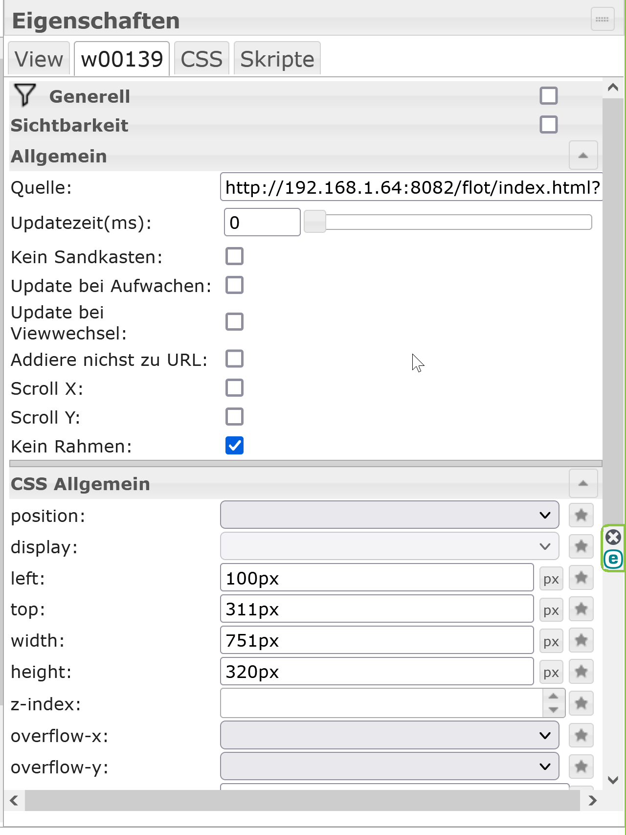

            @mcu Meinst du das
            oder den kompletten Export

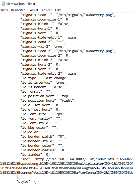

            [{"tpl":"tplIFrame","data":{"g_fixed":false,"g_visibility":false,"g_css_font_text":false,"g_css_background":false,"g_css_shadow_padding":false,"g_css_border":false,"g_gestures":false,"g_signals":false,"g_last_change":false,"visibility-cond":"==","visibility-val":1,"visibility-groups-action":"hide","refreshInterval":"0","seamless":"true","signals-cond-0":"==","signals-val-0":true,"signals-icon-0":"/vis/signals/lowbattery.png","signals-icon-size-0":0,"signals-blink-0":false,"signals-horz-0":0,"signals-vert-0":0,"signals-hide-edit-0":false,"signals-cond-1":"==","signals-val-1":true,"signals-icon-1":"/vis/signals/lowbattery.png","signals-icon-size-1":0,"signals-blink-1":false,"signals-horz-1":0,"signals-vert-1":0,"signals-hide-edit-1":false,"signals-cond-2":"==","signals-val-2":true,"signals-icon-2":"/vis/signals/lowbattery.png","signals-icon-size-2":0,"signals-blink-2":false,"signals-horz-2":0,"signals-vert-2":0,"signals-hide-edit-2":false,"lc-type":"last-change","lc-is-interval":true,"lc-is-moment":false,"lc-format":"","lc-position-vert":"top","lc-position-horz":"right","lc-offset-vert":0,"lc-offset-horz":0,"lc-font-size":"12px","lc-font-family":"","lc-font-style":"","lc-bkg-color":"","lc-color":"","lc-border-width":"0","lc-border-style":"","lc-border-color":"","lc-border-radius":10,"lc-zindex":0,"src":"http://192.168.1.64:8082/flot/index.html?l%5B0%5D%5Bid%5D=0_userdata.0.PV.rPV_Power_MPPT1&l%5B0%5D%5Binstance%5D=sql.0&l%5B0%5D%5Boffset%5D=0&l%5B0%5D%5Baggregate%5D=minmax&l%5B0%5D%5Bcolor%5D=%23ffd300&l%5B0%5D%5Bthickness%5D=1&l%5B0%5D%5Bshadowsize%5D=0&l%5B0%5D%5Bunit%5D=W&l%5B0%5D%5Bname%5D=PV+Power+Ost&l%5B0%5D%5Bxmove%5D=0&l%5B0%5D%5BcommonYAxis%5D=1&l%5B0%5D%5BignoreNull%5D=false&l%5B0%5D%5BafterComma%5D=2&l%5B0%5D%5Bdashes%5D=false&l%5B0%5D%5BdashLength%5D=10&l%5B0%5D%5BspaceLength%5D=10&l%5B0%5D%5Bmultiplicator%5D=1&l%5B0%5D%5Byaxe%5D=left&l%5B0%5D%5Bsmoothing%5D=1&l%5B1%5D%5Bid%5D=0_userdata.0.PV.rPV_Power_MPPT2&l%5B1%5D%5Binstance%5D=sql.0&l%5B1%5D%5Boffset%5D=0&l%5B1%5D%5Baggregate%5D=minmax&l%5B1%5D%5Bcolor%5D=%23ffca00&l%5B1%5D%5Bthickness%5D=1&l%5B1%5D%5Bshadowsize%5D=0&l%5B1%5D%5Bunit%5D=W&l%5B1%5D%5Bname%5D=PV+Power+West&l%5B1%5D%5Bxmove%5D=0&l%5B1%5D%5Byaxe%5D=off&l%5B1%5D%5BcommonYAxis%5D=1&l%5B1%5D%5BafterComma%5D=2&l%5B1%5D%5Bdashes%5D=false&l%5B1%5D%5BdashLength%5D=10&l%5B1%5D%5BspaceLength%5D=10&l%5B1%5D%5Bmultiplicator%5D=1&l%5B1%5D%5Bxaxe%5D=off&l%5B1%5D%5Bsmoothing%5D=1&l%5B2%5D%5Bid%5D=0_userdata.0.PV.rPV_Power_Total&l%5B2%5D%5Binstance%5D=sql.0&l%5B2%5D%5Boffset%5D=0&l%5B2%5D%5Baggregate%5D=minmax&l%5B2%5D%5Bcolor%5D=%23ff9600&l%5B2%5D%5Bthickness%5D=1&l%5B2%5D%5Bshadowsize%5D=3&l%5B2%5D%5Bunit%5D=W&l%5B2%5D%5Bname%5D=PV+Power+Total&l%5B2%5D%5Bxmove%5D=0&l%5B2%5D%5Byaxe%5D=off&l%5B2%5D%5BcommonYAxis%5D=1&l%5B2%5D%5BafterComma%5D=2&l%5B2%5D%5Bdashes%5D=false&l%5B2%5D%5BdashLength%5D=10&l%5B2%5D%5BspaceLength%5D=10&l%5B2%5D%5Bmultiplicator%5D=1&l%5B2%5D%5Bxaxe%5D=off&l%5B2%5D%5Bfill%5D=0.2&l%5B2%5D%5Bsmoothing%5D=2&l%5B3%5D%5Bid%5D=0_userdata.0.PV.rExport_Power_Signed&l%5B3%5D%5Boffset%5D=0&l%5B3%5D%5Baggregate%5D=minmax&l%5B3%5D%5Bcolor%5D=%23009cff&l%5B3%5D%5Bthickness%5D=1&l%5B3%5D%5Bshadowsize%5D=3&l%5B3%5D%5Bunit%5D=W&l%5B3%5D%5Bname%5D=Netz&l%5B3%5D%5Bxmove%5D=0&l%5B3%5D%5Byaxe%5D=off&l%5B3%5D%5Bxaxe%5D=off&l%5B3%5D%5BcommonYAxis%5D=1&l%5B3%5D%5BafterComma%5D=2&l%5B3%5D%5Bdashes%5D=false&l%5B3%5D%5BdashLength%5D=10&l%5B3%5D%5BspaceLength%5D=10&l%5B3%5D%5Bmultiplicator%5D=1&l%5B3%5D%5Bfill%5D=0.2&l%5B3%5D%5Binstance%5D=sql.0&l%5B4%5D%5Bid%5D=0_userdata.0.PV.rBattery_Power_Signed&l%5B4%5D%5Boffset%5D=0&l%5B4%5D%5Baggregate%5D=minmax&l%5B4%5D%5Bcolor%5D=%237aff00&l%5B4%5D%5Bthickness%5D=1&l%5B4%5D%5Bshadowsize%5D=3&l%5B4%5D%5Bunit%5D=W&l%5B4%5D%5Bname%5D=Batterie&l%5B4%5D%5Bxmove%5D=0&l%5B4%5D%5Byaxe%5D=off&l%5B4%5D%5Bxaxe%5D=off&l%5B4%5D%5BcommonYAxis%5D=1&l%5B4%5D%5BafterComma%5D=2&l%5B4%5D%5Bdashes%5D=false&l%5B4%5D%5BdashLength%5D=10&l%5B4%5D%5BspaceLength%5D=10&l%5B4%5D%5Bmultiplicator%5D=1&l%5B4%5D%5Bfill%5D=0.2&l%5B4%5D%5Binstance%5D=sql.0&l%5B5%5D%5Bid%5D=0_userdata.0.PV.rLoad_Power&l%5B5%5D%5Binstance%5D=sql.0&l%5B5%5D%5Boffset%5D=0&l%5B5%5D%5Baggregate%5D=minmax&l%5B5%5D%5Bcolor%5D=%23da041b&l%5B5%5D%5Bthickness%5D=1&l%5B5%5D%5Bshadowsize%5D=2&l%5B5%5D%5Bunit%5D=W&l%5B5%5D%5Bname%5D=Verbrauch&l%5B5%5D%5Bxmove%5D=0&l%5B5%5D%5Byaxe%5D=off&l%5B5%5D%5Bxaxe%5D=off&l%5B5%5D%5BcommonYAxis%5D=1&l%5B5%5D%5BafterComma%5D=2&l%5B5%5D%5Bdashes%5D=false&l%5B5%5D%5BdashLength%5D=10&l%5B5%5D%5BspaceLength%5D=10&l%5B5%5D%5Bmultiplicator%5D=1&l%5B5%5D%5Bsmoothing%5D=0&l%5B5%5D%5Bfill%5D=0.2&l%5B5%5D%5Bpoints%5D=false&l%5B6%5D%5Bid%5D=0_userdata.0.PV.rBattery_Level&l%5B6%5D%5Binstance%5D=sql.0&l%5B6%5D%5Boffset%5D=0&l%5B6%5D%5Baggregate%5D=minmax&l%5B6%5D%5Bcolor%5D=%23800000&l%5B6%5D%5Bthickness%5D=2&l%5B6%5D%5Bshadowsize%5D=3&l%5B6%5D%5Bunit%5D=%25&l%5B6%5D%5Bname%5D=Ladezustand&l%5B6%5D%5Bxmove%5D=0&l%5B6%5D%5Byaxe%5D=right&l%5B6%5D%5BignoreNull%5D=&l%5B6%5D%5BafterComma%5D=2&l%5B6%5D%5Bdashes%5D=false&l%5B6%5D%5BdashLength%5D=10&l%5B6%5D%5BspaceLength%5D=10&l%5B6%5D%5Bmultiplicator%5D=1&l%5B6%5D%5Bxaxe%5D=off&timeType=static&relativeEnd=now&range=180&aggregateType=count&aggregateSpan=3000&hoverDetail=true&useComma=false&zoom=true&noedit=false&animation=0&live=5&legend=ne&start=2023-08-27&start_time=00%3A00&end=2023-08-28&end_time=00%3A00&window_bg=%23ffffff&bg=0"},"style":{"left":"100px","top":"311px","width":"751px","height":"320px"},"widgetSet":"basic"}]

              MCU
              @norwegen60
              Also man kann die Daten (Parameter) von VIS nur auf Dateiebene ändern.
              • man muss also erst jedesmal vor einer Änderung die Datei lesen
              • die src in der Datei suchen
              • die src anpassen und die Datei speichern
              Dann weiß ich aber noch nicht, ob dann das Frontend (VIS) dadurch direkt upgedatet wird.
              Also mir erscheint die andere Möglichkeit mit eCharts wesentlich einfacher, da man dort die Änderungen auf Objektebene vollzieht.
              Du kannst ja mal testen, ob eine Änderung auf Dateiebene, also in Deinem VIS-Projekt, dann das Frontend geändert wird?
