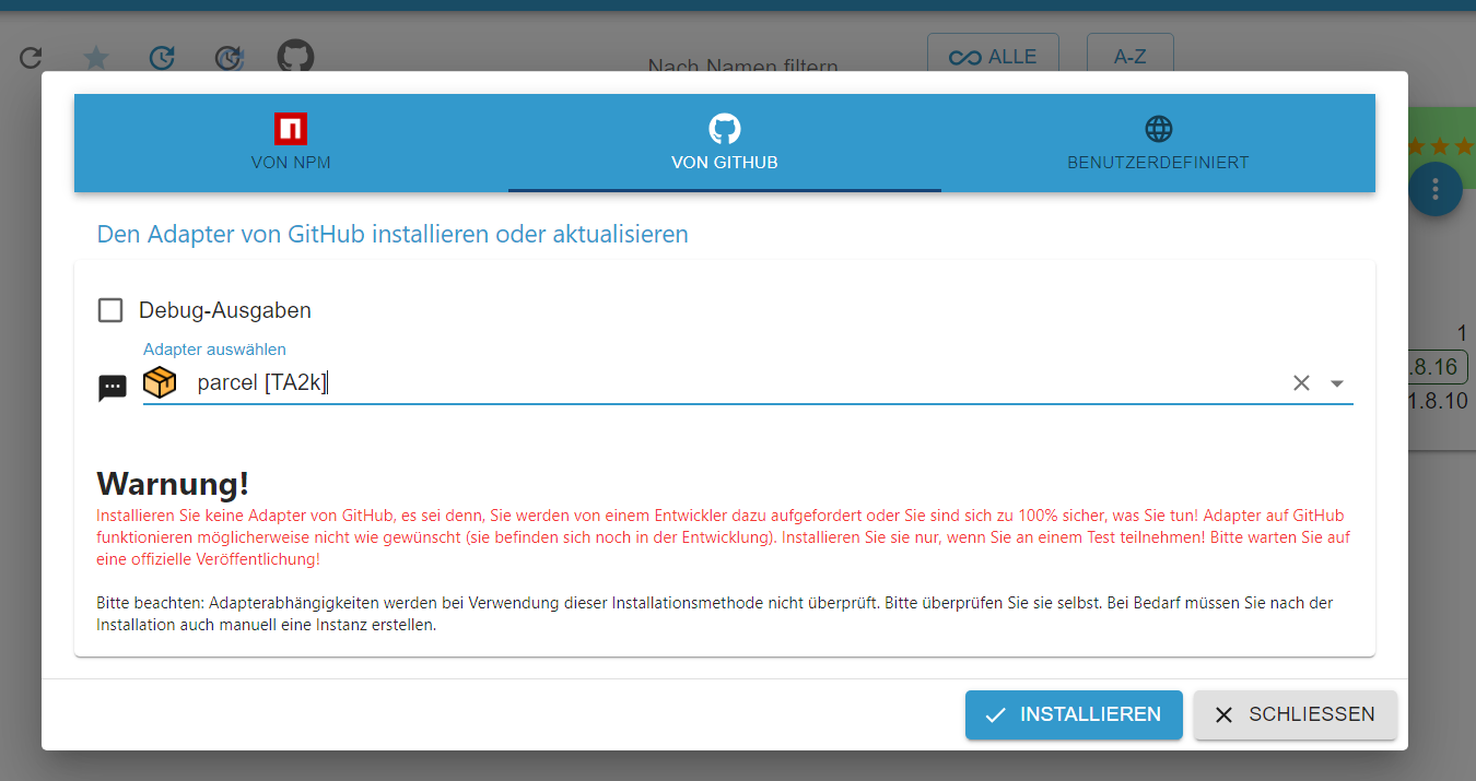

          @walter-white
          Adapter >> Katze
