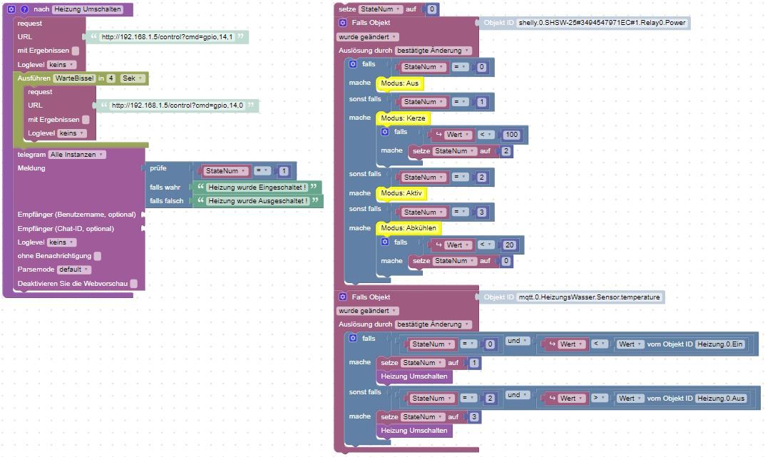

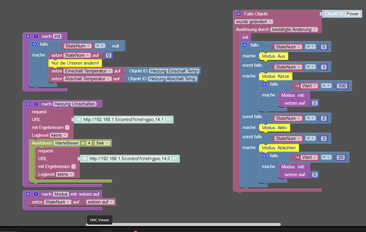

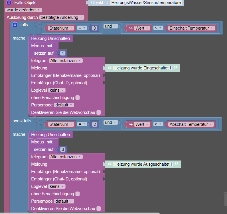

    @bernd-1337 sagte: kannst du den code posten
     <variables>
       <variable id="Nngn$qGMi,a]t/|lc#?{">StateNum</variable>
       <variable type="timeout" id="WarteBissel">WarteBissel</variable>
     </variables>
     <block type="procedures_defnoreturn" id=".F]sXJcTp=@W3(Y(=EeK" x="163" y="112">
       <field name="NAME">Heizung Umschalten</field>
       <statement name="STACK">
         <block type="request" id=";cmmm{:YO0yNze=#lDOT">
           <mutation xmlns="http://www.w3.org/1999/xhtml" with_statement="false"></mutation>
           <field name="WITH_STATEMENT">FALSE</field>
           <field name="LOG"></field>
           <value name="URL">
             <shadow type="text" id="E@lHsR]E-y+Rc@,Vincw">
               <field name="TEXT">http://192.168.1.5/control?cmd=gpio,14,1</field>
             </shadow>
           </value>
           <next>
             <block type="timeouts_settimeout" id="0+Nf.N=vWpAxzI;KPUfH">
               <field name="NAME">WarteBissel</field>
               <field name="DELAY">4</field>
               <statement name="STATEMENT">
                 <block type="request" id="%aA0/#=TLCMJ(5fu/)`P">
                   <value name="URL">
                     <shadow type="text" id="bb9#YKR)@Rx9jjdXvBp%">
                       <field name="TEXT">http://192.168.1.5/control?cmd=gpio,14,0</field>
                     </shadow>
                   </value>
                 </block>
               </statement>
               <next>
                 <block type="telegram" id="3LY~@xt2e.([#Bj/078u">
                   <field name="DISABLE_WEB_PAGE_PREVIEW">FALSE</field>
                   <value name="MESSAGE">
                     <shadow type="text" id="}1#aA@4Kf(;cC!,6h!4z">
                       <field name="TEXT">Heizung wurde Ausgeschaltet !</field>
                     </shadow>
                     <block type="logic_ternary" id="f}9^C%JV786Jh}ZmKErJ">
                       <value name="IF">
                         <block type="logic_compare" id="KHYb(LnPd=HL|U!{1zoO">
                           <field name="OP">EQ</field>
                           <value name="A">
                             <block type="variables_get" id="cwD(ukIy)S1Dv{tI_V18">
                               <field name="VAR" id="Nngn$qGMi,a]t/|lc#?{">StateNum</field>
                             </block>
                           </value>
                           <value name="B">
                             <block type="math_number" id="xcofx23G.^hn$mt+^:`d">
                               <field name="NUM">1</field>
                             </block>
                           </value>
                         </block>
                       </value>
                       <value name="THEN">
                         <block type="text" id="`NF)FWl95`{6h8Yq;G3v">
                           <field name="TEXT">Heizung wurde Eingeschaltet !</field>
                         </block>
                       </value>
                       <value name="ELSE">
                         <block type="text" id="i#mQW*k:Jk%qt`Eu)Vvj">
                         </block>
                       </value>
                     </block>
                   </value>
                 </block>
               </next>
             </block>
           </next>
         </block>
       </statement>
     </block>
     <block type="variables_set" id="Lf+.@w0i]IS/gNw{qa6L" x="838" y="112">
       <value name="VALUE">
         <block type="math_number" id="KhrGvql?l=E@bi|rli_W">
           <field name="NUM">0</field>
         </block>
       </value>
       <next>
         <block type="on_ext" id="K2#.V[BShz?wc5YaB:Xa">
           <field name="ACK_CONDITION">true</field>
           <value name="OID0">
             <shadow type="field_oid" id="EA2571m53SBZ4{-;6dlz">
               <field name="oid">shelly.0.SHSW-25#3494547971EC#1.Relay0.Power</field>
             </shadow>
           </value>
             <block type="controls_if" id="6t9~,p6FidwN}]u?M4">
               <mutation elseif="3"></mutation>
               <value name="IF0">
                 <block type="logic_compare" id="JCl5xO7ojDQn^44RiSp,">
                   <value name="A">
                     <block type="variables_get" id="4$$P9HQ)MNUl{s1VE~F">
                     </block>
                   </value>
                   <value name="B">
                     <block type="math_number" id="lf,FcwXo:E?[h.(=yGt6">
                     </block>
                   </value>
                 </block>
               </value>
               <statement name="DO0">
                 <block type="comment" id="ICp_/aW:$%cn-o0HvrQa">
                   <field name="COMMENT">Modus: Aus</field>
                 </block>
               </statement>
               <value name="IF1">
                 <block type="logic_compare" id="3%|GqQPly)yBIN7#y,">
                   <value name="A">
                     <block type="variables_get" id=".8{U{s3*3e1!sJOo/9D6">
                     </block>
                   </value>
                   <value name="B">
                     <block type="math_number" id="hUec!BZSA.:|G(3=(+Lt">
                     </block>
                   </value>
                 </block>
               </value>
               <statement name="DO1">
                 <block type="comment" id="nL6yYs(6sGU5H3e2Taxz">
                   <field name="COMMENT">Modus: Kerze</field>
                   <next>
                     <block type="controls_if" id="hc2nU}%;|[~nj~seBYjg">
                       <value name="IF0">
                         <block type="logic_compare" id="A1fx8o=lFa]#g%7~,~E4">
                           <field name="OP">LT</field>
                           <value name="A">
                             <block type="on_source" id="Ny*R^VVpN|F0/%U*AE};">
                             </block>
                           </value>
                           <value name="B">
                             <block type="math_number" id="]G,eb/;~2DcnH{V*Rbma">
                               <field name="NUM">100</field>
                             </block>
                           </value>
                         </block>
                       </value>
                         <block type="variables_set" id="}Zh9j34tYu[ebF)N,40,">
                             <block type="math_number" id="R+m@ZqFHMr@%_^w+^qOO">
                               <field name="NUM">2</field>
                             </block>
                           </value>
                         </block>
                       </statement>
                     </block>
                   </next>
                 </block>
               </statement>
               <value name="IF2">
                 <block type="logic_compare" id=";hAF2.irdRUutWpZo;:d">
                   <value name="A">
                     <block type="variables_get" id="FGT{I74}dY~WfC/PnVD/">
                     </block>
                   </value>
                   <value name="B">
                     <block type="math_number" id="w7)Z{X|{3^6~AC1y+3{N">
                     </block>
                   </value>
                 </block>
               </value>
               <statement name="DO2">
                 <block type="comment" id="d;NS!%[1{?/P=8pO+WY0">
                   <field name="COMMENT">Modus: Aktiv</field>
                 </block>
               </statement>
               <value name="IF3">
                 <block type="logic_compare" id="%Yw%3*w]I{fN|^S.ZS]=">
                   <value name="A">
                     <block type="variables_get" id="-4j4^KiH7d:mHrXl#mT?">
                     </block>
                   </value>
                   <value name="B">
                     <block type="math_number" id="$bd2xwJ/X1l.Kr.6[ut">
                       <field name="NUM">3</field>
                     </block>
                   </value>
                 </block>
               </value>
               <statement name="DO3">
                 <block type="comment" id="gQznu+9U)WyeA|SO.(">
                   <field name="COMMENT">Modus: Abkühlen</field>
                   <next>
                     <block type="controls_if" id="@bq3#zrqBgf#5h#5Z#hS">
                       <value name="IF0">
                         <block type="logic_compare" id=".6qUKEJ|K/,*0Tqh7X+">
                           <value name="A">
                             <block type="on_source" id="mL5[!HcyBnf9f?r^0">
                             </block>
                           </value>
                           <value name="B">
                             <block type="math_number" id="0T2Sp8CcWbAThN_U-1mX">
                               <field name="NUM">20</field>
                             </block>
                           </value>
                         </block>
                       </value>
                         <block type="variables_set" id="^Lqch?=mdtATs]!,HV.N">
                             <block type="math_number" id="sGO17n(^Qa?N)XGA@voq">
                             </block>
                           </value>
                         </block>
                       </statement>
                     </block>
                   </next>
                 </block>
               </statement>
             </block>
           </statement>
           <next>
             <block type="on_ext" id="OtwKLd|WDL35?6l#wMO^">
               <value name="OID0">
                 <shadow type="field_oid" id="GQOm_-9Y(R8AMX;(QMD?">
                   <field name="oid">mqtt.0.HeizungsWasser.Sensor.temperature</field>
                 </shadow>
               </value>
                 <block type="controls_if" id="f|L;-tv#*;ER)[p#V,nP">
                   <value name="IF0">
                     <block type="logic_operation" id="*:ES_JmGY(:w{)//L(">
                       <field name="OP">AND</field>
                       <value name="A">
                         <block type="logic_compare" id=":eot3H)-S7/~J4}[62x{">
                           <value name="A">
                             <block type="variables_get" id="z%+gjj@TqUv8b9r%Ign,">
                             </block>
                           </value>
                           <value name="B">
                             <block type="math_number" id="7iVpE*zF@kH.cZFsa{~)">
                             </block>
                           </value>
                         </block>
                       </value>
                       <value name="B">
                         <block type="logic_compare" id=":{L1=rg,|!e^]3zvz}s]">
                           <value name="A">
                             <block type="on_source" id="+o:kLG3|[G/zOQA{@*V">
                             </block>
                           </value>
                           <value name="B">
                             <block type="get_value" id="DqXK^aSt(YszonMp(9Q#">
                               <field name="OID">Heizung.0.Ein</field>
                             </block>
                           </value>
                         </block>
                       </value>
                     </block>
                   </value>
                     <block type="variables_set" id="@1(if5NGK9EG:Dil(4Cd">
                         <block type="math_number" id="G?{p(eR}BhC7|!lN4l[H">
                         </block>
                       </value>
                       <next>
                         <block type="procedures_callnoreturn" id="%|#*~aAq96]Uv-JS7TqJ">
                           <mutation name="Heizung Umschalten"></mutation>
                         </block>
                       </next>
                     </block>
                   </statement>
                   <value name="IF1">
                     <block type="logic_operation" id="Vr@lX;*Pc4]J2@-gu:W">
                       <value name="A">
                         <block type="logic_compare" id="j{)~Jj9Y^oxHCV{kv=uy">
                           <value name="A">
                             <block type="variables_get" id="A)mtm?a!vB7%tbufxyg">
                             </block>
                           </value>
                           <value name="B">
                             <block type="math_number" id="]PxP{~|II!{NVfe%Cd">
                             </block>
                           </value>
                         </block>
                       </value>
                       <value name="B">
                         <block type="logic_compare" id="(r{RhyGx7bV(jg2G(sE+">
                           <field name="OP">GT</field>
                           <value name="A">
                             <block type="on_source" id="n](6.WEo[c:[4t!oc}~@">
                             </block>
                           </value>
                           <value name="B">
                             <block type="get_value" id="}+,ko4-p~+jF;Ly|Z8">
                               <field name="OID">Heizung.0.Aus</field>
                             </block>
                           </value>
                         </block>
                       </value>
                     </block>
                   </value>
                     <block type="variables_set" id="4^w`_tzL*$RzyAS%[U})">
                         <block type="math_number" id="+qT3-uNK}y=QED[]AT~H">
                         </block>
                       </value>
                       <next>
                         <block type="procedures_callnoreturn" id="N3@(j3a2?cU5b]N!vK%v">
                         </block>
                       </next>
                     </block>
                   </statement>
                 </block>
               </statement>
             </block>
           </next>
         </block>
       </next>
     </block>
    </xml>

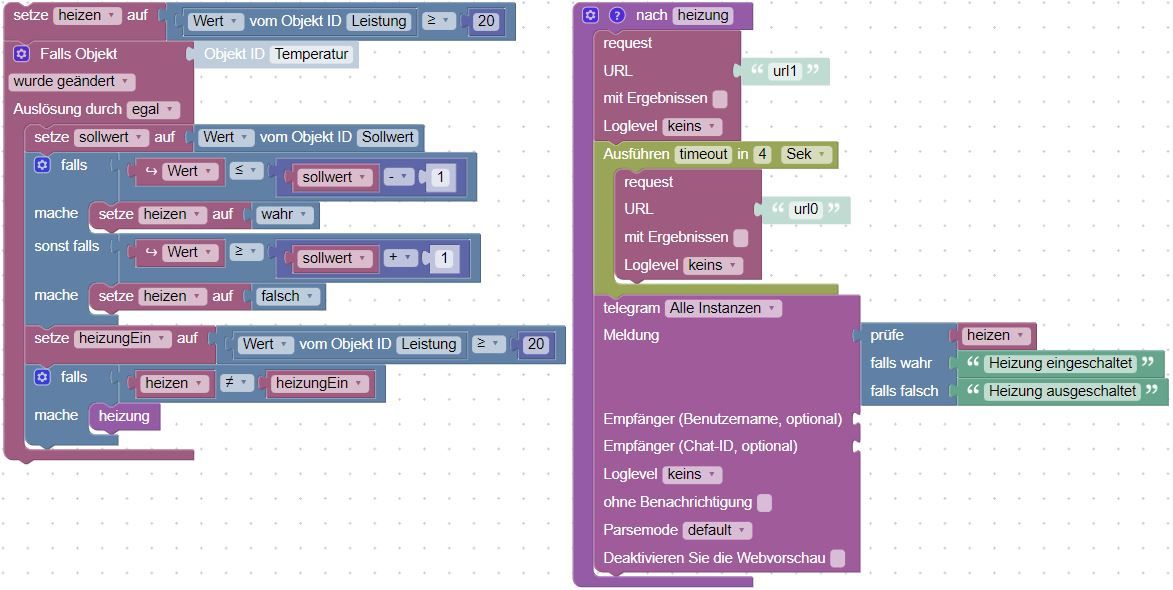

    @paul53 okay bist jetzt funzt es also gestartet hat sie ich melde mich zurück ob es komplett funzt
    1 Reply Last reply
       <variables>
       </variables>
             <value name="URL">
               </shadow>
             </value>
             <next>
                     <value name="URL">
                       </shadow>
                     </value>
                   </block>
                 </statement>
                 <next>
                       </shadow>
                         <value name="IF">
                             <value name="A">
                               </block>
                             </value>
                             <value name="B">
                               </block>
                             </value>
                           </block>
                         </value>
                         <value name="THEN">
                           </block>
                         </value>
                         <value name="ELSE">
                           </block>
                         </value>
                       </block>
                     </value>
                   </block>
                 </next>
               </block>
             </next>
           </block>
         </statement>
       </block>
           </block>
         </value>
         <next>
             <value name="OID0">
               </shadow>
             </value>
                 <value name="IF0">
                     <value name="A">
                       </block>
                     </value>
                     <value name="B">
                       </block>
                     </value>
                   </block>
                 </value>
                   </block>
                 </statement>
                 <value name="IF1">
                     <value name="A">
                       </block>
                     </value>
                     <value name="B">
                       </block>
                     </value>
                   </block>
                 </value>
                     <next>
                         <value name="IF0">
                             <value name="A">
                               </block>
                             </value>
                             <value name="B">
                               </block>
                             </value>
                           </block>
                         </value>
                               </block>
                             </value>
                           </block>
                         </statement>
                       </block>
                     </next>
                   </block>
                 </statement>
                 <value name="IF2">
                     <value name="A">
                       </block>
                     </value>
                     <value name="B">
                       </block>
                     </value>
                   </block>
                 </value>
                   </block>
                 </statement>
                 <value name="IF3">
                     <value name="A">
                       </block>
                     </value>
                     <value name="B">
                       </block>
                     </value>
                   </block>
                 </value>
                     <next>
                         <value name="IF0">
                             <value name="A">
                               </block>
                             </value>
                             <value name="B">
                               </block>
                             </value>
                           </block>
                         </value>
                               </block>
                             </value>
                           </block>
                         </statement>
                       </block>
                     </next>
                   </block>
                 </statement>
               </block>
             </statement>
             <next>
                 <value name="OID0">
                   </shadow>
                 </value>
                     <value name="IF0">
                         <value name="A">
                             <value name="A">
                               </block>
                             </value>
                             <value name="B">
                               </block>
                             </value>
                           </block>
                         </value>
                         <value name="B">
                             <value name="A">
                               </block>
                             </value>
                             <value name="B">
                               </block>
                             </value>
                           </block>
                         </value>
                       </block>
                     </value>
                           </block>
                         </value>
                         <next>
                           </block>
                         </next>
                       </block>
                     </statement>
                     <value name="IF1">
                         <value name="A">
                             <value name="A">
                               </block>
                             </value>
                             <value name="B">
                               </block>
                             </value>
                           </block>
                         </value>
                         <value name="B">
                             <value name="A">
                               </block>
                             </value>
                             <value name="B">
                               </block>
                             </value>
                           </block>
                         </value>
                       </block>
                     </value>
                           </block>
                         </value>
                         <next>
                           </block>
                         </next>
                       </block>
                     </statement>
                   </block>
                 </statement>
               </block>
             </next>
           </block>
         </next>
       </block>
      </xml>

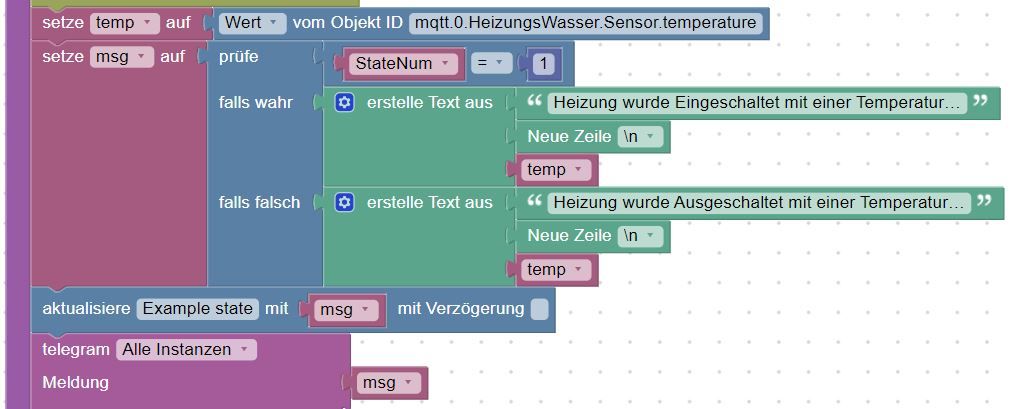

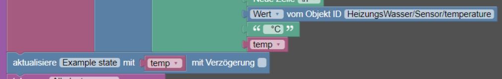

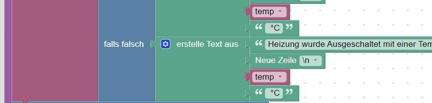

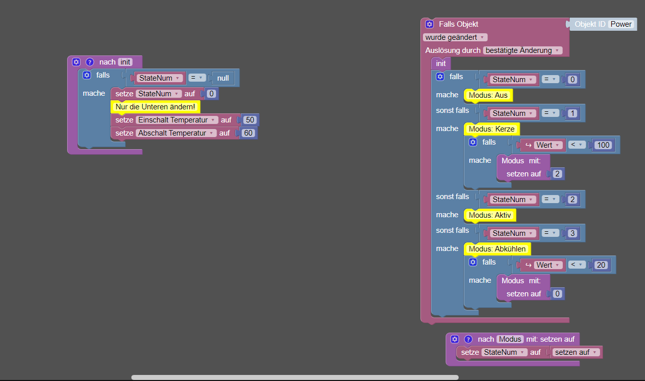

                  @paul53 Hey Paul schau mal ich habe in dem Heizungs script was du mir damals Gebastelt hast etwas eingefügt ist das richtig weil jetzt Reagiert es nicht mehr Screenshot_2.png
                                    </block>
                                  </value>
                                  <value name="B">
                                    </block>
                                  </value>
                                </block>
                              </value>
                                </block>
                              </statement>
                              <value name="IF1">
                                  <value name="A">
                                    </block>
                                  </value>
                                  <value name="B">
                                    </block>
                                  </value>
                                </block>
                              </value>
                                  <next>
                                      <value name="IF0">
                                          <value name="A">
                                            </block>
                                          </value>
                                          <value name="B">
                                            </block>
                                          </value>
                                        </block>
                                      </value>
                                            </block>
                                          </value>
                                        </block>
                                      </statement>
                                    </block>
                                  </next>
                                </block>
                              </statement>
                              <value name="IF2">
                                  <value name="A">
                                    </block>
                                  </value>
                                  <value name="B">
                                    </block>
                                  </value>
                                </block>
                              </value>
                                </block>
                              </statement>
                              <value name="IF3">
                                  <value name="A">
                                    </block>
                                  </value>
                                  <value name="B">
                                    </block>
                                  </value>
                                </block>
                              </value>
                                  <next>
                                      <value name="IF0">
                                          <value name="A">
                                            </block>
                                          </value>
                                          <value name="B">
                                            </block>
                                          </value>
                                        </block>
                                      </value>
                                            </block>
                                          </value>
                                        </block>
                                      </statement>
                                    </block>
                                  </next>
                                </block>
                              </statement>
                            </block>
                          </statement>
                          <next>
                              <value name="OID0">
                                </shadow>
                              </value>
                                  <value name="IF0">
                                      <value name="A">
                                          <value name="A">
                                            </block>
                                          </value>
                                          <value name="B">
                                            </block>
                                          </value>
                                        </block>
                                      </value>
                                      <value name="B">
                                          <value name="A">
                                            </block>
                                          </value>
                                          <value name="B">
                                            </block>
                                          </value>
                                        </block>
                                      </value>
                                    </block>
                                  </value>
                                        </block>
                                      </value>
                                      <next>
                                        </block>
                                      </next>
                                    </block>
                                  </statement>
                                  <value name="IF1">
                                      <value name="A">
                                          <value name="A">
                                            </block>
                                          </value>
                                          <value name="B">
                                            </block>
                                          </value>
                                        </block>
                                      </value>
                                      <value name="B">
                                          <value name="A">
                                            </block>
                                          </value>
                                          <value name="B">
                                            </block>
                                          </value>
                                        </block>
                                      </value>
                                    </block>
                                  </value>
                                        </block>
                                      </value>
                                      <next>
                                        </block>
                                      </next>
                                    </block>
                                  </statement>
                                </block>
                              </statement>
                            </block>
                          </next>
                        </block>
                      </next>
                    </block>
                    <block type="procedures_defnoreturn" id=".F]sXJcTp=@W3(Y(=EeK" x="-312" y="213">
                          <value name="URL">
                            </shadow>
                          </value>
                          <next>
                              <field name="DELAY">6</field>
                                  <value name="URL">
                                    </shadow>
                                  </value>
                                </block>
                              </statement>
                              <next>
                                <block type="update" id="9*ti~%Pz1Q`s)`v|1x|p">
                                  <field name="OID">0_userdata.0.example_state</field>
                                    <block type="logic_ternary" id="a-jd(c]$i3K13wXlD^`U">
                                      <value name="IF">
                                        <block type="logic_compare" id="!H8SUz*o7a:qQecXgD!B">
                                          <value name="A">
                                            <block type="variables_get" id="j+(+6p%535lyAO?F$kd3">
                                            </block>
                                          </value>
                                          <value name="B">
                                            <block type="math_number" id="=guGNGu(8VqX=3u`ah.*">
                                            </block>
                                          </value>
                                        </block>
                                      </value>
                                      <value name="THEN">
                                        <block type="text_join" id="ACy5F:oct#wjMXVSWl@]">
                                          <value name="ADD0">
                                            <block type="text" id="{.z?{^yL)FfDp^vqK1Mg">
                                              <field name="TEXT">Heizung wurde Eingeschaltet mit einer Temperatur von ! </field>
                                            </block>
                                          </value>
                                          <value name="ADD1">
                                            <block type="text_newline" id="uGY3`U`aNIL~a;dJrQ)I">
                                              <field name="Type">\n</field>
                                            </block>
                                          </value>
                                          <value name="ADD2">
                                            <block type="get_value" id="WhPX7;1G!8KAbEd_wSG]">
                                              <field name="OID">mqtt.0.HeizungsWasser.Sensor.temperature</field>
                                            </block>
                                          </value>
                                        </block>
                                      </value>
                                      <value name="ELSE">
                                        <block type="text_join" id="d27Xy~Lq.mNRAO6B1hMZ">
                                          <value name="ADD0">
                                            <block type="text" id="z%aG}*M}|`B;mrV6Z$e~">
                                              <field name="TEXT">Heizung wurde Ausgeschaltet mit einer Temperatur von ! </field>
                                            </block>
                                          </value>
                                          <value name="ADD1">
                                            <block type="text_newline" id="LC!_{d7]dSwjm)H6xm5r">
                                            </block>
                                          </value>
                                          <value name="ADD2">
                                            <block type="get_value" id="3Dv[J8ok3T`=zv.ZSdFG">
                                            </block>
                                          </value>
                                        </block>
                                      </value>
                                    </block>
                                  </value>
                                  <next>
                                      <field name="ESCAPING">FALSE</field>
                                        </shadow>
                                          <value name="IF">
                                              <value name="A">
                                                </block>
                                              </value>
                                              <value name="B">
                                                </block>
                                              </value>
                                            </block>
                                          </value>
                                          <value name="THEN">
                                            <block type="text_join" id="QbL0O8/z;~l!n2st|G}5">
                                              <value name="ADD0">
                                                </block>
                                              </value>
                                              <value name="ADD1">
                                                <block type="text_newline" id="A-QG:Ig4YObizhB~]da(">
                                                </block>
                                              </value>
                                              <value name="ADD2">
                                                <block type="get_value" id="seYhIcXy9|4kQxrn{1{)">
                                                </block>
                                              </value>
                                            </block>
                                          </value>
                                          <value name="ELSE">
                                            <block type="text_join" id="vxzalkvdQv(0g:RZzH,4">
                                              <value name="ADD0">
                                                </block>
                                              </value>
                                              <value name="ADD1">
                                                <block type="text_newline" id="A]K{Qi$do2-4F,kmkLEZ">
                                                </block>
                                              </value>
                                              <value name="ADD2">
                                                <block type="get_value" id="Y8;|lZ0`~Pq33,[rY(V:">
                                                </block>
                                              </value>
                                            </block>
                                          </value>
                                        </block>
                                      </value>
                                    </block>
                                  </next>
                                </block>
                              </next>
                            </block>
                          </next>
                        </block>
                      </statement>
                    </block>
                  </xml>
                      <variables>
                      </variables>
                          </block>
                        </value>
                        <next>
                            <value name="OID0">
                              </shadow>
                            </value>
                                <value name="IF0">
                                    <value name="A">
                                      </block>

                    #42
                    @bernd-1337 sagte: jetzt Reagiert es nicht mehr
                    Ich kann keinen funktionellen Unterschied erkennen.
                    Anstatt gleiche Texte zweimal zu erstellen, verwendet man besser eine Variable:
                    B 1 Reply Last reply
                    • B Bernd 1337

                                  <value name="IF0">
                                      <value name="A">
                                        </block>
                                      </value>
                                      <value name="B">
                                        </block>
                                      </value>
                                    </block>
                                  </value>
                                    </block>
                                  </statement>
                                  <value name="IF1">
                                      <value name="A">
                                        </block>
                                      </value>
                                      <value name="B">
                                        </block>
                                      </value>
                                    </block>
                                  </value>
                                      <next>
                                          <value name="IF0">
                                              <value name="A">
                                                </block>
                                              </value>
                                              <value name="B">
                                                </block>
                                              </value>
                                            </block>
                                          </value>
                                                </block>
                                              </value>
                                            </block>
                                          </statement>
                                        </block>
                                      </next>
                                    </block>
                                  </statement>
                                  <value name="IF2">
                                      <value name="A">
                                        </block>
                                      </value>
                                      <value name="B">
                                        </block>
                                      </value>
                                    </block>
                                  </value>
                                    </block>
                                  </statement>
                                  <value name="IF3">
                                      <value name="A">
                                        </block>
                                      </value>
                                      <value name="B">
                                        </block>
                                      </value>
                                    </block>
                                  </value>
                                      <next>
                                          <value name="IF0">
                                              <value name="A">
                                                </block>
                                              </value>
                                              <value name="B">
                                                </block>
                                              </value>
                                            </block>
                                          </value>
                                                </block>
                                              </value>
                                            </block>
                                          </statement>
                                        </block>
                                      </next>
                                    </block>
                                  </statement>
                                </block>
                              </statement>
                              <next>
                                  <value name="OID0">
                                    </shadow>
                                  </value>
                                      <value name="IF0">
                                          <value name="A">
                                              <value name="A">
                                                </block>
                                              </value>
                                              <value name="B">
                                                </block>
                                              </value>
                                            </block>
                                          </value>
                                          <value name="B">
                                              <value name="A">
                                                </block>
                                              </value>
                                              <value name="B">
                                                </block>
                                              </value>
                                            </block>
                                          </value>
                                        </block>
                                      </value>
                                            </block>
                                          </value>
                                          <next>
                                            </block>
                                          </next>
                                        </block>
                                      </statement>
                                      <value name="IF1">
                                          <value name="A">
                                              <value name="A">
                                                </block>
                                              </value>
                                              <value name="B">
                                                </block>
                                              </value>
                                            </block>
                                          </value>
                                          <value name="B">
                                              <value name="A">
                                                </block>
                                              </value>
                                              <value name="B">
                                                </block>
                                              </value>
                                            </block>
                                          </value>
                                        </block>
                                      </value>
                                            </block>
                                          </value>
                                          <next>
                                            </block>
                                          </next>
                                        </block>
                                      </statement>
                                    </block>
                                  </statement>
                                </block>
                              </next>
                            </block>
                          </next>
                        </block>

                      DJMarc75D Offline
                      DJMarc75D Offline
                      DJMarc75
                      wrote on last edited by
                      #43
                      @bernd-1337 ob Du den XML Code auch bitte in Codetags packen würdest ?
                      Lehrling seit 1975 !!!
                      • DJMarc75D DJMarc75
                        B Offline
                        B Offline
                        Bernd 1337
                        #44
                        @djmarc75 habe ich zeigt er es nicht so an
                        1 Reply Last reply
                          B Offline
                          B Offline
                          Bernd 1337
                          #45
                          paul53P 1 Reply Last reply
                          • B Bernd 1337

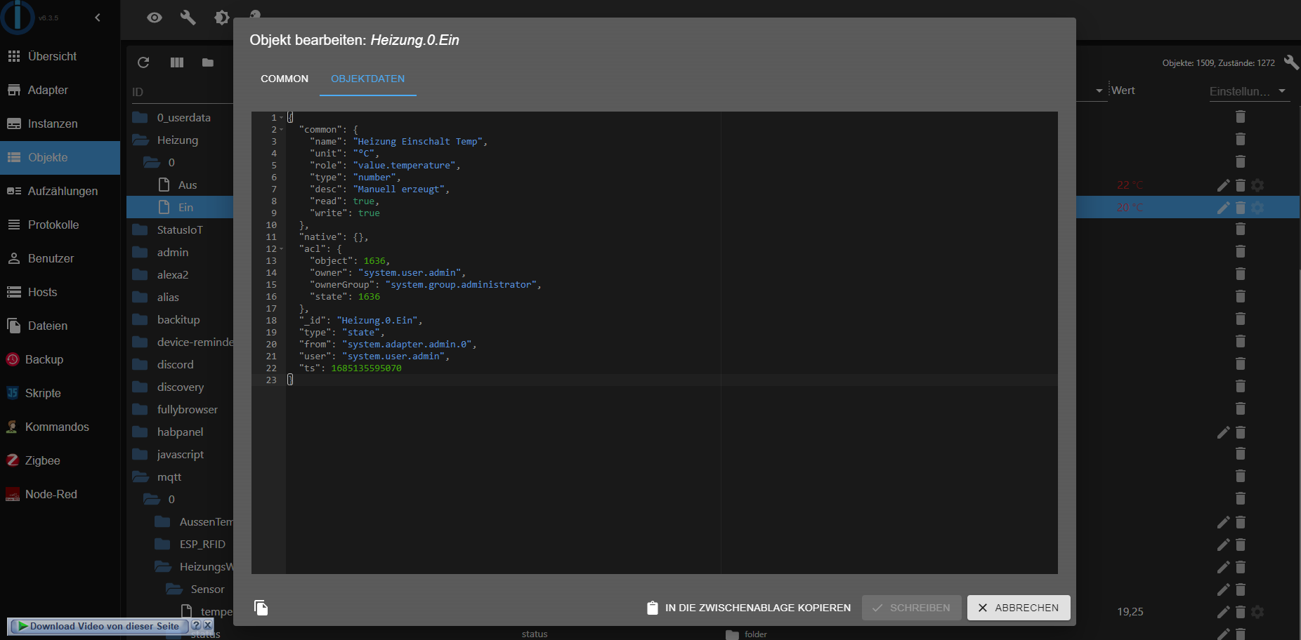

                            @bernd-1337 sagte: ist es richtig
                            Nein. Vergleiche die Bilder!
                            "°C" kannst du durchaus anhängen.

                              @paul53 ist doch genau gleich wo siehst du den fehler

                                @paul53 du meinst bei aktualisiere muss msg rein nicht war

                                  @bernd-1337 sagte: wo siehst du den fehler

                                      @bernd-1337 sagte: das hab ich gerade geändert
                                      Noch zwei Stellen:

                                        @paul53 ACH DAS WERT VON WEG MACHEN
