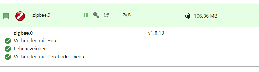

    Ich habe einen Conbee Stick und ein neu aufgesetztes System
    zigbee.0
    2023-02-27 12:11:12.678	info	Zigbee: stop joining
    zigbee.0
    2023-02-27 12:10:11.359	info	Zigbee: allowing new devices to join.
    zigbee.0
    2023-02-27 12:10:09.175	info	List of port: [{"path":"/dev/ttyACM0","manufacturer":"dresden elektronik ingenieurtechnik GmbH","serialNumber":"DE2407723","pnpId":"usb-dresden_elektronik_ingenieurtechnik_GmbH_ConBee_II_DE2407723-if00","vendorId":"1cf1","productId":"0030"},{"path":"/dev/ttyAMA0"}]
    zigbee.0
    2023-02-27 12:09:57.208	info	Zigbee started
    zigbee.0
    2023-02-27 12:09:57.206	info	Currently no devices.
    zigbee.0
    2023-02-27 12:09:57.203	info	Unable to set transmit power, unsupported function.
    zigbee.0
    2023-02-27 12:09:57.046	info	--> transmitPower : normal
    zigbee.0
    2023-02-27 12:09:57.026	info	Unable to disable LED, unsupported function.
    zigbee.0
    2023-02-27 12:09:57.003	info	Coordinator firmware version: {"type":"ConBee2/RaspBee2","meta":{"transportrev":0,"product":0,"majorrel":38,"minorrel":114,"maintrel":0,"revision":"0x26720700"}}
    zigbee.0
    2023-02-27 12:09:56.967	info	Installed Version: iobroker.zigbee@1.8.10
    zigbee.0
    2023-02-27 12:09:56.284	info	Starting Zigbee npm ...
    zigbee.0
    2023-02-27 12:09:56.282	info	delete old Backup files. keep only last 10
    zigbee.0
    2023-02-27 12:09:56.149	info	starting. Version 1.8.10 in /opt/iobroker/node_modules/iobroker.zigbee, node: v16.19.1, js-controller: 4.0.24
    zigbee.0
    2023-02-27 12:09:48.828	info	Terminated (ADAPTER_REQUESTED_TERMINATION): Without reason
    zigbee.0
    2023-02-27 12:09:48.826	info	terminating
    zigbee.0
    2023-02-27 12:09:48.327	info	Zigbee: disabling joining new devices.
    zigbee.0
    2023-02-27 12:09:48.325	info	cleaned everything up...
    zigbee.0
    2023-02-27 12:09:48.323	info	Got terminate signal TERMINATE_YOURSELF
    lag am usb port
