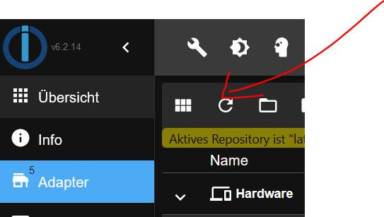

      @seyav sagte in Logs im Sekundentakt: Updating repository "stable":
      Cool! Das Logging hat gestoppt:
      Jetzt im Admin bei Adapter :
      was steht im Log

        seyav
        #32
        @glasfaser Siehe:
        admin.0
        2022-08-18 21:10:55.832	info	Use link "http://localhost:8081" to configure.
        admin.0
        2022-08-18 21:10:55.831	info	http server listening on port 8081
        admin.0
        2022-08-18 21:10:55.515	info	received all objects
        admin.0
        2022-08-18 21:10:54.646	info	requesting all objects
        admin.0
        2022-08-18 21:10:54.644	info	requesting all states
        admin.0
        2022-08-18 21:10:54.590	info	starting. Version 5.3.8 in /opt/iobroker/node_modules/iobroker.admin, node: v16.17.0, js-controller: 4.0.23
        admin.0
        2022-08-18 21:10:54.384	info	Plugin sentry Sentry Plugin disabled for this process because sending of statistic data is disabled for the system
        host.raspberrypi
        2022-08-18 21:10:52.494	info	instance system.adapter.admin.0 started with pid 2515
        host.raspberrypi
        2022-08-18 21:10:50.390	info	instance system.adapter.admin.0 terminated with code 11 (ADAPTER_REQUESTED_TERMINATION)
        admin.0
        2022-08-18 21:10:50.337	error	May not read "system.config"
        admin.0
        2022-08-18 21:10:49.467	info	Terminated (ADAPTER_REQUESTED_TERMINATION): Without reason
        admin.0
        2022-08-18 21:10:49.466	info	terminating
        admin.0
        2022-08-18 21:10:49.465	info	terminating http server on port 8081
        admin.0
        2022-08-18 21:10:49.463	info	Got terminate signal TERMINATE_YOURSELF
        host.raspberrypi
        2022-08-18 21:10:49.375	info	stopInstance system.adapter.admin.0 send kill signal
        host.raspberrypi
        2022-08-18 21:10:49.246	info	stopInstance system.adapter.admin.0 (force=false, process=true)

              @glasfaser Nein. Hatte nicht. Habe das richtige URL wieder drin. Siehe da ... keine Logs mehr !!! Ich glaube es nicht 😳

                Restart auf admin -- immer noch stabil. Keine Logs mehr. Wahnsinn! Danke Danke! Hast meine Nacht gerettet
