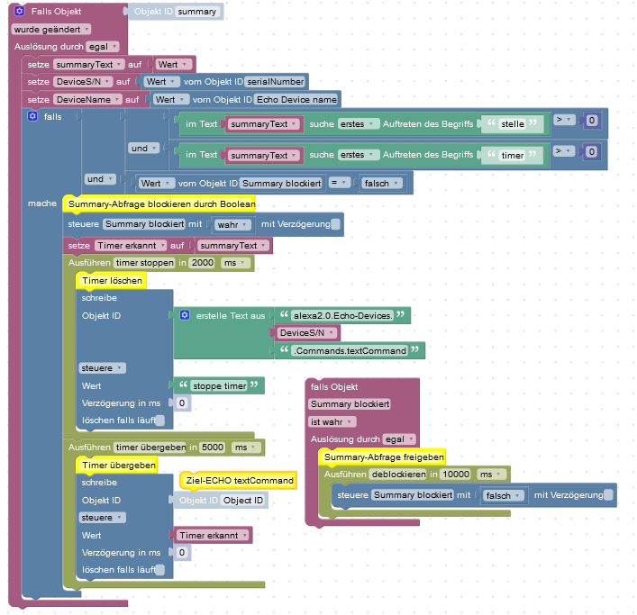

                      DJMarc75D Offline
                      DJMarc75D Offline
                      DJMarc75
                      @liv-in-sky
                      Ist sicherlich ausbaufähig aber schon ziemlich brauchbar denke ich...
                      Hier das Blockly...

                                                            <block type="comment" id="MNm),JEV5Ci4|`%|CM#K">
                                                              <field name="COMMENT">Timer löschen</field>
                                                              <next>
                                                                <block type="control_ex" id="l|~9;@x![8jLSrHmMk[~">
                                                                  <field name="TYPE">false</field>
                                                                  <value name="OID">
                                                                    <shadow type="field_oid" id="XOd8,ze}d.[)(0-r0EW]">
                                                                      <field name="oid">Object ID</field>
                                                                    </shadow>
                                                                    <block type="text_join" id="(NWLp^9Y2xDuxLt]C+Sx">
                                                                      <value name="ADD0">
                                                                        <block type="text" id="BB=dmE6*fFhC3[5zDM7k">
                                                                          <field name="TEXT">alexa2.0.Echo-Devices.</field>
                                                                        </block>
                                                                      </value>
                                                                      <value name="ADD1">
                                                                        <block type="variables_get" id="xIR@`,oT[/^aLY!kg?#Z">
                                                                          <field name="VAR" id="K[;JE-;Gfb9$^9,[fiF/">DeviceS/N</field>
                                                                        </block>
                                                                      </value>
                                                                      <value name="ADD2">
                                                                        <block type="text" id="l{FTT|=I%gvP?--;%uXU">
                                                                          <field name="TEXT">.Commands.textCommand</field>
                                                                        </block>
                                                                      </value>
                                                                    </block>
                                                                  </value>
                                                                  <value name="VALUE">
                                                                    <shadow type="logic_boolean" id="a{7Ai#_3V6iaxJcAo;E*">
                                                                    </shadow>
                                                                    <block type="text" id="$gn![hOv~eEaq81k[}1Q">
                                                                      <field name="TEXT">stoppe timer</field>
                                                                    </block>
                                                                  </value>
                                                                  <value name="DELAY_MS">
                                                                    <shadow type="math_number" id="Ugn*$K~y|qI7VSHnXu;)">
                                                                      <field name="NUM">0</field>
                                                                    </shadow>
                                                                  </value>
                                                                </block>
                                                              </next>
                                                            </block>
                                                          </statement>
                                                          <next>
                                                            <block type="timeouts_settimeout" id="@qa/QwdtJg7*~I@U-6sB">
                                                              <field name="NAME">timer übergeben</field>
                                                              <field name="DELAY">5000</field>
                                                              <field name="UNIT">ms</field>
                                                              <statement name="STATEMENT">
                                                                <block type="comment" id="C*;L6(iVzA$p2~YQ(Y+m">
                                                                  <field name="COMMENT">Timer übergeben</field>
                                                                  <next>
                                                                    <block type="control_ex" id="=~LdXwaoojliGXBgfuis">
                                                                      <value name="OID">
                                                                        <shadow type="field_oid" id="Tx3gA8,SGv}:Sh7[Z/3o">
                                                                        </shadow>
                                                                      </value>
                                                                        <shadow type="logic_boolean" id="54@iR4G9!%z_8Yb%Jj[.">
                                                                        </shadow>
                                                                        <block type="variables_get" id="=,__kqcGx5DSH2X;DBLH">
                                                                          <field name="VAR" id="UFxK%+XGeLufu7z/l1X5">Timer erkannt</field>
                                                                        </block>
                                                                      </value>
                                                                        <shadow type="math_number" id="?IMWa*uo*~ApzsC^7@dj">
                                                                        </shadow>
                                                                      </value>
                                                                    </block>
                                                                  </next>
                                                                </block>
                                                              </statement>
                                                            </block>
                                                          </next>
                                                        </block>
                                                      </next>
                                                    </block>
                                                  </next>
                                                </block>
                                              </next>
                                            </block>
                                          </statement>
                                        </block>
                                      </next>
                                    </block>
                                  </next>
                                </block>
                              </next>
                            </block>
                          </statement>
                        </block>
                        <block type="on" id="+mrb(8yi!ZL?v+V9u[0v" x="-763" y="212">
                          <field name="OID">0_userdata.0.Alexa.Devices.Summary_blockiert</field>
                          <field name="CONDITION">true</field>
                            <block type="comment" id="y1}0A88fO(JNi]@H$Pj[">
                              <field name="COMMENT">Summary-Abfrage freigeben</field>
                              <next>
                                <block type="timeouts_settimeout" id="U/2EL4zDV%R$y%Xab?YJ">
                                  <field name="NAME">deblockieren</field>
                                  <field name="DELAY">10000</field>
                                    <block type="control" id="F8n{y:!y!##[77?C2af,">
                                        <block type="logic_boolean" id="P-kHG{Z1rt0!ak=G01~]">
                                        </block>
                                      </value>
                                    </block>
                                  </statement>
                                </block>
                              </next>
                            </block>
                          </statement>
                        </block>
                        <block type="comment" id="kLLvQ18IbE(!kwr:[*TJ" x="-962" y="387">
                          <field name="COMMENT">Ziel-ECHO textCommand</field>
                        </block>
                      </xml>
