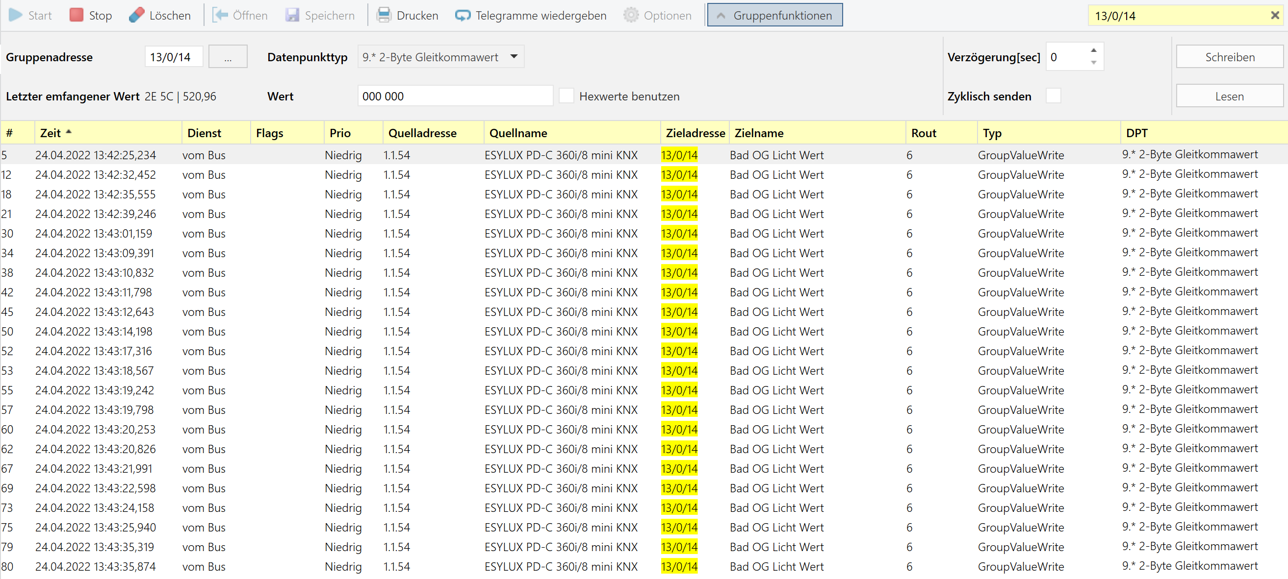

    I updated all Adapter to the current version.
    Now the log is full of those messages.... any Idea?
    --> WRITE: No valid datapointtype set for
      "_id": "knx.0.OG_Bad.Licht.Bad_OG_Licht_Wert",
      "type": "state",
      "common": {
        "name": "Bad OG Licht Wert",
        "type": "mixed",
        "role": "value",
        "read": true,
        "write": true
      "native": {
        "dpt": "",
        "address": "13/0/14",
        "addressRefId": "P-05DD-0_GA-397",
        "statusGARefId": "",
        "actGARefId": "",
        "objRef": "O-19_R-83",
        "devName": "M-0080_A-7030-13-5A34-O00C5",
        "devInst": "P-05DD-0_DI-22",
        "objectSize": ""
      "acl": {
        "object": 1636,
        "state": 1636,
      "user": "system.user.admin",
      "ts": 1650800365985

      Found the Problem:
      "dpt": "DPT9.004", fixed it.
      Strange that an update creates those errors
