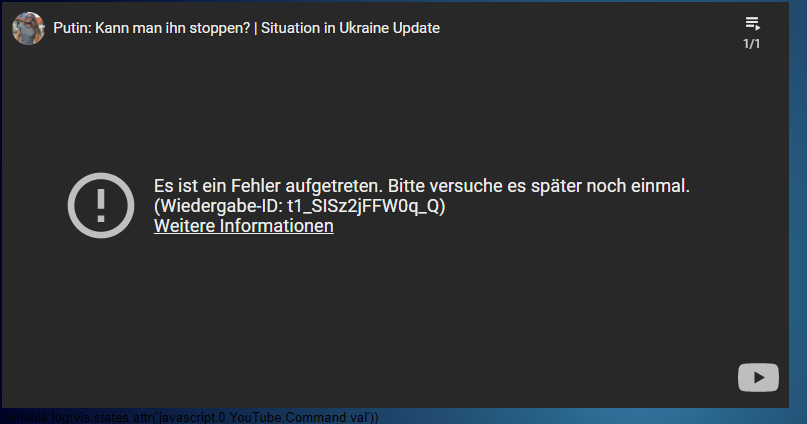

          ich habe schon x-sachen getestet - kommt immer der schwarze bildschirm

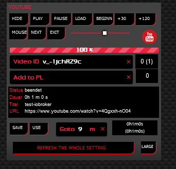

                  ist ein standard html widget
                  dieses widget soll in verschiedenen views aufrufbar sein
                  [{"tpl":"tplHtml","data":{"g_fixed":true,"g_visibility":true,"g_css_font_text":false,"g_css_background":true,"g_css_shadow_padding":false,"g_css_border":false,"g_gestures":false,"g_signals":false,"g_last_change":false,"visibility-cond":"==","visibility-val":1,"visibility-groups-action":"hide","refreshInterval":"0","signals-cond-0":"==","signals-val-0":true,"signals-icon-0":"/vis/signals/lowbattery.png","signals-icon-size-0":0,"signals-blink-0":false,"signals-horz-0":0,"signals-vert-0":0,"signals-hide-edit-0":false,"signals-cond-1":"==","signals-val-1":true,"signals-icon-1":"/vis/signals/lowbattery.png","signals-icon-size-1":0,"signals-blink-1":false,"signals-horz-1":0,"signals-vert-1":0,"signals-hide-edit-1":false,"signals-cond-2":"==","signals-val-2":true,"signals-icon-2":"/vis/signals/lowbattery.png","signals-icon-size-2":0,"signals-blink-2":false,"signals-horz-2":0,"signals-vert-2":0,"signals-hide-edit-2":false,"lc-type":"last-change","lc-is-interval":true,"lc-is-moment":false,"lc-format":"","lc-position-vert":"top","lc-position-horz":"right","lc-offset-vert":0,"lc-offset-horz":0,"lc-font-size":"12px","lc-font-family":"","lc-font-style":"","lc-bkg-color":"","lc-color":"","lc-border-width":"0","lc-border-style":"","lc-border-color":"","lc-border-radius":10,"lc-zindex":0,"html":"    <div id=\"player\"></div>\n\n    <script>\n      // 2. This code loads the IFrame Player API code asynchronously.\n      var tag = document.createElement('script');\n\n      tag.src = \"https://www.youtube.com/iframe_api\";\n      var firstScriptTag = document.getElementsByTagName('script')[0];\n      firstScriptTag.parentNode.insertBefore(tag, firstScriptTag);\n\n      // 3. This function creates an <iframe> (and YouTube player)\n      //    after the API code downloads.\n      var player;\n      \n      function onYouTubeIframeAPIReady() {\n        player = new YT.Player('player', {\n          height: '480',\n          width: '640',\n          videoId: '4Qgxxh-nO04',\n           playerVars:{ origin:window.location.href, enablejsapi:1,\n                       loop: 1\n                      },\n       \n          events: {\n            'onReady': onPlayerReady,\n            'onStateChange': onPlayerStateChange\n          }\n        });\n      }\n\n      // 4. The API will call this function when the video player is ready.\n      function onPlayerReady(event) {\n        event.target.playVideo();\n      }\n\n      // 5. The API calls this function when the player's state changes.\n      //    The function indicates that when playing a video (state=1),\n      //    the player should play for six seconds and then stop.\n      var done = false;\n      function onPlayerStateChange(event) {\n        if (event.data == YT.PlayerState.PLAYING && !done) {\n          \n          done = true;\n        }\n      }\n      function stopVideo() {\n        player.stopVideo();\n      }\n      \n      /*----------------------------------------------------------------------*/\n      \n      setInterval( function () {\n        console.log(vis.states.attr('javascript.0.YouTube.Command.val'))\nvar myState = player.getPlayerState();\nswitch (myState) { case -1: vis.setValue(\"javascript.0.YouTube.PlayerStatus2\",\"nicht gestartet\");break; case 0: vis.setValue(\"javascript.0.YouTube.PlayerStatus2\",\"beendet\") ;break; case 1: vis.setValue(\"javascript.0.YouTube.PlayerStatus2\",\"Wiedergabe\");break; case 2: vis.setValue(\"javascript.0.YouTube.PlayerStatus2\",\"Pause\");break; case 3: vis.setValue(\"javascript.0.YouTube.PlayerStatus2\",\"Buffered\");break; case 5: vis.setValue(\"javascript.0.YouTube.PlayerStatus2\",\"in Position\");break;\n\n}\n\n vis.setValue(\"javascript.0.YouTube.PlayerStatus\",player.getPlayerState());\n if(player.getPlayerState()==1) {\n vis.setValue(\"javascript.0.YouTube.Spiele\",player.getPlaylistIndex()); \n vis.setValue(\"javascript.0.YouTube.MomentanURL\",player.getVideoUrl());console.log(player.getVideoUrl());\n vis.setValue(\"javascript.0.YouTube.VideoCurrent\", Math.round(player.getCurrentTime()));\n if (player.getVideoData().title!=null ) console.log(player.getVideoData().title);\n if (player.getVideoData().title!=null ) vis.setValue(\"javascript.0.YouTube.VideoTitle\",player.getVideoData().title);\n vis.setValue(\"javascript.0.YouTube.VideoDuration\", Math.round(player.getDuration()));\n console.log(player.getDuration());\n var helperlein=player.getDuration();\n vis.setValue(\"javascript.0.YouTube.VideoDauer\", Math.floor(((helperlein)/60/60) % 24) +\"h \"+ Math.floor( ((helperlein)/60) % 60 )+\" m \" + Math.floor( ((helperlein)) % 60 )+ \" s\");\n \nconsole.log(Math.round(player.getDuration())-Math.round(player.getCurrentTime()));\n if (Math.round(player.getDuration()) - Math.round(player.getCurrentTime()) <5 ) vis.setValue(\"javascript.0.YouTube.EndeVideo\",true) ;\n vis.setValue(\"javascript.0.YouTube.Save.SaveSettingAktuell\",player.getVideoData().video_id+','+Math.round(player.getCurrentTime()));\n \n \n}\n\n\n}, 5000);\n\n      \n      \n      \n      \n      \n      \n      \n       /*----------------------------------------------------------------------*/\n      \n      \n      \n    </script>\n    \n","class":"","visibility-oid":"javascript.0.YouTube.Visible"},"style":{"left":"31px","top":"1086px","width":"640px","height":"480px","z-index":"900","background-color":"transparent"},"widgetSet":"basic"}]
                  dieses widget macht die steuerung

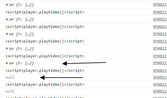

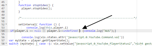

                        warum funktioniert das nicht? möchte das interval beenden, wenn das yt-player object null ist
                        im browser log sieht es so aus
                        • liv-in-skyL liv-in-sky

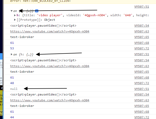

                            was ich nicht verstehe - das log zeigt null aber das if reagiert nicht - hast du eine idee , warum das so sein könnte - dann wäre alle gut und ich könnte das schon hinbkommen
                                var ytInter=  setInterval( function () {
                                     console.log(player.i);
                                 if(player.i == null || player.i==undefined || !player) {console.log("AUS");clearInterval(ytInter);}
                            hier sieht man, nachdem ich den player destroyed habe, dass null gelogt wird - verstehe das einfach nicht

                                @liv-in-sky woher kommt i ?
                                innerhalb von setTimeout/setInterval bis du nicht mehr im normalen Skript scope.
                                d.h. ein vor setInterval definiertes i ist innen drin nicht mehr verfügbar.
                                du kannst mal probieren das i (leider sehe ich den code dafür nicht) mit let anstatt mit var zu deklarieren.
                                wenn das nicht funktioniert, dann muss man der funktion das i per bind mitgeben.
                                aber irgendwie glaube ich hast du bei player.i noch ein denkfehler.
                                zeig mal den code wo i definiert wird

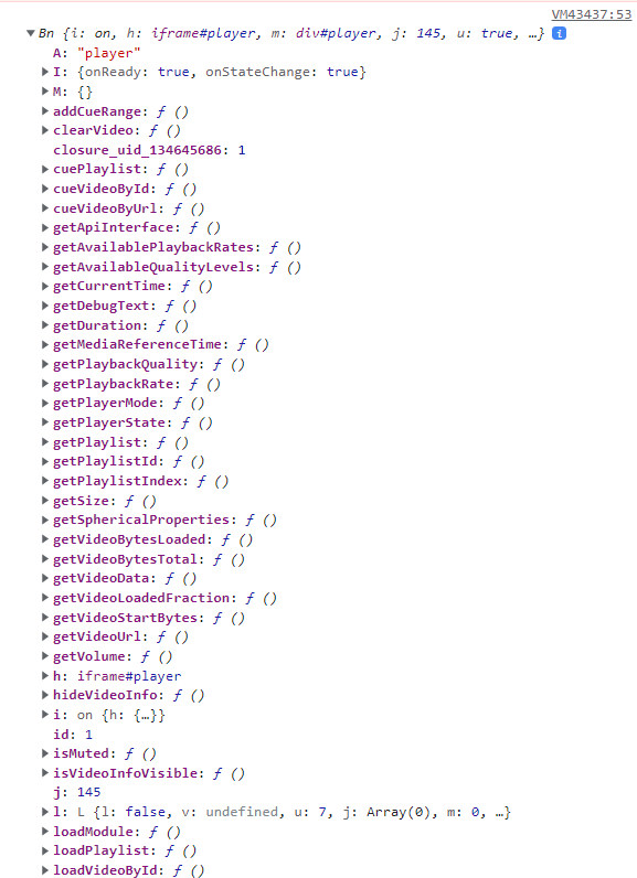

                                  @oliverio
                                  wenn ich als ersten befehl innerhalb setInterval den clearInterval aufrufe stoppt das script - aber das console log("AUS") wird schon nicht ausgeführt - if trifft nicht zu - das kapier ich nicht
                                  das i definiert der yt-player - hier das ganze object - console.log(player) - ganz unten siehst du i -
                                  das war der wert, der mir aufgefallen war - daher nutze ich diesen wert - ich kann auch auf player prüfen - das geht auch nicht
                                  nach dem befehl destroy player kommt das als object zurück - daher habe ich i gnommen
