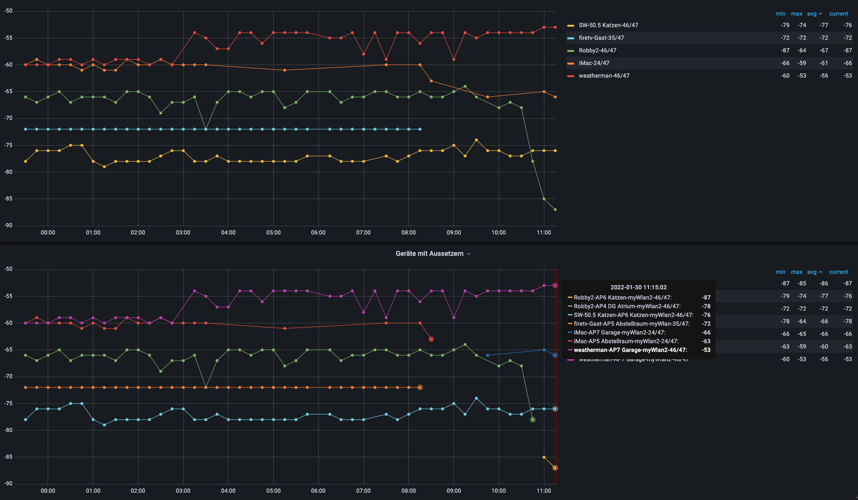

    In grafana kann man dann z.B. mit
    with anz as
      (select count(name) as anz2 ,name as aname
       from zotac.unifi where $__timeFilter(ts) and name<>"unknown" and length(name)>0
       group by name order by anz2 desc fetch first row only),
       list as
      (select count(name) as anz3,name as lname
       group by name)
    SELECT
      CONVERT_TZ(ts,"MET","UTC") as time,
      signale as value,
      concat(u.name,"-",l.anz3,"/",a.anz2) as metric
    FROM unifi u,list l,anz a
    WHERE
      $__timeFilter(ts)
      and length(name)>0 and name=lname
      and name<>"unknown" and name not like "%iPhone%" and name not like "%Pad%"
      and name not like "%mobil%"
      and name in (select distinct lname from list l,anz a where l.anz3<a.anz2)
      order by ts
    Hier sieht man dann z.B. dass der weatherman 46/47 möglichen Kontakten hatte. Der iMac hat Nachts geschlafen und war nicht immer im WLAN.
