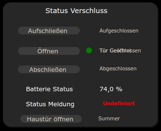

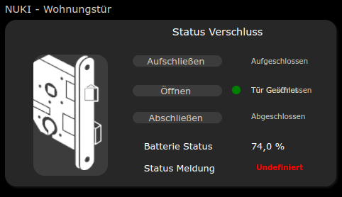

      Dragon
      schrieb am zuletzt editiert von Dragon
        "settings": {
          "style": {
            "background-color": ""
          "theme": "dark-hive",
          "sizex": "435",
          "sizey": "350",
          "gridSize": "",
          "useBackground": false,
          "snapType": null
        "widgets": {
          "e00001": {
            "tpl": "tplValueFloat",
            "data": {
              "oid": "nuki-extended.0.smartlocks.wohnungstür.state.batteryChargeState",
              "visibility-cond": "==",
              "visibility-val": 1,
              "is_comma": "true",
              "factor": "1",
              "html_append_singular": "",
              "html_append_plural": " %",
              "digits": "1",
              "visibility-groups-action": "hide",
              "lc-type": "last-change",
              "lc-is-interval": true,
              "lc-is-moment": false,
              "lc-format": "",
              "lc-position-vert": "top",
              "lc-position-horz": "right",
              "lc-offset-vert": 0,
              "lc-offset-horz": 0,
              "lc-font-size": "12px",
              "lc-font-family": "",
              "lc-font-style": "",
              "lc-bkg-color": "",
              "lc-color": "",
              "lc-border-width": "0",
              "lc-border-style": "",
              "lc-border-color": "",
              "lc-border-radius": 10,
              "lc-zindex": 0,
              "g_signals": false,
              "signals-cond-0": "==",
              "signals-val-0": true,
              "signals-icon-0": "/vis.0/main/lowbattery.png",
              "signals-icon-size-0": 0,
              "signals-blink-0": false,
              "signals-horz-0": 0,
              "signals-vert-0": 0,
              "signals-hide-edit-0": false,
              "signals-cond-1": "==",
              "signals-val-1": true,
              "signals-icon-1": "/vis.0/main/lowbattery.png",
              "signals-icon-size-1": 0,
              "signals-blink-1": false,
              "signals-horz-1": 0,
              "signals-vert-1": 0,
              "signals-hide-edit-1": false,
              "signals-cond-2": "==",
              "signals-val-2": true,
              "signals-icon-2": "/vis.0/main/lowbattery.png",
              "signals-icon-size-2": 0,
              "signals-blink-2": false,
              "signals-horz-2": 0,
              "signals-vert-2": 0,
              "signals-hide-edit-2": false,
              "html_prepend": " ",
              "g_fixed": false
            "style": {
              "left": "267px",
              "top": "225px",
              "width": "94px",
              "height": "20px",
              "color": "white",
              "text-align": "left",
              "font-family": "Verdana, Geneva, sans-serif",
              "font-style": "normal",
              "font-variant": "normal",
              "font-weight": "normal",
              "font-size": "medium",
              "z-index": "25"
            "widgetSet": "basic"
          "e00002": {
            "tpl": "tplValueStringRaw",
            "data": {
              "oid": "",
              "visibility-val": "false",
              "gestures-offsetX": 0,
              "gestures-offsetY": 0,
              "lc-format": "",
              "lc-bkg-color": "",
              "lc-color": "",
              "lc-zindex": 0,
              "html_prepend": "Tür Geschlossen",
              "visibility-groups": null,
              "visibility-oid": "zigbee.0.00158d000542ba32.opened",
              "gestures-rotating-minimum": "-1"
            "style": {
              "left": "267px",
              "top": "129px",
              "width": "120px",
              "height": "18px",
              "color": "#d7cec1",
              "font-style": "",
              "font-variant": "",
              "font-size": "small",
              "text-shadow": "none",
              "z-index": "1",
              "border-style": "none"
          "e00003": {
            "tpl": "tplValueListHtml8",
            "data": {
              "oid": "nuki-extended.0.smartlocks.wohnungstür.state.lockState",
              "g_fixed": true,
              "g_visibility": true,
              "g_css_font_text": true,
              "g_css_background": false,
              "g_css_shadow_padding": false,
              "g_css_border": false,
              "g_gestures": false,
              "g_signals": false,
              "g_last_change": false,
              "count": "9",
              "signals-icon-0": "/vis/signals/lowbattery.png",
              "signals-icon-1": "/vis/signals/lowbattery.png",
              "signals-icon-2": "/vis/signals/lowbattery.png",
              "lc-format": "",
              "lc-bkg-color": "",
              "lc-color": "",
              "lc-zindex": 0,
              "name": "Status_normal",
              "value2": "Entriegelung",
              "value3": "Aufgeschlossen",
              "value5": "Geöffnet",
              "value6": "Un-/Lock`Go",
              "value7": "Öffnung",
              "value8": "Motor blockiert",
              "visibility-oid": "nuki-extended.0.smartlocks.wohnungstür.state.batteryCritical",
              "html_prepend": "",
              "style5": "color: red; font-size: small; font-weight: bolder",
              "style6": "color: red; font-size: small; font-weight: bolder",
              "test_list": "9",
              "style2": "color: red; font-size: small; font-weight: bolder",
              "value0": "Unkalibriert",
              "value1": "Abgeschlossen",
              "value4": "Verriegelung",
              "value9": "Undefiniert",
              "value10": "Pause",
              "value11": "11",
              "style0": "color: red; font-size: small; font-weight: bolder",
              "style7": "color: red; font-size: small; font-weight: bolder",
              "style8": "color: red; font-size: small; font-weight: bolder",
              "style3": "color: red; font-size: small; font-weight: bolder",
              "style1": "color: red; font-size: small; font-weight: bolder",
              "style4": "color: red; font-size: small; font-weight: bolder",
              "style9": "color: red; font-size: small; font-weight: bolder",
              "style10": "color: #ffffff; font-size: small; font-weight: bolder",
              "style11": "color: #ffffff; font-size: small; font-weight: bolder",
              "value12": "Fehler",
              "comment": "",
              "value17": "Zone Cleanup",
              "style17": "color: #ffffff; font-size: small; font-weight: bolder",
              "style14": "",
              "style12": "color: red; font-size: small; font-weight: bolder"
            "style": {
              "left": "236px",
              "top": "265px",
              "width": "161px",
              "height": "16px",
              "z-index": "1",
              "text-align": "center"
          "e00004": {
            "tpl": "tplValueList",
            "data": {
              "oid": "nothing_selected",
              "g_fixed": false,
              "g_visibility": false,
              "g_signals": false,
              "lc-format": "",
              "lc-bkg-color": "",
              "lc-color": "",
              "lc-zindex": 0,
              "html_prepend": "Status Meldung"
            "style": {
              "left": "78px",
              "top": "264px",
              "color": "#FFFFFF",
              "z-index": "21",
              "width": "130px",
              "height": "20px"
          "e00005": {
            "tpl": "tplJquiToogle",
            "data": {
              "oid": "nuki-extended.0.smartlocks.wohnungstür._ACTION.LOCK",
              "g_fixed": false,
              "g_css_background": true,
              "g_css_border": true,
      Versuch es damit...

        Das hier ist auch noch eine Option.
                "lc-format": "",
                "lc-bkg-color": "",
                "lc-color": "",
                "lc-zindex": 0,
              "style": {
                "left": "454px",
                "top": "135px",
                "width": "120px",
                "height": "18px",
                "color": "#d7cec1",
                "font-style": "",
                "font-variant": "",
                "z-index": "1",
            "e00003": {
              "data": {
                "g_fixed": true,
                "g_signals": false,
                "count": "9",
                "lc-format": "",
                "lc-bkg-color": "",
                "lc-color": "",
                "lc-zindex": 0,
                "html_prepend": "",
                "test_list": "9",
                "value10": "Pause",
                "value11": "11",
                "comment": "",
                "style14": "",
              "style": {
                "left": "423px",
                "top": "272px",
                "width": "161px",
                "height": "16px",
                "z-index": "1",
            "e00004": {
              "data": {
                "g_fixed": false,
                "g_signals": false,
                "lc-format": "",
                "lc-bkg-color": "",
                "lc-color": "",
                "lc-zindex": 0,
              "style": {
                "left": "265px",
                "top": "270px",
                "color": "#FFFFFF",
                "z-index": "21",
                "width": "130px",
                "height": "20px"
            "e00005": {
              "data": {
                "g_fixed": false,
                "g_signals": false,
                "lc-format": "",
                "lc-bkg-color": "",
                "lc-color": "",
                "lc-zindex": 0,
                "src_true": "",
                "src_false": "",
                "label": "Abschließen",
              "style": {
                "left": "245px",
                "top": "182px",
                "background": "rgba(60, 60, 60, 20)",
                "border-radius": "20px",
                "border-width": "0px",
                "z-index": "45",
                "width": "158px",
                "height": "20px",
                "position": "",
                "text-align": "center",
                "line-height": "1.4",
                "color": "#d7cec1"
              "widgetSet": "jqui"
            "e00006": {
              "data": {
                "oid": "nuki-extended.0.smartlocks.wohnungstür._ACTION.UNLATCH",
                "g_fixed": false,
                "g_signals": false,
                "lc-format": "",
                "lc-bkg-color": "",
                "lc-color": "",
                "lc-zindex": 0,
                "src_true": "",
                "src_false": "",
                "label": "Öffnen",
              "style": {
                "left": "245px",
                "top": "134px",
                "z-index": "45",
                "width": "158px",
                "height": "20px",
                "position": "",
                "color": "#d7cec1"
              "widgetSet": "jqui"
            "e00007": {
              "data": {
                "oid": "nuki-extended.0.smartlocks.wohnungstür._ACTION.UNLOCK",
                "g_fixed": false,
                "g_signals": false,
                "lc-format": "",
                "lc-bkg-color": "",
                "lc-color": "",
                "lc-zindex": 0,
                "src_true": "",
                "src_false": "",
                "label": "Aufschließen",
                "invert_icon": false
              "style": {
                "left": "245px",
                "top": "82px",
                "z-index": "45",
                "width": "158px",
                "height": "20px",
                "position": "",
                "color": "#d7cec1"
              "widgetSet": "jqui"
            "e00008": {
              "data": {
                "g_fixed": false,
                "g_signals": false,
                "lc-format": "",
                "lc-bkg-color": "",
                "lc-color": "",
                "lc-zindex": 0,
                "html_prepend": "Batterie Status"
              "style": {
                "left": "265px",
                "top": "232px",
                "color": "#FFFFFF",
                "z-index": "21",
                "width": "130px",
                "height": "20px"
            "e00009": {
              "data": {
                "oid": "",
                "lc-format": "",
                "lc-bkg-color": "",
                "lc-color": "",
                "lc-zindex": 0,
                "html_prepend": "Abgeschlossen",
                "visibility-val": "true",
                "visibility-oid": "nuki-extended.0.smartlocks.wohnungstür.state.locked"
              "style": {
                "left": "454px",
                "top": "182px",
                "width": "100px",
                "height": "18px",
                "color": "#d7cec1",
                "font-style": "",
                "font-variant": "",
                "z-index": "5",
            "e00010": {
              "data": {
                "oid": "",
                "lc-format": "",
                "lc-bkg-color": "",
                "lc-color": "",
                "lc-zindex": 0,
                "html_prepend": "Tür Geöffnet",
              "style": {
                "left": "454px",
                "top": "135px",
                "width": "120px",
                "height": "18px",
                "color": "#d7cec1",
                "font-style": "",
                "font-variant": "",
                "z-index": "5",
            "e00011": {
              "data": {
                "oid": "zigbee.0.00158d000542ba32.opened",
                "count": "1",
                "value0": "true",
                "value1": "false",
                "style1": "background-color: red",
                "style0": "background-color: green",
                "value2": "",
                "style2": "background-color: red",
                "test_list": "0",
                "lc-format": "",
                "lc-bkg-color": "",
                "lc-color": "",
                "lc-border-width": "2",
                "lc-border-radius": "0",
                "lc-zindex": 0,
              "style": {
                "left": "420px",
                "top": "135px",
                "color": "transparent",
                "font-weight": "",
                "font-size": "x-small",
                "width": "15px",
                "height": "15px",
                "z-index": "20",
                "overflow-x": "",
                "border-radius": "50px"
            "e00012": {
              "data": {
                "oid": "",
                "lc-format": "",
                "lc-bkg-color": "",
                "lc-color": "",
                "lc-zindex": 0,
                "html_prepend": "Aufgeschlossen",
              "style": {
                "left": "454px",
                "top": "84px",
                "width": "100px",
                "height": "18px",
                "color": "#d7cec1",
                "font-style": "",
                "font-variant": "",
                "z-index": "5",
            "e00013": {
              "data": {
                "g_fixed": false,
                "g_signals": false,
                "lc-format": "",
                "lc-bkg-color": "",
                "lc-color": "",
                "lc-zindex": 0,
                "html_prepend": "Status Verschluss"
              "style": {
                "left": "315px",
                "top": "47px",
                "font-size": "large",
                "color": "#FFFFFF",
                "z-index": "21",
                "width": "170px"
            "e00014": {
              "data": {
                "oid": "nuki-extended.0.info.connection",
                "g_fixed": false,
                "g_signals": true,
                "signals-val-0": "false",
                "signals-icon-0": "/vis.0/Bilder/geoeffnet.png",
                "signals-icon-size-0": "120",
                "signals-val-1": "true",
                "signals-icon-1": "/vis.0/Bilder/verschlossen.png",
                "signals-icon-size-1": "120",
                "signals-val-2": "false",
                "signals-icon-2": "/vis.0/Bilder/entriegelt.png",
                "signals-icon-size-2": "120",
                "lc-format": "",
                "lc-bkg-color": "",
                "lc-color": "",
                "lc-zindex": 0,
                "src_true": "true",
                "src_false": "",
                "signals-oid-2": "nuki-extended.0.smartlocks.wohnungstür.state.locked",
                "label": "",
                "signals-oid-1": "nuki-extended.0.smartlocks.wohnungstür.state.locked",
                "signals-oid-0": "nuki-extended.0.smartlocks.wohnungstür.state.closed",
              "style": {
                "left": "70px",
                "top": "99px",
                "z-index": "44",
                "width": "132px",
                "height": "214px",
                "position": "",
                "color": ""
              "widgetSet": "jqui"
            "e00015": {
              "tpl": "tplFrame",
              "data": {
                "title": "NUKI - Wohnungstür",
                "title_color": "#d7cec1",
                "title_top": "-30",
                "title_left": "0",
                "header_height": "0",
                "header_color": "",
                "title_back": "",
                "lc-format": "",
                "lc-bkg-color": "",
                "lc-color": "",
                "lc-zindex": 0,
                "visibility-oid": ""
              "style": {
                "left": "20px",
                "top": "36px",
                "width": "584px",
                "height": "304px",
                "z-index": "0",
                "color": "",
                "background": "rgba(39, 39, 39, 50)",
                "border-style": "none",
                "box-shadow": "2px 2px 3px rgba(20, 20, 20, 50)",
            "e00016": {
              "data": {
                "oid": "",
                "lc-format": "",
                "lc-bkg-color": "",
                "lc-color": "",
                "lc-zindex": 0,
                "html_prepend": "Summer",
                "visibility-oid": "sonoff.0.Tueroeffner.POWER"
              "style": {
                "left": "454px",
                "top": "309px",
                "width": "100px",
                "height": "18px",
                "color": "#d7cec1",
                "font-style": "",
                "font-variant": "",
                "z-index": "5",
            "e00017": {
              "data": {
                "oid": "sonoff.0.Tueroeffner.POWER",
                "g_fixed": false,
                "g_signals": false,
                "lc-format": "",
                "lc-bkg-color": "",
                "lc-color": "",
                "lc-zindex": 0,
                "src_true": "",
                "src_false": "",
                "label": "Haustür öffnen",
              "style": {
                "left": "245px",
                "top": "310px",
                "z-index": "45",
                "width": "158px",
                "height": "20px",
                "position": "",
                "color": "#d7cec1"
              "widgetSet": "jqui"
          "name": "Smartlock",
          "filterList": []
              "settings": {
                "style": {
                "sizex": "625",
                "sizey": "350",
                "gridSize": "",
                "snapType": null
              "widgets": {
                "e00001": {
                  "data": {
                    "is_comma": "true",
                    "factor": "1",
                    "digits": "1",
                    "lc-format": "",
                    "lc-bkg-color": "",
                    "lc-color": "",
                    "lc-zindex": 0,
                    "g_signals": false,
                    "g_fixed": false
                  "style": {
                    "left": "454px",
                    "top": "232px",
                    "width": "94px",
                    "height": "20px",
                    "color": "white",
                    "z-index": "25"
                "e00002": {
                  "data": {
                    "oid": "",
                    "lc-format": "",
                    "lc-bkg-color": "",
                    "lc-color": "",
                    "lc-zindex": 0,
                  "style": {
                    "left": "454px",
                    "top": "135px",
                    "width": "120px",
                    "height": "18px",
                    "color": "#d7cec1",
                    "font-style": "",
                    "font-variant": "",
                    "z-index": "1",
                "e00003": {
                  "data": {
                    "g_fixed": true,
                    "g_signals": false,
                    "count": "9",
                    "lc-format": "",
                    "lc-bkg-color": "",
                    "lc-color": "",
                    "lc-zindex": 0,
                  "style": {
                    "left": "454px",
                    "top": "182px",
                    "width": "100px",
                    "height": "18px",
                    "color": "#d7cec1",
                    "font-style": "",
                    "font-variant": "",
                    "z-index": "5",
                "e00010": {
                  "data": {
                    "oid": "",
                    "lc-format": "",
                    "lc-bkg-color": "",
                    "lc-color": "",
                    "lc-zindex": 0,
                  "style": {
                    "left": "454px",
                    "top": "135px",
                    "width": "120px",
                    "height": "18px",
                    "color": "#d7cec1",
                    "font-style": "",
                    "font-variant": "",
                    "z-index": "5",
                "e00011": {
                  "data": {
                    "count": "1",
                    "value0": "true",
                    "value1": "false",
                    "value2": "",
                    "test_list": "0",
                    "lc-format": "",
                    "lc-bkg-color": "",
                    "lc-color": "",
                    "lc-zindex": 0,
                  "style": {
                    "left": "420px",
                    "top": "135px",
                    "font-weight": "",
                    "width": "15px",
                    "height": "15px",
                    "z-index": "20",
                    "overflow-x": "",
                "e00012": {
                  "data": {
                    "oid": "",
                    "lc-format": "",
                    "lc-bkg-color": "",
                    "lc-color": "",
                    "lc-zindex": 0,
                  "style": {
                    "left": "454px",
                    "top": "84px",
                    "width": "100px",
                    "height": "18px",
                    "color": "#d7cec1",
                    "font-style": "",
                    "font-variant": "",
                    "z-index": "5",
                "e00013": {
                  "data": {
                    "g_fixed": false,
                    "g_signals": false,
                    "lc-format": "",
                    "lc-bkg-color": "",
                    "lc-color": "",
                    "lc-zindex": 0,
                  "style": {
                    "left": "315px",
                    "top": "47px",
                    "color": "#FFFFFF",
                    "z-index": "21",
                    "width": "170px"
                "e00014": {
                  "data": {
                    "g_fixed": false,
                    "g_signals": true,
                    "lc-format": "",
                    "lc-bkg-color": "",
                    "lc-color": "",
                    "lc-zindex": 0,
                    "src_true": "true",
                    "src_false": "",
                    "label": "",
                  "style": {
                    "left": "70px",
                    "top": "99px",
                    "z-index": "44",
                    "width": "132px",
                    "height": "214px",
                    "position": "",
                    "color": ""
                  "widgetSet": "jqui"
                "e00015": {
                  "tpl": "tplFrame",
                  "data": {
                    "title_top": "-30",
                    "title_left": "0",
                    "header_color": "",
                    "title_back": "",
                    "lc-format": "",
                    "lc-bkg-color": "",
                    "lc-color": "",
                    "lc-zindex": 0,
                  "style": {
                    "left": "20px",
                    "top": "36px",
                    "width": "584px",
                    "height": "304px",
                    "z-index": "0",
                    "color": "",
                "e00016": {
                  "data": {
                    "oid": "",
                    "lc-format": "",
                    "lc-bkg-color": "",
                    "lc-color": "",
                    "lc-zindex": 0,
                  "style": {
                    "left": "454px",
                    "top": "309px",
                    "width": "100px",
                    "height": "18px",
                    "color": "#d7cec1",
                    "font-style": "",
                    "font-variant": "",
                    "z-index": "5",
                "e00017": {
                  "data": {
                    "g_fixed": false,
                    "g_signals": false,
                    "lc-format": "",
                    "lc-bkg-color": "",
                    "lc-color": "",
                    "lc-zindex": 0,
                    "src_true": "",
                    "src_false": "",
                  "style": {
                    "left": "245px",
                    "top": "310px",
                    "z-index": "45",
                    "width": "158px",
                    "height": "20px",
                    "position": "",
                    "color": "#d7cec1"
                  "widgetSet": "jqui"
              "filterList": []

            @dragon
            Ich habe das vor Jahren mal so integriert. Vor einigen Wochen habe ich aus versehen die Bilder gelöscht. Hast du diese zufällig noch?
