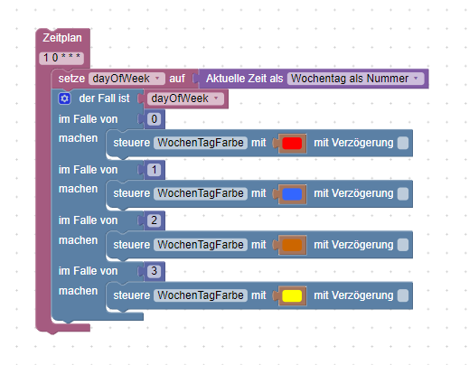

          @flixer
          blockly (beispiel - nicht ganz fertig - fehlen noch tage)
          <block xmlns="https://developers.google.com/blockly/xml" type="schedule" id="^;iKB,Q6ktx_)cS(~G:|" x="-62.1131591796875" y="312.3018798828125">
           <field name="SCHEDULE">1 0 * * *</field>
           <statement name="STATEMENT">
             <block type="variables_set" id="rhqCRg3h6:~sqig:jiq1">
               <field name="VAR" id=":a}5LSHp1`o=P[`C/Fw@">dayOfWeek</field>
               <value name="VALUE">
                 <block type="time_get" id="%EQKyFqXRS[7C47=YA+A">
                   <field name="OPTION">wd</field>
                 </block>
               </value>
               <next>
                 <block type="logic_switch_case" id="o{`#2^aYWPV].9{X%z@I">
                   <mutation xmlns="http://www.w3.org/1999/xhtml" case="3"></mutation>
                   <value name="CONDITION">
                     <block type="variables_get" id="r0yYcyffeOnG?^j1IZ!D">
                     </block>
                   </value>
                   <value name="CASECONDITION0">
                     <block type="math_number" id="sGl*Snf}McYqI^29Sxo7">
                       <field name="NUM">0</field>
                     </block>
                   </value>
                   <statement name="CASE0">
                     <block type="control" id="7nfRHa90M!$yx*;ySeGQ">
                       <field name="OID">0_userdata.0.CONTROL-OWN.AAATEST.WochenTagFarbe</field>
                         <block type="colour_picker" id="V+sY33Me~@Z`F{o(@L4O">
                           <field name="COLOUR">#ff0000</field>
                         </block>
                       </value>
                     </block>
                   </statement>
                   <value name="CASECONDITION1">
                     <block type="math_number" id="^FN(i4%6-+vmR1zqFJOu">
                       <field name="NUM">1</field>
                     </block>
                   </value>
                   <statement name="CASE1">
                     <block type="control" id=".whceqB(x|s~W0M[4_6!">
                         <block type="colour_picker" id="-mRJhiEnrny=K|Ra_$;V">
                           <field name="COLOUR">#3366ff</field>
                         </block>
                       </value>
                     </block>
                   </statement>
                   <value name="CASECONDITION2">
                     <block type="math_number" id="%fGccw3,XS(?#]]o988I">
                       <field name="NUM">2</field>
                     </block>
                   </value>
                   <statement name="CASE2">
                     <block type="control" id="u1hfz0/%)cSazsk2F4jl">
                         <block type="colour_picker" id="d.IEsR=!na#a~%,7csav">
                           <field name="COLOUR">#cc6600</field>
                         </block>
                       </value>
                     </block>
                   </statement>
                   <value name="CASECONDITION3">
                     <block type="math_number" id="BRn,(igb3EfLuKYMqJea">
                       <field name="NUM">3</field>
                     </block>
                   </value>
                   <statement name="CASE3">
                     <block type="control" id="lr6.:9tAd-aKoM(T[*~H">
                         <block type="colour_picker" id="P2V{Ft;JR7b}DfE;aei[">
                           <field name="COLOUR">#ffff00</field>
                         </block>
                       </value>
                     </block>
                   </statement>
                 </block>
               </next>
             </block>
           </statement>
          </block>

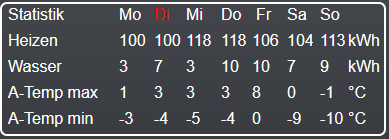

          das binding in der vis:
          {0_userdata.0.CONTROL-OWN.AAATEST.WochenTagFarbe}

            Jetzt muss ich noch die Farbe übergeben. Du hast jetzt für jeden Tag eine andere genommen. Ich möchte es aber so gestalten, dass der Text weiß ist wenn der Tag nicht zutrifft und rot wenn der Tag dem Wochentag entspricht.
            Beispiel: Heute ist Dienstag, als Tag mit der Zahl "2". Es soll nun nur der Text vom Dienstag rot sein, und Mo, Mi, Do, Fr, Sa, So sollen weiß bleiben. Das geht doch sicherlich auch mit Blockly oder?
            Hier mal das Beispiel nur mit dem Wochentag. Die Zahlen darunter würde ich dann auch mit anpassen wollen.

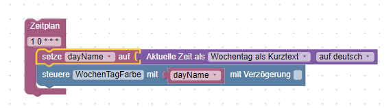

              @flixer
              dann ginge es so - es wird das wochentagkürzel in den dp geschrieben
              und das binding muss dann auf jeden tag angeglichen werden:
              für alle Dienstag-Felder:
              {wert:0_userdata.0.CONTROL-OWN.AAATEST.WochenTagFarbe; wert=="Di" ? "red" : "white"}
              für alle mittwoch-Felder
              {wert:0_userdata.0.CONTROL-OWN.AAATEST.WochenTagFarbe; wert=="Mi" ? "red" : "white"}

                Hallo nochmal,
                so habe es hinbekommen. Hier die Kurzanleitung:
                Ich habe 2 Datenpunkte unter 0_userdata_0 für den "Wochentag als Zahl" und für die "Farbe zum Wochentag" erstellt.
                Anschließend ist in Blockly folgendes entstanden:
                damit wird bei mir um 0:01 Uhr der Tag abgefragt. Ist es Montag wird die Zahl 1 in "Wochentag als Zahl" eingetragen und in "Farbe zum Wochentag" ein Mo als Kurztext zum Wochentag.
                Um die Farbgebung dann im vis zu übergeben wurde folgendes unter "CSS Font & Text -> color" eingetragen:
                {wert:0_userdata.0.Farbe_Wochentag; wert=="Mo" ? "red" : "white"}
                Für die anderen Tage dann jeweils Mo gegen Di, Mi, Do, Fr, Sa und So tauschen.
                Vielen Dank für die Hilfe liv-in-sky!
