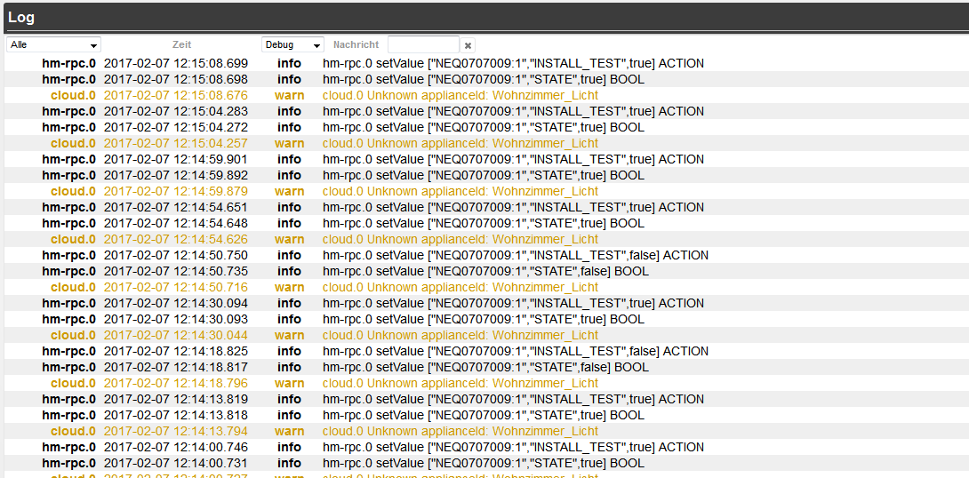

              x1050 last edited by
              hm-rpc.0 2017-02-07 12:15:08.699 info hm-rpc.0 setValue ["NEQ0707009:1","INSTALL_TEST",true] ACTION
              hm-rpc.0 2017-02-07 12:15:08.698 info hm-rpc.0 setValue ["NEQ0707009:1","STATE",true] BOOL
              cloud.0 2017-02-07 12:15:08.676 warn cloud.0 Unknown applianceId: Wohnzimmer_Licht
              hm-rpc.0 2017-02-07 12:15:04.283 info hm-rpc.0 setValue ["NEQ0707009:1","INSTALL_TEST",true] ACTION
              hm-rpc.0 2017-02-07 12:15:04.272 info hm-rpc.0 setValue ["NEQ0707009:1","STATE",true] BOOL
              cloud.0 2017-02-07 12:15:04.257 warn cloud.0 Unknown applianceId: Wohnzimmer_Licht
              hm-rpc.0 2017-02-07 12:14:59.901 info hm-rpc.0 setValue ["NEQ0707009:1","INSTALL_TEST",true] ACTION
              hm-rpc.0 2017-02-07 12:14:59.892 info hm-rpc.0 setValue ["NEQ0707009:1","STATE",true] BOOL
              cloud.0 2017-02-07 12:14:59.879 warn cloud.0 Unknown applianceId: Wohnzimmer_Licht
              hm-rpc.0 2017-02-07 12:14:54.651 info hm-rpc.0 setValue ["NEQ0707009:1","INSTALL_TEST",true] ACTION
              hm-rpc.0 2017-02-07 12:14:54.648 info hm-rpc.0 setValue ["NEQ0707009:1","STATE",true] BOOL
              cloud.0 2017-02-07 12:14:54.626 warn cloud.0 Unknown applianceId: Wohnzimmer_Licht
              hm-rpc.0 2017-02-07 12:14:50.750 info hm-rpc.0 setValue ["NEQ0707009:1","INSTALL_TEST",false] ACTION
              hm-rpc.0 2017-02-07 12:14:50.735 info hm-rpc.0 setValue ["NEQ0707009:1","STATE",false] BOOL
              cloud.0 2017-02-07 12:14:50.716 warn cloud.0 Unknown applianceId: Wohnzimmer_Licht
              hm-rpc.0 2017-02-07 12:14:30.094 info hm-rpc.0 setValue ["NEQ0707009:1","INSTALL_TEST",true] ACTION
              hm-rpc.0 2017-02-07 12:14:30.093 info hm-rpc.0 setValue ["NEQ0707009:1","STATE",true] BOOL
              cloud.0 2017-02-07 12:14:30.044 warn cloud.0 Unknown applianceId: Wohnzimmer_Licht
              hm-rpc.0 2017-02-07 12:14:18.825 info hm-rpc.0 setValue ["NEQ0707009:1","INSTALL_TEST",false] ACTION
              hm-rpc.0 2017-02-07 12:14:18.817 info hm-rpc.0 setValue ["NEQ0707009:1","STATE",false] BOOL
              cloud.0 2017-02-07 12:14:18.796 warn cloud.0 Unknown applianceId: Wohnzimmer_Licht
              hm-rpc.0 2017-02-07 12:14:13.819 info hm-rpc.0 setValue ["NEQ0707009:1","INSTALL_TEST",true] ACTION
              hm-rpc.0 2017-02-07 12:14:13.818 info hm-rpc.0 setValue ["NEQ0707009:1","STATE",true] BOOL
              cloud.0 2017-02-07 12:14:13.794 warn cloud.0 Unknown applianceId: Wohnzimmer_Licht
              hm-rpc.0 2017-02-07 12:14:00.746 info hm-rpc.0 setValue ["NEQ0707009:1","INSTALL_TEST",true] ACTION
              hm-rpc.0 2017-02-07 12:14:00.731 info hm-rpc.0 setValue ["NEQ0707009:1","STATE",true] BOOL
              cloud.0 2017-02-07 12:14:00.727 warn cloud.0 Unknown applianceId: Wohnzimmer_Licht
              hm-rpc.0 2017-02-07 11:09:38.701 info setValue ["NEQ0707009:1","INSTALL_TEST",true] ACTION
              hm-rpc.0 2017-02-07 11:09:35.382 info setValue ["NEQ0707009:1","INSTALL_TEST",true] ACTION
              hm-rpc.0 2017-02-07 10:57:48.317 info setValue ["NEQ0707009:1","INSTALL_TEST",true] ACTION
              hm-rpc.0 2017-02-07 10:57:48.307 info setValue ["NEQ0707009:1","STATE",true] BOOL
              cloud.0 2017-02-07 10:57:48.291 warn Unknown applianceId: Wohnzimmer_Licht
              Screenshot habe ich angehangen
              • Bluefox
                Bluefox last edited by
                Was ist das?
                Hast du versucht zu steuern?
                Kann es sein, dass Deine Geräte noch mal synchronisiert werden sollen.
