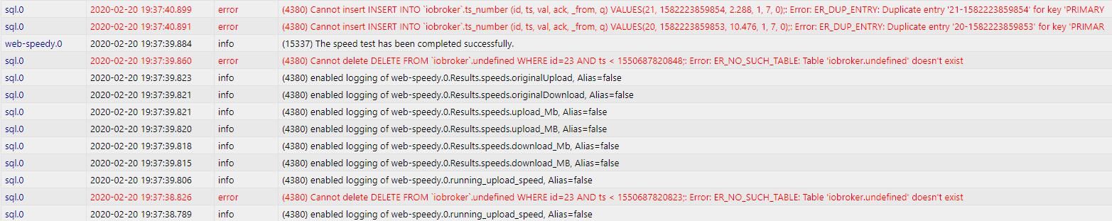

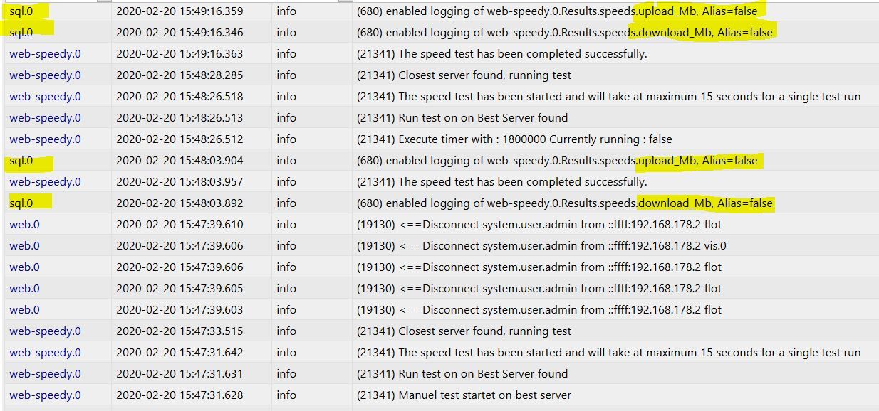

      Hallo Leute vielleicht hat einer von euch ne Idee was das sein könnte. Die Fehler Tauchten auf
      nach dem ich die Objekte von Web-Speedy aufgezeichnet habe.
      Danke schon mal im voraus.
      sql.0	2020-02-20 13:37:37.660	error	(4380) Cannot insert INSERT INTO `iobroker`.ts_number (id, ts, val, ack, _from, q) VALUES(21, 1582202256639, 0.278625, 1, 7, 0);: Error: ER_DUP_ENTRY: Duplicate entry '21-1582202256639' for key 'PRIMA
      web-speedy.0	2020-02-20 13:37:36.672	info	(15337) The speed test has been completed successfully.
      sql.0	2020-02-20 13:37:36.602	info	(4380) enabled logging of web-speedy.0.Results.speeds.originalUpload, Alias=false
      sql.0	2020-02-20 13:37:36.599	info	(4380) enabled logging of web-speedy.0.Results.speeds.originalDownload, Alias=false
      sql.0	2020-02-20 13:37:36.597	info	(4380) enabled logging of web-speedy.0.Results.speeds.upload_Mb, Alias=false
      sql.0	2020-02-20 13:37:36.597	info	(4380) enabled logging of web-speedy.0.Results.speeds.upload_MB, Alias=false
      sql.0	2020-02-20 13:37:36.596	info	(4380) enabled logging of web-speedy.0.Results.speeds.download_Mb, Alias=false
      sql.0	2020-02-20 13:37:36.593	info	(4380) enabled logging of web-speedy.0.Results.speeds.download_MB, Alias=false
      sql.0	2020-02-20 13:37:36.586	info	(4380) enabled logging of web-speedy.0.running_upload_speed, Alias=false
      sql.0	2020-02-20 13:37:35.907	error	(4380) Cannot delete DELETE FROM `iobroker`.undefined WHERE id=23 AND ts < 1550666220904;: Error: ER_NO_SUCH_TABLE: Table 'iobroker.undefined' doesn't exist
      sql.0	2020-02-20 13:37:35.856	info	(4380) enabled logging of web-speedy.0.running_upload_speed, Alias=false
      sql.0	2020-02-20 13:37:34.842	info	(4380) enabled logging of web-speedy.0.running_upload_speed, Alias=false
      sql.0	2020-02-20 13:37:33.521	info	(4380) enabled logging of web-speedy.0.running_upload_speed, Alias=false
      sql.0	2020-02-20 13:37:32.015	info	(4380) enabled logging of web-speedy.0.running_upload_speed, Alias=false
      sql.0	2020-02-20 13:37:31.990	info	(4380) enabled logging of web-speedy.0.running_upload_speed, Alias=false
      sql.0	2020-02-20 13:37:30.144	info	(4380) enabled logging of web-speedy.0.running_upload_speed, Alias=false
      sql.0	2020-02-20 13:37:30.063	info	(4380) enabled logging of web-speedy.0.running_upload_speed, Alias=false
      sql.0	2020-02-20 13:37:28.974	info	(4380) enabled logging of web-speedy.0.running_upload_speed, Alias=false
      sql.0	2020-02-20 13:37:27.918	info	(4380) enabled logging of web-speedy.0.running_upload_speed, Alias=false
      sql.0	2020-02-20 13:37:27.020	info	(4380) enabled logging of web-speedy.0.running_upload_speed, Alias=false
      sql.0	2020-02-20 13:37:25.344	info	(4380) enabled logging of web-speedy.0.running_upload_speed, Alias=false
      sql.0	2020-02-20 13:37:25.311	info	(4380) enabled logging of web-speedy.0.running_upload_speed, Alias=false
      sql.0	2020-02-20 13:37:24.331	info	(4380) enabled logging of web-speedy.0.running_download_speed, Alias=false
      sql.0	2020-02-20 13:37:23.347	info	(4380) enabled logging of web-speedy.0.running_upload_speed, Alias=false
      sql.0	2020-02-20 13:37:23.318	info	(4380) enabled logging of web-speedy.0.running_upload_speed, Alias=false
      sql.0	2020-02-20 13:37:21.228	info	(4380) enabled logging of web-speedy.0.running_download_speed, Alias=false
      sql.0	2020-02-20 13:37:17.329	info	(4380) enabled logging of web-speedy.0.running_download_speed, Alias=false
      sql.0	2020-02-20 13:37:15.784	info	(4380) enabled logging of web-speedy.0.running_download_speed, Alias=false
      sql.0	2020-02-20 13:37:14.629	info	(4380) enabled logging of web-speedy.0.running_download_speed, Alias=false
      sql.0	2020-02-20 13:37:13.075	info	(4380) enabled logging of web-speedy.0.running_download_speed, Alias=false
      sql.0	2020-02-20 13:37:11.298	info	(4380) enabled logging of web-speedy.0.running_download_speed, Alias=false
      sql.0	2020-02-20 13:37:10.877	info	(4380) enabled logging of web-speedy.0.running_download_speed, Alias=false
      sql.0	2020-02-20 13:37:09.580	info	(4380) enabled logging of web-speedy.0.running_download_speed, Alias=false
      sql.0	2020-02-20 13:37:09.369	info	(4380) enabled logging of web-speedy.0.running_download_speed, Alias=false
      sql.0	2020-02-20 13:37:07.772	info	(4380) enabled logging of web-speedy.0.running_download_speed, Alias=false
      sql.0	2020-02-20 13:37:07.648	info	(4380) enabled logging of web-speedy.0.running_download_speed, Alias=false
      sql.0	2020-02-20 13:37:07.045	info	(4380) enabled logging of web-speedy.0.running_download_speed, Alias=false
      sql.0	2020-02-20 13:37:06.983	error	(4380) Cannot delete DELETE FROM `iobroker`.undefined WHERE id=22 AND ts < 1550666220979;: Error: ER_NO_SUCH_TABLE: Table 'iobroker.undefined' doesn't exist
      sql.0	2020-02-20 13:37:06.957	info	(4380) enabled logging of web-speedy.0.running_download_speed, Alias=false
      sql.0	2020-02-20 13:37:06.288	info	(4380) enabled logging of web-speedy.0.running_download_speed, Alias=false
      sql.0	2020-02-20 13:37:06.258	info	(4380) enabled logging of web-speedy.0.running_download_speed, Alias=false
      sql.0	2020-02-20 13:37:05.895	info	(4380) enabled logging of web-speedy.0.running_download_speed, Alias=false
      sql.0	2020-02-20 13:37:05.869	info	(4380) enabled logging of web-speedy.0.running_download_speed, Alias=false
      sql.0	2020-02-20 13:28:56.874	error	(4380) Cannot insert INSERT INTO `iobroker`.ts_number (id, ts, val, ack, _from, q) VALUES(21, 1582201735855, 2.276, 1, 7, 0);: Error: ER_DUP_ENTRY: Duplicate entry '21-1582201735855' for key 'PRIMARY
      sql.0	2020-02-20 13:28:51.315	error	(4380) Cannot delete DELETE FROM `iobroker`.undefined WHERE id=23 AND ts < 1550665680310;: Error: ER_NO_SUCH_TABLE: Table 'iobroker.undefined' doesn't exist

        @Amnesia1211
        Habe auch Web-Speedy in SQL als Aufzeichung eingestellt ,
        bei mir keine Fehler !

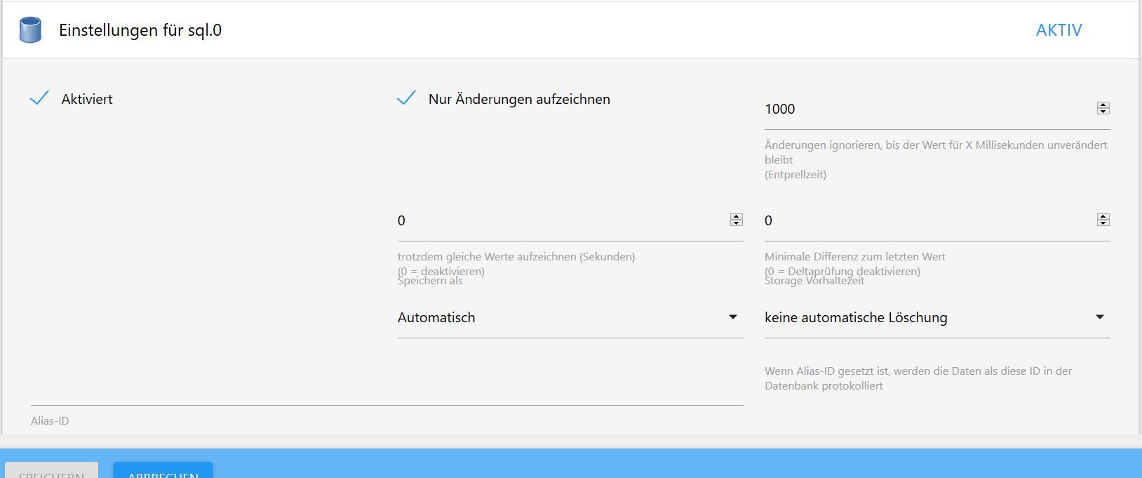

        Das sind meine Einstellungen :
        Du hast ein Fehler , als ob es die Datenbank nicht mehr gibt , bzw. einen andern Wert schreiben will :
        Welche SQL Version von ioBroker hast du .

          @Glasfaser Das ist die Version 1.9.4
          hier meine Einstellungen.

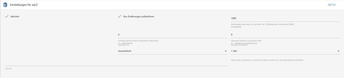

            und die SQL Einstellung von den zwei Datenpunkten !?

              @Glasfaser
              Ne leider kommt der Fehler immer wieder. Bin mir leider auch nicht sicher von welchem Objekt er genau kommt auf jeden Fall ist er erst nach dem
              aufzeichnen der Datenpunkte von Web-Speedy gekommen. Hier noch mal die Einstellungen von den Objekten sind alle gleich Eingestellt.
              Nachtrag:
              Habe die neue Version 1.9.5 die du drauf hast auch mal getestet leider gleiches Problem.

                  • Glasfaser
                    Glasfaser @Amnesia1211 last edited by Glasfaser
                    @Amnesia1211
                    Das kommt aber wie schon erwähnt nicht vom loggen von Web-Speedy .
                    Jetzt währe die Frage was das für Datenpunkte sind .
                    Ich komme da leider nicht weiter .... geht zu sehr in SQL ....
                    Stelle mal den SQL Adapter auf DEBUG und dann poste hier die Ausgabe , vielleicht kann jemand anders weiterhelfen .

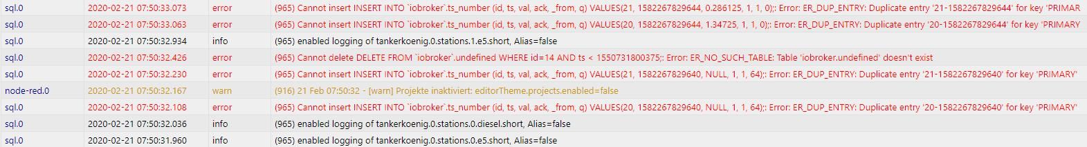

                      @Glasfaser
                      Meinst du das ?
                      sql.0	2020-02-22 06:44:42.844	error	(6496) Cannot insert INSERT INTO `iobroker`.ts_number (id, ts, val, ack, _from, q) VALUES(21, 1582350279599, 0.28425, 1, 1, 0);: Error: ER_DUP_ENTRY: Duplicate entry '21-1582350279599' for key 'PRIMA
                      sql.0	2020-02-22 06:44:42.836	error	(6496) Cannot insert INSERT INTO `iobroker`.ts_number (id, ts, val, ack, _from, q) VALUES(20, 1582350279599, 1.3505, 1, 1, 0);: Error: ER_DUP_ENTRY: Duplicate entry '20-1582350279599' for key 'PRIMAR
                      sql.0	2020-02-22 06:44:41.941	error	(6496) Cannot insert INSERT INTO `iobroker`.ts_number (id, ts, val, ack, _from, q) VALUES(21, 1582350279595, NULL, 1, 1, 64);: Error: ER_DUP_ENTRY: Duplicate entry '21-1582350279595' for key 'PRIMARY
                      sql.0	2020-02-22 06:44:41.935	error	(6496) Cannot insert INSERT INTO `iobroker`.ts_number (id, ts, val, ack, _from, q) VALUES(20, 1582350279595, NULL, 1, 1, 64);: Error: ER_DUP_ENTRY: Duplicate entry '20-1582350279595' for key 'PRIMARY
                      sql.0	2020-02-22 06:44:39.598	info	(6496) enabled logging of web-speedy.0.Results.speeds.originalUpload, Alias=false, 30 points now activated
                      sql.0	2020-02-22 06:44:39.598	info	(6496) enabled logging of web-speedy.0.Results.speeds.originalDownload, Alias=false, 29 points now activated
                      sql.0	2020-02-22 06:44:39.598	info	(6496) enabled logging of web-speedy.0.Results.speeds.upload_Mb, Alias=false, 28 points now activated
                      sql.0	2020-02-22 06:44:39.597	info	(6496) enabled logging of web-speedy.0.Results.speeds.upload_MB, Alias=false, 27 points now activated
                      sql.0	2020-02-22 06:44:39.597	info	(6496) enabled logging of web-speedy.0.Results.speeds.download_Mb, Alias=false, 26 points now activated
                      sql.0	2020-02-22 06:44:39.597	info	(6496) enabled logging of web-speedy.0.Results.speeds.download_MB, Alias=false, 25 points now activated
                      sql.0	2020-02-22 06:44:39.596	info	(6496) enabled logging of web-speedy.0.running_upload_speed, Alias=false, 24 points now activated
                      sql.0	2020-02-22 06:44:39.596	info	(6496) enabled logging of web-speedy.0.running_download_speed, Alias=false, 23 points now activated
                      sql.0	2020-02-22 06:44:39.596	info	(6496) enabled logging of iot.0.services.custom_robert_handy_anwesenheit, Alias=false, 22 points now activated
                      sql.0	2020-02-22 06:44:39.596	info	(6496) enabled logging of iot.0.services.custom_robert_handy, Alias=false, 21 points now activated
                      sql.0	2020-02-22 06:44:39.596	info	(6496) enabled logging of iot.0.services.ifttt, Alias=false, 20 points now activated
                      sql.0	2020-02-22 06:44:39.595	info	(6496) enabled logging of Schalter.0.Zaehler.Zaehler_Tueroeffner, Alias=false, 19 points now activated
                      sql.0	2020-02-22 06:44:39.595	info	(6496) enabled logging of Schalter.0.Zaehler.Zaehler_Tueroeffner_ELW, Alias=false, 18 points now activated
                      sql.0	2020-02-22 06:44:39.595	info	(6496) enabled logging of hm-rpc.0.OEQ0772686.2.POWER, Alias=false, 17 points now activated
                      sql.0	2020-02-22 06:44:39.594	info	(6496) enabled logging of hm-rpc.0.OEQ0772667.2.POWER, Alias=false, 16 points now activated
                      sql.0	2020-02-22 06:44:39.594	info	(6496) enabled logging of hm-rpc.0.OEQ0767641.2.POWER, Alias=false, 15 points now activated
                      sql.0	2020-02-22 06:44:39.594	info	(6496) enabled logging of hm-rpc.0.OEQ0674324.2.TEMPERATURE, Alias=false, 14 points now activated
                      sql.0	2020-02-22 06:44:39.594	info	(6496) enabled logging of hm-rpc.0.OEQ0674324.1.TEMPERATURE, Alias=false, 13 points now activated
                      sql.0	2020-02-22 06:44:39.593	info	(6496) enabled logging of hm-rpc.0.NEQ1012859.1.FILLING_LEVEL, Alias=false, 12 points now activated
                      sql.0	2020-02-22 06:44:39.593	info	(6496) enabled logging of hm-rpc.0.MEQ1725274.1.STATE, Alias=false, 11 points now activated
                      sql.0	2020-02-22 06:44:39.593	info	(6496) enabled logging of hm-rpc.0.MEQ1122654.2.POWER, Alias=false, 10 points now activated
                      sql.0	2020-02-22 06:44:39.593	info	(6496) enabled logging of hm-rpc.0.MEQ1122487.2.POWER, Alias=false, 9 points now activated
                      sql.0	2020-02-22 06:44:39.592	info	(6496) enabled logging of hm-rpc.0.MEQ1121927.2.POWER, Alias=false, 8 points now activated
                      sql.0	2020-02-22 06:44:39.592	info	(6496) enabled logging of hm-rpc.0.MEQ0380526.1.POWER, Alias=false, 7 points now activated
                      sql.0	2020-02-22 06:44:39.592	info	(6496) enabled logging of hm-rpc.0.MEQ0380526.1.ENERGY_COUNTER, Alias=false, 6 points now activated
                      sql.0	2020-02-22 06:44:39.591	info	(6496) enabled logging of tankerkoenig.0.stations.0.e5.short, Alias=false, 5 points now activated
                      sql.0	2020-02-22 06:44:39.591	info	(6496) enabled logging of tankerkoenig.0.stations.0.diesel.short, Alias=false, 4 points now activated
                      sql.0	2020-02-22 06:44:39.591	info	(6496) enabled logging of tankerkoenig.0.stations.1.e5.short, Alias=false, 3 points now activated
                      sql.0	2020-02-22 06:44:39.590	info	(6496) enabled logging of tankerkoenig.0.stations.1.diesel.short, Alias=false, 2 points now activated
                      sql.0	2020-02-22 06:44:39.590	info	(6496) enabled logging of Schalter.0.DigitaleSchalter.Regenanzeige, Alias=false, 1 points now activated
                      sql.0	2020-02-22 06:44:39.537	info	(6496) Connected to mysql
                      sql.0	2020-02-22 06:44:39.355	info	(6496) starting. Version 1.10.0 in /opt/iobroker/node_modules/iobroker.sql, node: v10.19.0
                      host.iobroker	2020-02-22 06:44:36.907	info	instance system.adapter.sql.0 started with pid 6496
                      host.iobroker	2020-02-22 06:44:35.888	info	Restart adapter system.adapter.sql.0 because enabled
                      host.iobroker	2020-02-22 06:44:35.887	info	instance system.adapter.sql.0 terminated with code 0 (NO_ERROR)
                      sql.0	2020-02-22 06:44:35.065	error	(6480) Cannot insert INSERT INTO `iobroker`.ts_number (id, ts, val, ack, _from, q) VALUES(21, 1582350274867, NULL, 0, 1, 64);: Error: ER_DUP_ENTRY: Duplicate entry '21-1582350274867' for key 'PRIMARY
                      sql.0	2020-02-22 06:44:35.064	error	(6480) Cannot insert INSERT INTO `iobroker`.ts_number (id, ts, val, ack, _from, q) VALUES(20, 1582350274867, NULL, 0, 1, 64);: Error: ER_DUP_ENTRY: Duplicate entry '20-1582350274867' for key 'PRIMARY
                      sql.0	2020-02-22 06:44:34.922	error	(6480) Cannot insert INSERT INTO `iobroker`.ts_number (id, ts, val, ack, _from, q) VALUES(21, 1582350274863, 2.274, 1, 1, 0);: Error: ER_DUP_ENTRY: Duplicate entry '21-1582350274863' for key 'PRIMARY
                      sql.0	2020-02-22 06:44:34.918	error	(6480) Cannot insert INSERT INTO `iobroker`.ts_number (id, ts, val, ack, _from, q) VALUES(20, 1582350274863, 10.804, 1, 1, 0);: Error: ER_DUP_ENTRY: Duplicate entry '20-1582350274863' for key 'PRIMAR
