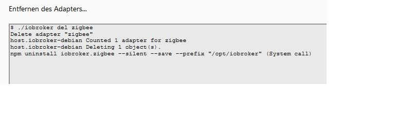

      Jan1 @m0skit0 last edited by
      @m0skit0
      Auf der Adapter Seite hinten auf den Mülleimer klicken, selbstredend😁
      • M
        m0skit0 @Jan1 last edited by m0skit0
        @Jan1
        dann kommt dieser Fehler:
        2019-10-27 10:40:20.355 - info: host.iobroker-debian iobroker npm uninstall iobroker.zigbee --silent --save --prefix "/opt/iobroker" (System call)
        2019-10-27 10:40:21.273 - error: host.iobroker-debian Cannot write files: /opt/iobroker/iobroker-data/files/zigbee.admin/_data.json: ENOENT: no such file or directory, open '/opt/iobroker/iobroker-data/files/zigbee.admin/_data.json'
        2019-10-27 10:40:59.419 - error: host.iobroker-debian iobroker Error deleting adapter zigbee from disk: Error: host.iobroker-debian: Cannot uninstall iobroker.zigbee: 216You might have to delete it yourself!
        host.iobroker-debian	2019-10-27 10:46:51.208	error	iobroker You might have to delete it yourself!
        host.iobroker-debian	2019-10-27 10:46:51.207	error	iobroker Error deleting adapter zigbee from disk: Error: host.iobroker-debian: Cannot uninstall iobroker.zigbee: 216

                            host.iobroker-debian object zigbee.0.info.connection created
                            host.iobroker-debian object zigbee.0.info created
                            host.iobroker-debian object system.adapter.zigbee.0.sigKill created
                            host.iobroker-debian object system.adapter.zigbee.0.eventLoopLag created
                            host.iobroker-debian object system.adapter.zigbee.0.outputCount created
                            host.iobroker-debian object system.adapter.zigbee.0.inputCount created
                            host.iobroker-debian object system.adapter.zigbee.0.uptime created
                            host.iobroker-debian object system.adapter.zigbee.0.memRss created
                            host.iobroker-debian object system.adapter.zigbee.0.memHeapTotal created
                            host.iobroker-debian object system.adapter.zigbee.0.memHeapUsed created
                            host.iobroker-debian object system.adapter.zigbee.0.cputime created
                            host.iobroker-debian object system.adapter.zigbee.0.cpu created
                            host.iobroker-debian object system.adapter.zigbee.0.compactMode created
                            host.iobroker-debian object system.adapter.zigbee.0.connected created
                            host.iobroker-debian object system.adapter.zigbee.0.alive created
                            host.iobroker-debian object system.adapter.zigbee.0 created
                            process exited with code 0
                            hoffe das ist richtig
