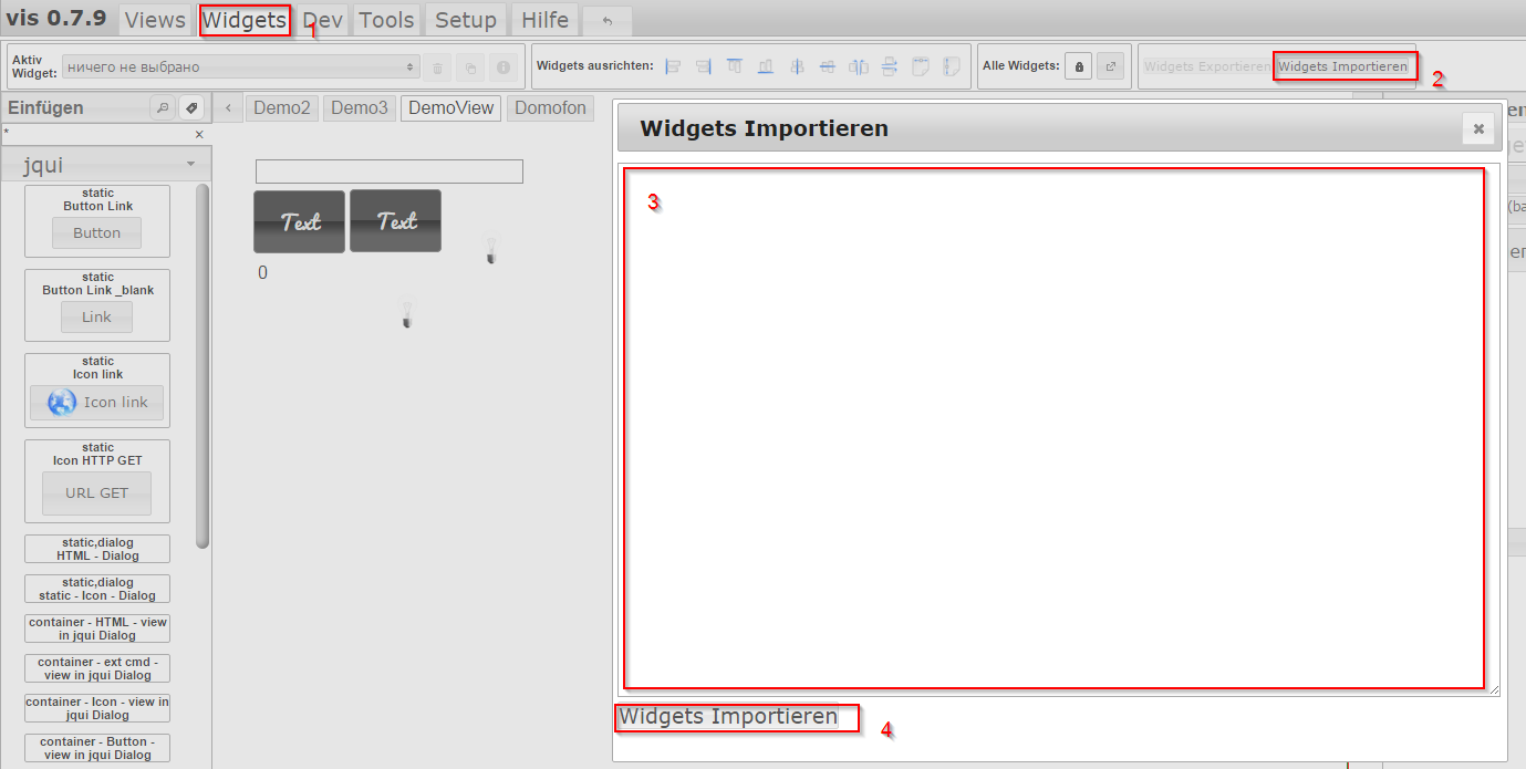

          So was?
          [{"tpl":"tplFrame","data":{"visibility-cond":"==","visibility-val":1,"title":"'Title'","title_color":"#3d54ff",
          "title_top":"-1","title_left":"15","header_height":"0","header_color":"black"},
          "style":{"left":"633px","top":"220px","width":"326px","height":"50px",
          "border-width":"2px","border-style":"solid","border-color":"#ff0f0f",
          "border-radius":"4px","box-shadow":"0px 0px 30px 10px red"},"widgetSet":"basic"}]

            Danke, ja genaus so etwas nur wo füge ich jetzt den Code ein, im Reiter css steht schon was drin?!
            Mfh
            • BluefoxB Offline
              BluefoxB Offline
              So
