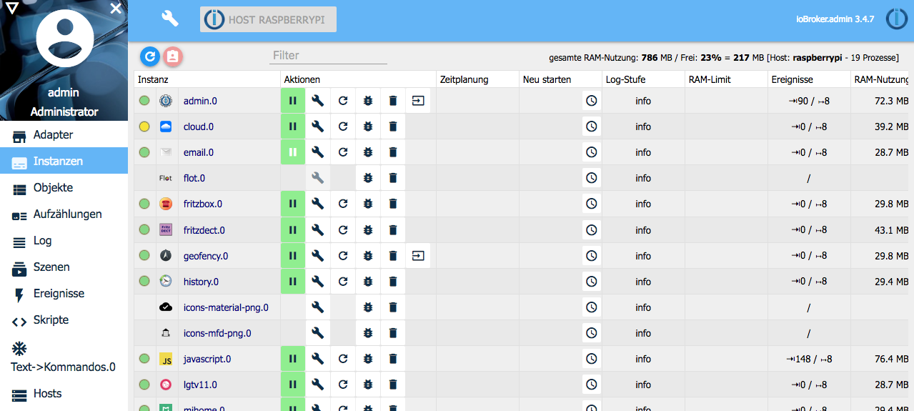

            Hier die Screenshots

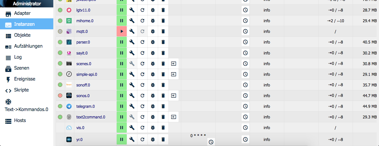

            Hier auch nochmal die Instanzen
            root@raspberrypi:~# iobroker list instances
            system.adapter.admin.0                 : admin       -  enabled, port: 8081, bind: 0.0.0.0, run as: admin
            system.adapter.cloud.0                 : cloud       -  enabled
            system.adapter.email.0                 : email       -  enabled
            system.adapter.flot.0                  : flot        -  enabled
            system.adapter.fritzbox.0              : fritzbox    -  enabled
            system.adapter.fritzdect.0             : fritzdect   -  enabled
            system.adapter.geofency.0              : geofency    -  enabled, port: 7999
            system.adapter.history.0               : history     -  enabled
            system.adapter.icons-material-png.0    : icons-material-png -  enabled
            system.adapter.icons-mfd-png.0         : icons-mfd-png -  enabled
            system.adapter.javascript.0            : javascript  -  enabled
            system.adapter.lgtv11.0                : lgtv11      -  enabled, port: 8080
            system.adapter.material.0              : material    - disabled
            system.adapter.mihome.0                : mihome      -  enabled, port: 9898, bind: 0.0.0.0
            system.adapter.mqtt.0                  : mqtt        - disabled, port: 1884
            system.adapter.parser.0                : parser      -  enabled
            system.adapter.sayit.0                 : sayit       -  enabled, port: 0
            system.adapter.scenes.0                : scenes      -  enabled
            system.adapter.simple-api.0            : simple-api  -  enabled, port: 8087, bind: 0.0.0.0, run as: admin
            system.adapter.sonoff.0                : sonoff      -  enabled, port: 1883, bind: 0.0.0.0
            system.adapter.sonos.0                 : sonos       -  enabled
            system.adapter.telegram.0              : telegram    -  enabled, port: 8443, bind: 0.0.0.0
            system.adapter.text2command.0          : text2command -  enabled
            system.adapter.vis.0                   : vis         -  enabled
            system.adapter.yr.0                    : yr          -  enabled
            root@raspberrypi:~#
