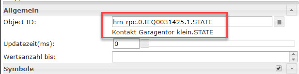

      Hier mal mein Widget zur Anzeige "Auf/Zu":
      [{"tpl":"tplStatefulImage8","data":{"oid":"hm-rpc.0.IEQ0031425.1.STATE","visibility-cond":"==","visibility-val":1,"refreshInterval":"0","count":"","src_1":"/icons-mfd-png/fts_garage.png","visibility-groups-action":"hide","signals-cond-0":"==","signals-val-0":true,"signals-icon-0":"/icons-mfd-png/fts_garage.png","signals-icon-size-0":"115","signals-blink-0":true,"signals-horz-0":"-10","signals-vert-0":"-20","signals-hide-edit-0":false,"signals-cond-1":"==","signals-val-1":"false","signals-icon-1":"/icons-mfd-png/fts_garage_door_100.png","signals-icon-size-1":"115","signals-blink-1":false,"signals-horz-1":"-10","signals-vert-1":"-20","signals-hide-edit-1":false,"signals-cond-2":"==","signals-val-2":"","signals-icon-2":"","signals-icon-size-2":0,"signals-blink-2":false,"signals-horz-2":0,"signals-vert-2":0,"signals-hide-edit-2":false,"name":"Anzeige kleine Garage Auf/Zu","signals-oid-0":"hm-rpc.0.IEQ0031425.1.STATE","signals-oid-1":"hm-rpc.0.IEQ0031425.1.STATE","signals-oid-2":"","g_images":true,"lc-type":"last-change","lc-is-interval":true,"lc-is-moment":false,"lc-format":"","lc-position-vert":"top","lc-position-horz":"right","lc-offset-vert":0,"lc-offset-horz":0,"lc-font-size":"12px","lc-font-family":"","lc-font-style":"","lc-bkg-color":"","lc-color":"","lc-border-width":"0","lc-border-style":"","lc-border-color":"","lc-border-radius":10,"lc-zindex":0},"style":{"left":"548px","top":"548px","width":"100px","height":"88px","border-style":"","border-radius":"","border-color":"","border-width":"","z-index":"4","color":"","background-color":""},"widgetSet":"basic"}]
      Sieht in Vis bei Geschlossener Garage so aus:
      Und wenn die Garage offen ist halt mit offenem Tor.

        Danke für das Widget.
        Das hat leider bei mir nicht so geklappt. Im Edior Modus war nur ein Blinkender Icon zu sehen und im View Modus war gar nichts zu sehen.

          Du hast aber alle Datenpunkte angepasst und die Icons installiert?
          Das Blinken habe ich an damit es etwas mehr ins Auge fällt wenn das Tor auf ist.
