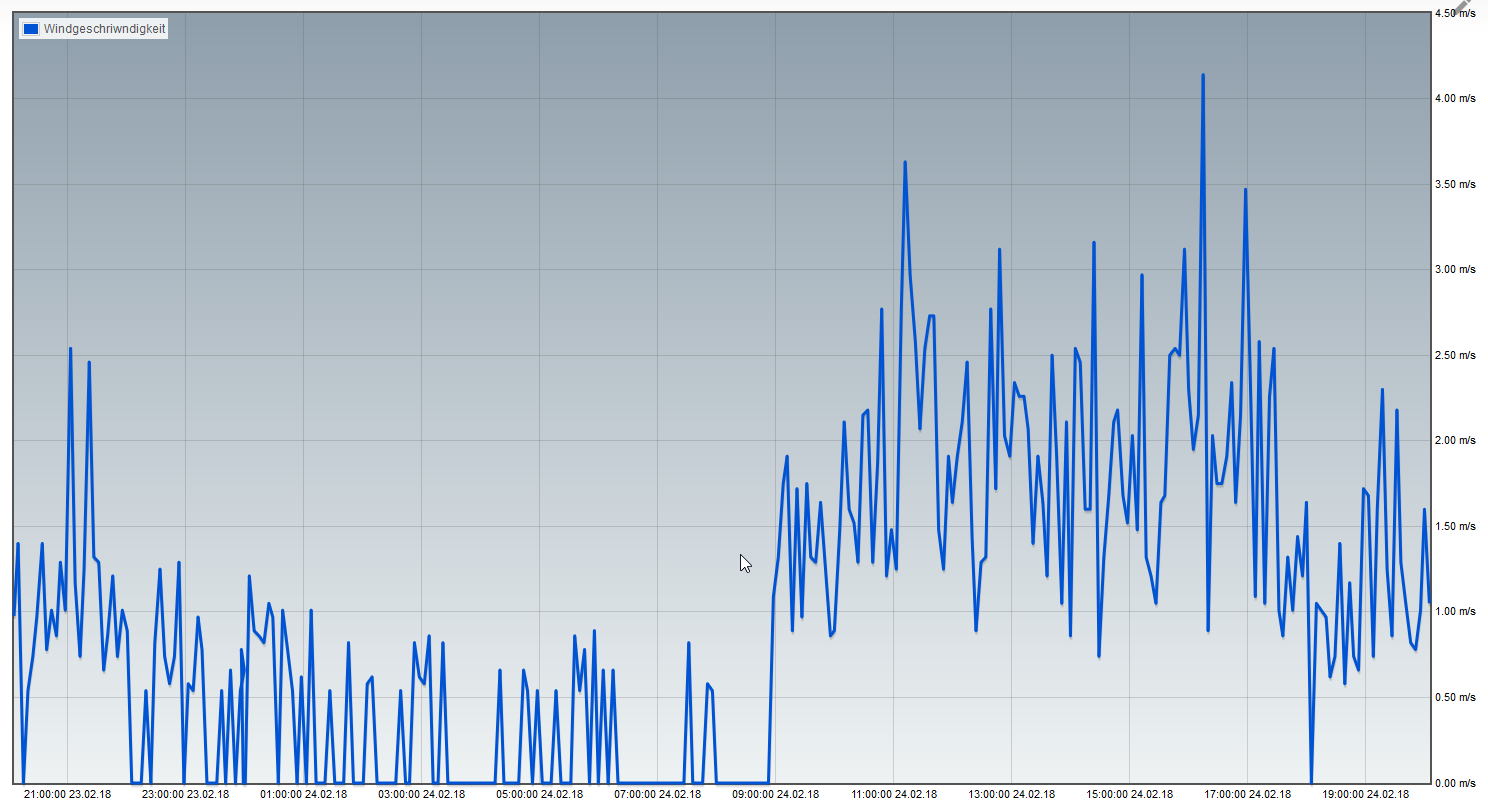

        Du meinst die aktuelle Geschwindigkeit und nicht ein Diagramm, oder?
        Ich hatte vorgestern angefangen mit Flot zu spielen und da einfach mal den Wind hergenommen, das kann dann so aussehen.

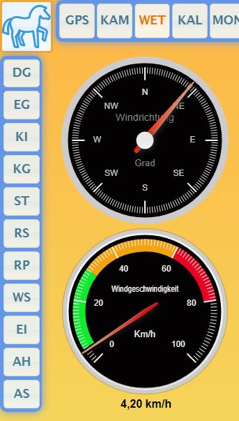

                    Hallo Zusammen,
                    wir verwenden hier das Widget "Canvas-Gauges-Radial" und ….-....-Compass für Windrichtung und Windgeschwindigkeit.
                    Auf dem Dach haben wir die HM-WDS100-C6-O.
                    Hier die Windgeschwindigkeit:
                    [{"tpl":"tplCGradialGauge","data":{"g_fixed":false,"g_visibility":false,"g_css_font_text":false,"g_css_background":false,"g_css_shadow_padding":false,"g_css_border":false,"g_gestures":false,"g_signals":false,"visibility-cond":"==","visibility-val":1,"visibility-groups-action":"hide","factor":"1","valueOffset":"0","hCount":"3","minorTicks":"20","animation":true,"needle":"true","needleShadow":"true","needleType":"arrow","borders":"true","borderOuterWidth":"6","borderMiddleWidth":"2","borderInnerWidth":"2","borderShadowWidth":"2","valueBox":"false","ticksAngle":"270","startAngle":"45","signals-cond-0":"==","signals-val-0":true,"signals-icon-0":"/vis/signals/lowbattery.png","signals-icon-size-0":0,"signals-blink-0":false,"signals-horz-0":0,"signals-vert-0":0,"signals-hide-edit-0":false,"signals-cond-1":"==","signals-val-1":true,"signals-icon-1":"/vis/signals/lowbattery.png","signals-icon-size-1":0,"signals-blink-1":false,"signals-horz-1":0,"signals-vert-1":0,"signals-hide-edit-1":false,"signals-cond-2":"==","signals-val-2":true,"signals-icon-2":"/vis/signals/lowbattery.png","signals-icon-size-2":0,"signals-blink-2":false,"signals-horz-2":0,"signals-vert-2":0,"signals-hide-edit-2":false,"units":"Km/h","oid":"hm-rpc.0.JEQ0651352.1.WIND_SPEED","minValue":0,"maxValue":"100","title":"Windgeschwindigkeit","majorTicks":"","needleCircleInner":false,"needleCircleOuter":false,"highlightsFrom1":"30","highlightsTo1":"60","highlightsColor1":"#f1a40f","highlightsFrom2":"60","highlightsTo2":"80","highlightsColor2":"#e7051f","highlightsFrom3":"5","highlightsTo3":"30","highlightsColor3":"#0eec2d","animationDuration":"3000","animationRule":"quad","animatedValue":false,"colorPlate":"#030202","valueBoxStroke":"12","valueDec":"2","valueInt":"2","colorNeedle":"#e10b0b","colorNumbers":"#f4f3f3","colorUnits":"#f4f3f3","colorTitle":"#f4f3f3","colorMinorTicks":"#f4f3f3","colorMajorTicks":"#f4f3f3","strokeTicks":"false","colorNeedleEnd":"rgba(255,160,122,.9)","colorBorderOuter":"#ccc","colorBorderOuterEnd":"#ccc","colorNeedleShadowDown":"#222","needleStart":"75","needleEnd":"99","needleWidth":"3","valueTextShadow":"false","colorNeedleCircleOuter":"#ccc","needleCircleSize":"15","fontTitleStyle":"normal","fontValueWeight":"","fontTitleSize":"20","fontTitleWeight":"lighter","lc-type":"last-change","lc-is-interval":true,"lc-is-moment":false,"lc-format":"","lc-position-vert":"top","lc-position-horz":"right","lc-offset-vert":0,"lc-offset-horz":0,"lc-font-size":"12px","lc-font-family":"","lc-font-style":"","lc-bkg-color":"","lc-color":"","lc-border-width":"0","lc-border-style":"","lc-border-color":"","lc-border-radius":10,"lc-zindex":0},"style":{"left":"92px","top":"331px","width":"240px","height":"240px"},"widgetSet":"canvas-gauges"}]
                    Hier die Windrichtung:
                    [{"tpl":"tplCGCompas","data":{"g_fixed":false,"g_visibility":false,"g_css_font_text":false,"g_css_background":false,"g_css_shadow_padding":false,"g_css_border":false,"g_gestures":false,"g_signals":false,"visibility-cond":"==","visibility-val":1,"visibility-groups-action":"hide","minValue":"0","maxValue":"360","factor":"1","valueOffset":"0","hCount":"1","majorTicks":"N,NE,E,SE,S,SW,W,NW,N","minorTicks":"22","strokeTicks":"false","animation":"true","animationDuration":"3000","colorPlate":"#030202","colorMajorTicks":"#f5f5f5","colorMinorTicks":"#ddd","colorNumbers":"#ccc","colorNeedle":"#ff1c0b","colorNeedleEnd":"rgba(255,160,122,.9)","colorBorderOuter":"#ccc","colorBorderOuterEnd":"#ccc","colorNeedleShadowDown":"#222","needleType":"arrow","needleStart":"100","needleEnd":"99","needleWidth":"5","borders":"true","borderOuterWidth":"10","borderMiddleWidth":"0","borderInnerWidth":"0","borderShadowWidth":"0","valueBox":"false","valueTextShadow":"false","ticksAngle":"360","startAngle":"180","colorNeedleCircleOuter":"#ccc","needleCircleSize":"15","needleCircleOuter":"false","signals-cond-0":"==","signals-val-0":true,"signals-icon-0":"/vis/signals/lowbattery.png","signals-icon-size-0":0,"signals-blink-0":false,"signals-horz-0":0,"signals-vert-0":0,"signals-hide-edit-0":false,"signals-cond-1":"==","signals-val-1":true,"signals-icon-1":"/vis/signals/lowbattery.png","signals-icon-size-1":0,"signals-blink-1":false,"signals-horz-1":0,"signals-vert-1":0,"signals-hide-edit-1":false,"signals-cond-2":"==","signals-val-2":true,"signals-icon-2":"/vis/signals/lowbattery.png","signals-icon-size-2":0,"signals-blink-2":false,"signals-horz-2":0,"signals-vert-2":0,"signals-hide-edit-2":false,"oid":"hm-rpc.0.JEQ0651352.1.WIND_DIRECTION","units":"Grad","title":"Windrichtung","needleShadow":true,"needle":true,"lc-type":"last-change","lc-is-interval":true,"lc-is-moment":false,"lc-format":"","lc-position-vert":"top","lc-position-horz":"right","lc-offset-vert":0,"lc-offset-horz":0,"lc-font-size":"12px","lc-font-family":"","lc-font-style":"","lc-bkg-color":"","lc-color":"","lc-border-width":"0","lc-border-style":"","lc-border-color":"","lc-border-radius":10,"lc-zindex":0},"style":{"left":"92px","top":"86px","width":"240px","height":"240px"},"widgetSet":"canvas-gauges"}]
                    Die Anzeige der aktuellen Windgeschwindigkeit als Wert erfolgt mittels dem Widget "Basic-Number"
