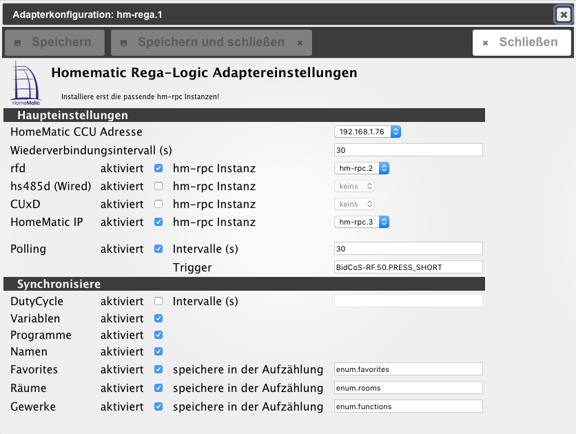

                        So, dann hier meine ersten Rückmeldungen.
                        Im Log finde ich folgendes:
                        iobroker 2017-09-05 20:12:51.242 info exit 0
                        iobroker 2017-09-05 20:12:51.166 info upload [0] hm-rega.admin /opt/iobroker/node_modules/iobroker.hm-rega/admin/homematic.png homematic.png image/png
                        iobroker 2017-09-05 20:12:51.081 info upload [1] hm-rega.admin /opt/iobroker/node_modules/iobroker.hm-rega/admin/index.html index.html text/html
                        iobroker 2017-09-05 20:12:51.054 info got /opt/iobroker/node_modules/iobroker.hm-rega/admin
                        iobroker 2017-09-05 20:12:51.014 info └── request@2.81.0 (tunnel-agent@0.6.0, caseless@0.12.0, safe-buffer@5.1.1, performance-now@0.2.0, uuid@3.1.0, qs@6.4.0, tough-cookie@2.3.2, form-data@2.1.4, har-validator@4.2.1)
                        iobroker 2017-09-05 20:12:51.014 info ├── xml2js@0.4.19 (sax@1.2.4, xmlbuilder@9.0.4)
                        iobroker 2017-09-05 20:12:51.014 info ├── iconv-lite@0.4.18
                        iobroker 2017-09-05 20:12:51.014 info iobroker.hm-rega@1.6.2 iobroker/node_modules/iobroker.hm-rega├── extend@3.0.1
                        iobroker 2017-09-05 20:12:50.743 info npm WARN unmet dependency which is version 0.2.0
                        iobroker 2017-09-05 20:12:50.743 info npm WARN unmet dependency /opt/iobroker/node_modules/iobroker.feiertage/node_modules/request/node_modules/http-signature/node_modules/assert-plus,
                        iobroker 2017-09-05 20:12:50.743 info unmet dependency which is version 0.2.2npm WARN unmet dependency /opt/iobroker/node_modules/iobroker.feiertage/node_modules/request/node_modules/http-signature/node_modules/sshpk requires assert-plus@'^1.0.0' but will load
                        iobroker 2017-09-05 20:12:50.738 info
                        iobroker 2017-09-05 20:12:50.737 info npm WARN unmet dependency /opt/iobroker/node_modules/json-schema,npm WARN
                        iobroker 2017-09-05 20:12:50.736 info npm WARN unmet dependency /opt/iobroker/node_modules/iobroker.feiertage/node_modules/request/node_modules/http-signature/node_modules/jsprim requires json-schema@'0.2.3' but will load
                        iobroker 2017-09-05 20:12:50.734 info npm WARN unmet dependency which is version 0.2.0
                        iobroker 2017-09-05 20:12:50.733 info npm WARN unmet dependency /opt/iobroker/node_modules/iobroker.feiertage/node_modules/request/node_modules/http-signature/node_modules/assert-plus,
                        iobroker 2017-09-05 20:12:50.730 info WARN unmet dependency /opt/iobroker/node_modules/iobroker.feiertage/node_modules/request/node_modules/http-signature/node_modules/jsprim requires assert-plus@'1.0.0' but will load
                        iobroker 2017-09-05 20:12:50.725 info npm
                        iobroker 2017-09-05 20:12:36.020 info npm install https://github.com/AlGu1/ioBroker.hm-rega/tarball/master --production --prefix '/opt/iobroker' (System call)
                        iobroker 2017-09-05 20:12:35.896 info install https://github.com/AlGu1/ioBroker.hm-rega/tarball/master
                        iobroker 2017-09-05 20:12:34.842 info url 'https://github.com/AlGu1/ioBroker.hm-rega' --debug
                        Im Admin-Interface ist zwar die Checkbox da und kann auch angehakt werden, allerdings nimmt das Zeitfeld keine Eingaben an.
                        Und die Schaltflächen für Speichern, use. werden nicht aktiv - ich kann nur abbrechen (ohne Hinweis auf nicht gesicherte Änderungen).

                        • eric2905E Offline
                          eric2905E Offline
                          eric2905
                          Nachtrag / Ergänzung:
                          Nachdem ich den Host reboot habe, kann ich zumindest den Timeout-Wert eintragen (Feld ist jetzt beschreibbar).
                          Aber die Schaltflächen zum Speichern der Änderungen bleiben aus.
                          Ich musste erst einen anderen Wert ändern, um speichern zu können.
                          Die geänderten Werte bleiben im Admin-Interface aber erhalten.
                          Aber die Werte tauchen in den Objekten nicht auf unf ich finde diese Meldung im Log:
                          hm-rega.1	2017-09-05 20:34:16.186	error	Cannot parse answer for dutycycle:
                          Gruß,
                          Eric
                          • A Offline
                            A Offline
                            AlGu
                            Hi Eric,
                            vielen Dank schon mal für das Testen und ich denke ich habe den Fehler für "Cannot parse answer for dutycycle" schon gefunden:
                            Das RaspberryMatic Projekt ist erst mit der Version https://github.com/jens-maus/RaspberryMatic/releases/tag/2.29.22.20170902 in der Lage die "Replace(), LTrim(), RTrim() und Mod()" Befehle zu nutzen.
                            Leider habe ich da nicht genau genug nachgeschaut und dachte wenn die Versionsnummer der CCU das kann (dort sind ab 2.29.18 die Methoden implementiert), dann sollte RaspberryMatic es schon erst recht können. Ich werde Morgen versuchen einen Fix dafür zu bauen, der dann auch auf älteren Versionen läuft.
                            Das mit den "Info"-Einträgen im Log hatte ich bei mir auch. Da muss ich aber ehrlich sagt auf die erfahrenen Adapter-Programmierer hoffen, dass die mir da helfen können.
                            Den Fehler mit dem Bearbeiten der Admin-Seite versuche ich nach zu stellen auf meiner 2. CCU und kann dann vielleicht erkennen woran das liegt.
                            Danke und Gruß
                            AlGu
