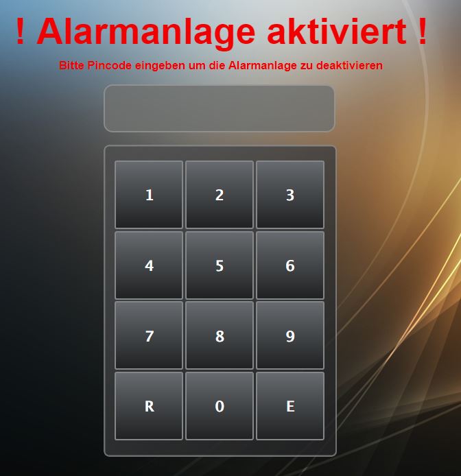

            Dieses habe ich für meine Bedürfnisse ergänzt und bin auch voll zufrieden.
            Und Hier ein Bild wie die Eingabe bei mir in Vis aussieht:
             ![2417_pincode.jpg](/assets/uploads/files/2417_pincode.jpg)
            Wenn ich den Beitrag wieder finde poste ich euch noch den Link.
            Gruß Peoples
            • kmxak
              kmxak Most Active last edited by
              hättest du auch ein widget dazu?
              • Peoples
                Peoples last edited by
                Ein "einziges" Widget nicht.
                Aber hier ein Export meiner View:
                [{},{"tpl":"tplJquiButtonState","data":{"oid":"javascript.0.Alarmanlage.Pin.Unscharfschalten.PinSelect","g_fixed":false,"g_visibility":false,"g_css_font_text":false,"g_css_background":false,"g_css_shadow_padding":false,"g_css_border":false,"g_gestures":true,"g_signals":false,"visibility-cond":"==","visibility-val":1,"visibility-groups-action":"hide","buttontext":"3","signals-cond-0":"==","signals-val-0":true,"signals-icon-0":"/vis/signals/lowbattery.png","signals-icon-size-0":0,"signals-blink-0":false,"signals-horz-0":0,"signals-vert-0":0,"signals-hide-edit-0":false,"signals-cond-1":"==","signals-val-1":true,"signals-icon-1":"/vis/signals/lowbattery.png","signals-icon-size-1":0,"signals-blink-1":false,"signals-horz-1":0,"signals-vert-1":0,"signals-hide-edit-1":false,"signals-cond-2":"==","signals-val-2":true,"signals-icon-2":"/vis/signals/lowbattery.png","signals-icon-size-2":0,"signals-blink-2":false,"signals-horz-2":0,"signals-vert-2":0,"signals-hide-edit-2":false,"no_style":false,"value":"3","gestures-swipeLeft-limit":"-2","views":["Klima","Licht","Strom","System","Fenster"]},"style":{"left":"1066px","top":"372px","width":"150px","height":"150px","z-index":"3","opacity":""},"widgetSet":"jqui"},{"tpl":"tplJquiButtonState","data":{"oid":"javascript.0.Alarmanlage.Pin.Unscharfschalten.PinSelect","g_fixed":true,"g_visibility":false,"g_css_font_text":false,"g_css_background":false,"g_css_shadow_padding":false,"g_css_border":false,"g_gestures":false,"g_signals":false,"visibility-cond":"==","visibility-val":1,"visibility-groups-action":"hide","buttontext":"2","signals-cond-0":"==","signals-val-0":true,"signals-icon-0":"/vis/signals/lowbattery.png","signals-icon-size-0":0,"signals-blink-0":false,"signals-horz-0":0,"signals-vert-0":0,"signals-hide-edit-0":false,"signals-cond-1":"==","signals-val-1":true,"signals-icon-1":"/vis/signals/lowbattery.png","signals-icon-size-1":0,"signals-blink-1":false,"signals-horz-1":0,"signals-vert-1":0,"signals-hide-edit-1":false,"signals-cond-2":"==","signals-val-2":true,"signals-icon-2":"/vis/signals/lowbattery.png","signals-icon-size-2":0,"signals-blink-2":false,"signals-horz-2":0,"signals-vert-2":0,"signals-hide-edit-2":false,"no_style":false,"class":"","value":"2","views":["Klima","Licht","Strom","System","Fenster"]},"style":{"left":"912px","top":"372px","width":"150px","height":"150px","z-index":"3","opacity":""},"widgetSet":"jqui"},{"tpl":"tplJquiButtonState","data":{"oid":"javascript.0.Alarmanlage.Pin.Unscharfschalten.PinSelect","g_fixed":true,"g_visibility":false,"g_css_font_text":false,"g_css_background":false,"g_css_shadow_padding":false,"g_css_border":false,"g_gestures":false,"g_signals":false,"visibility-cond":"==","visibility-val":1,"visibility-groups-action":"hide","buttontext":"5","signals-cond-0":"==","signals-val-0":true,"signals-icon-0":"/vis/signals/lowbattery.png","signals-icon-size-0":0,"signals-blink-0":false,"signals-horz-0":0,"signals-vert-0":0,"signals-hide-edit-0":false,"signals-cond-1":"==","signals-val-1":true,"signals-icon-1":"/vis/signals/lowbattery.png","signals-icon-size-1":0,"signals-blink-1":false,"signals-horz-1":0,"signals-vert-1":0,"signals-hide-edit-1":false,"signals-cond-2":"==","signals-val-2":true,"signals-icon-2":"/vis/signals/lowbattery.png","signals-icon-size-2":0,"signals-blink-2":false,"signals-horz-2":0,"signals-vert-2":0,"signals-hide-edit-2":false,"no_style":false,"class":"","value":"5","views":["Klima","Licht","Strom","System","Fenster"]},"style":{"left":"912px","top":"526px","width":"150px","height":"150px","z-index":"3","opacity":""},"widgetSet":"jqui"},{"tpl":"tplJquiButtonState","data":{"oid":"javascript.0.Alarmanlage.Pin.Unscharfschalten.PinSelect","g_fixed":true,"g_visibility":false,"g_css_font_text":false,"g_css_background":false,"g_css_shadow_padding":false,"g_css_border":false,"g_gestures":false,"g_signals":false,"visibility-cond":"==","visibility-val":1,"visibility-groups-action":"hide","buttontext":"6","signals-cond-0":"==","signals-val-0":true,"signals-icon-0":"/vis/signals/lowbattery.png","signals-icon-size-0":0,"signals-blink-0":false,"signals-horz-0":0,"signals-vert-0":0,"signals-hide-edit-0":false,"signals-cond-1":"==","signals-val-1":true,"signals-icon-1":"/vis/signals/lowbattery.png","signals-icon-size-1":0,"signals-blink-1":false,"signals-horz-1":0,"signals-vert-1":0,"signals-hide-edit-1":false,"signals-cond-2":"==","signals-val-2":true,"signals-icon-2":"/vis/signals/lowbattery.png","signals-icon-size-2":0,"signals-blink-2":false,"signals-horz-2":0,"signals-vert-2":0,"signals-hide-edit-2":false,"no_style":false,"class":"","value":"6","views":["Klima","Licht","Strom","System","Fenster"]},"style":{"left":"1066px","top":"526px","width":"150px","height":"150px","z-index":"3","opacity":""},"widgetSet":"jqui"},{"tpl":"tplJquiButtonState","data":{"oid":"javascript.0.Alarmanlage.Pin.Unscharfschalten.PinSelect","g_fixed":true,"g_visibility":false,"g_css_font_text":false,"g_css_background":false,"g_css_shadow_padding":false,"g_css_border":false,"g_gestures":false,"g_signals":false,"visibility-cond":"==","visibility-val":1,"visibility-groups-action":"hide","buttontext":"7","signals-cond-0":"==","signals-val-0":true,"signals-icon-0":"/vis/signals/lowbattery.png","signals-icon-size-0":0,"signals-blink-0":false,"signals-horz-0":0,"signals-vert-0":0,"signals-hide-edit-0":false,"signals-cond-1":"==","signals-val-1":true,"signals-icon-1":"/vis/signals/lowbattery.png","signals-icon-size-1":0,"signals-blink-1":false,"signals-horz-1":0,"signals-vert-1":0,"signals-hide-edit-1":false,"signals-cond-2":"==","signals-val-2":true,"signals-icon-2":"/vis/signals/lowbattery.png","signals-icon-size-2":0,"signals-blink-2":false,"signals-horz-2":0,"signals-vert-2":0,"signals-hide-edit-2":false,"no_style":false,"class":"","value":"7","views":["Klima","Licht","Strom","System","Fenster"]},"style":{"left":"758px","top":"680px","width":"150px","height":"150px","z-index":"3","opacity":""},"widgetSet":"jqui"},{"tpl":"tplJquiButtonState","data":{"oid":"javascript.0.Alarmanlage.Pin.Unscharfschalten.PinSelect","g_fixed":true,"g_visibility":false,"g_css_font_text":false,"g_css_background":false,"g_css_shadow_padding":false,"g_css_border":false,"g_gestures":false,"g_signals":false,"visibility-cond":"==","visibility-val":1,"visibility-groups-action":"hide","buttontext":"8","signals-cond-0":"==","signals-val-0":true,"signals-icon-0":"/vis/signals/lowbattery.png","signals-icon-size-0":0,"signals-blink-0":false,"signals-horz-0":0,"signals-vert-0":0,"signals-hide-edit-0":false,"signals-cond-1":"==","signals-val-1":true,"signals-icon-1":"/vis/signals/lowbattery.png","signals-icon-size-1":0,"signals-blink-1":false,"signals-horz-1":0,"signals-vert-1":0,"signals-hide-edit-1":false,"signals-cond-2":"==","signals-val-2":true,"signals-icon-2":"/vis/signals/lowbattery.png","signals-icon-size-2":0,"signals-blink-2":false,"signals-horz-2":0,"signals-vert-2":0,"signals-hide-edit-2":false,"no_style":false,"class":"","value":"8","views":["Klima","Licht","Strom","System","Fenster"]},"style":{"left":"912px","top":"680px","width":"150px","height":"150px","z-index":"3","opacity":""},"widgetSet":"jqui"},{"tpl":"tplJquiButtonState","data":{"oid":"javascript.0.Alarmanlage.Pin.Unscharfschalten.PinSelect","g_fixed":true,"g_visibility":false,"g_css_font_text":false,"g_css_background":false,"g_css_shadow_padding":false,"g_css_border":false,"g_gestures":false,"g_signals":false,"visibility-cond":"==","visibility-val":1,"visibility-groups-action":"hide","buttontext":"9","signals-cond-0":"==","signals-val-0":true,"signals-icon-0":"/vis/signals/lowbattery.png","signals-icon-size-0":0,"signals-blink-0":false,"signals-horz-0":0,"signals-vert-0":0,"signals-hide-edit-0":false,"signals-cond-1":"==","signals-val-1":true,"signals-icon-1":"/vis/signals/lowbattery.png","signals-icon-size-1":0,"signals-blink-1":false,"signals-horz-1":0,"signals-vert-1":0,"signals-hide-edit-1":false,"signals-cond-2":"==","signals-val-2":true,"signals-icon-2":"/vis/signals/lowbattery.png","signals-icon-size-2":0,"signals-blink-2":false,"signals-horz-2":0,"signals-vert-2":0,"signals-hide-edit-2":false,"no_style":false,"class":"","value":"9","views":["Klima","Licht","Strom","System","Fenster"]},"style":{"left":"1066px","top":"680px","width":"150px","height":"150px","z-index":"3","opacity":""},"widgetSet":"jqui"},{"tpl":"tplJquiButtonState","data":{"oid":"javascript.0.Alarmanlage.Pin.Unscharfschalten.PinSelect","g_fixed":true,"g_visibility":false,"g_css_font_text":false,"g_css_background":false,"g_css_shadow_padding":false,"g_css_border":false,"g_gestures":false,"g_signals":false,"visibility-cond":"==","visibility-val":1,"visibility-groups-action":"hide","buttontext":"R","signals-cond-0":"==","signals-val-0":true,"signals-icon-0":"/vis/signals/lowbattery.png","signals-icon-size-0":0,"signals-blink-0":false,"signals-horz-0":0,"signals-vert-0":0,"signals-hide-edit-0":false,"signals-cond-1":"==","signals-val-1":true,"signals-icon-1":"/vis/signals/lowbattery.png","signals-icon-size-1":0,"signals-blink-1":false,"signals-horz-1":0,"signals-vert-1":0,"signals-hide-edit-1":false,"signals-cond-2":"==","signals-val-2":true,"signals-icon-2":"/vis/signals/lowbattery.png","signals-icon-size-2":0,"signals-blink-2":false,"signals-horz-2":0,"signals-vert-2":0,"signals-hide-edit-2":false,"no_style":false,"class":"","views":["Klima","Licht","Strom","System","Fenster"],"value":"R"},"style":{"left":"758px","top":"834px","width":"150px","height":"150px","z-index":"3","opacity":""},"widgetSet":"jqui"},{"tpl":"tplJquiButtonState","data":{"oid":"javascript.0.Alarmanlage.Pin.Unscharfschalten.PinSelect","g_fixed":true,"g_visibility":false,"g_css_font_text":false,"g_css_background":false,"g_css_shadow_padding":false,"g_css_border":false,"g_gestures":false,"g_signals":false,"visibility-cond":"==","visibility-val":1,"visibility-groups-action":"hide","buttontext":"0","signals-cond-0":"==","signals-val-0":true,"signals-icon-0":"/vis/signals/lowbattery.png","signals-icon-size-0":0,"signals-blink-0":false,"signals-horz-0":0,"signals-vert-0":0,"signals-hide-edit-0":false,"signals-cond-1":"==","signals-val-1":true,"signals-icon-1":"/vis/signals/lowbattery.png","signals-icon-size-1":0,"signals-blink-1":false,"signals-horz-1":0,"signals-vert-1":0,"signals-hide-edit-1":false,"signals-cond-2":"==","signals-val-2":true,"signals-icon-2":"/vis/signals/lowbattery.png","signals-icon-size-2":0,"signals-blink-2":false,"signals-horz-2":0,"signals-vert-2":0,"signals-hide-edit-2":false,"no_style":false,"class":"","value":"0","views":["Klima","Licht","Strom","System","Fenster"]},"style":{"left":"912px","top":"834px","width":"150px","height":"150px","z-index":"3","opacity":""},"widgetSet":"jqui"},{"tpl":"tplJquiButtonState","data":{"oid":"javascript.0.Alarmanlage.Pin.Unscharfschalten.PinSelect","g_fixed":true,"g_visibility":false,"g_css_font_text":false,"g_css_background":false,"g_css_shadow_padding":false,"g_css_border":false,"g_gestures":false,"g_signals":false,"visibility-cond":"==","visibility-val":1,"visibility-groups-action":"hide","buttontext":"E","signals-cond-0":"==","signals-val-0":true,"signals-icon-0":"/vis/signals/lowbattery.png","signals-icon-size-0":0,"signals-blink-0":false,"signals-horz-0":0,"signals-vert-0":0,"signals-hide-edit-0":false,"signals-cond-1":"==","signals-val-1":true,"signals-icon-1":"/vis/signals/lowbattery.png","signals-icon-size-1":0,"signals-blink-1":false,"signals-horz-1":0,"signals-vert-1":0,"signals-hide-edit-1":false,"signals-cond-2":"==","signals-val-2":true,"signals-icon-2":"/vis/signals/lowbattery.png","signals-icon-size-2":0,"signals-blink-2":false,"signals-horz-2":0,"signals-vert-2":0,"signals-hide-edit-2":false,"no_style":false,"class":"","value":"E","views":["Klima","Licht","Strom","System","Fenster"]},"style":{"left":"1066px","top":"834px","width":"150px","height":"150px","z-index":"3","opacity":""},"widgetSet":"jqui"},{"tpl":"tplJquiButtonState","data":{"oid":"javascript.0.Alarmanlage.Pin.Unscharfschalten.PinSelect","g_fixed":true,"g_visibility":false,"g_css_font_text":false,"g_css_background":false,"g_css_shadow_padding":false,"g_css_border":false,"g_gestures":false,"g_signals":false,"visibility-cond":"==","visibility-val":1,"visibility-groups-action":"hide","buttontext":"1","signals-cond-0":"==","signals-val-0":true,"signals-icon-0":"/vis/signals/lowbattery.png","signals-icon-size-0":0,"signals-blink-0":false,"signals-horz-0":0,"signals-vert-0":0,"signals-hide-edit-0":false,"signals-cond-1":"==","signals-val-1":true,"signals-icon-1":"/vis/signals/lowbattery.png","signals-icon-size-1":0,"signals-blink-1":false,"signals-horz-1":0,"signals-vert-1":0,"signals-hide-edit-1":false,"signals-cond-2":"==","signals-val-2":true,"signals-icon-2":"/vis/signals/lowbattery.png","signals-icon-size-2":0,"signals-blink-2":false,"signals-horz-2":0,"signals-vert-2":0,"signals-hide-edit-2":false,"no_style":false,"class":"","value":"1","views":["Klima"]},"style":{"left":"758px","top":"372px","width":"150px","height":"150px","z-index":"3","opacity":""},"widgetSet":"jqui"},{"tpl":"tplBulbOnOffCtrl","data":{"oid":"hm-rega.0.1234","g_fixed":false,"g_visibility":false,"g_css_font_text":false,"g_css_background":false,"g_css_shadow_padding":false,"g_css_border":false,"g_gestures":false,"g_signals":false,"icon_off":"/vis.0/Wandtablet/img/background/alarm_system/state_off.png","icon_on":"/vis.0/Wandtablet/img/background/alarm_system/state_on.png","signals-cond-0":"==","signals-val-0":true,"signals-icon-0":"/vis/signals/lowbattery.png","signals-icon-size-0":0,"signals-blink-0":false,"signals-horz-0":0,"signals-vert-0":0,"signals-hide-edit-0":false,"signals-cond-1":"==","signals-val-1":true,"signals-icon-1":"/vis/signals/lowbattery.png","signals-icon-size-1":0,"signals-blink-1":false,"signals-horz-1":0,"signals-vert-1":0,"signals-hide-edit-1":false,"signals-cond-2":"==","signals-val-2":true,"signals-icon-2":"/vis/signals/lowbattery.png","signals-icon-size-2":0,"signals-blink-2":false,"signals-horz-2":0,"signals-vert-2":0,"signals-hide-edit-2":false,"min":"","readOnly":true,"views":["Klima","Licht","Strom","System","Fenster"],"visibility-cond":"==","visibility-val":1,"visibility-groups-action":"hide","g_ccontrol":false},"style":{"left":"730px","top":"335px","width":"520px","height":"686px","z-index":"1"},"widgetSet":"basic"},{"tpl":"tplJquiButtonState","data":{"oid":"javascript.0.Alarmanlage.Pin.Unscharfschalten.PinSelect","g_fixed":true,"g_visibility":false,"g_css_font_text":false,"g_css_background":false,"g_css_shadow_padding":false,"g_css_border":false,"g_gestures":false,"g_signals":false,"visibility-cond":"==","visibility-val":1,"visibility-groups-action":"hide","buttontext":"4","signals-cond-0":"==","signals-val-0":true,"signals-icon-0":"/vis/signals/lowbattery.png","signals-icon-size-0":0,"signals-blink-0":false,"signals-horz-0":0,"signals-vert-0":0,"signals-hide-edit-0":false,"signals-cond-1":"==","signals-val-1":true,"signals-icon-1":"/vis/signals/lowbattery.png","signals-icon-size-1":0,"signals-blink-1":false,"signals-horz-1":0,"signals-vert-1":0,"signals-hide-edit-1":false,"signals-cond-2":"==","signals-val-2":true,"signals-icon-2":"/vis/signals/lowbattery.png","signals-icon-size-2":0,"signals-blink-2":false,"signals-horz-2":0,"signals-vert-2":0,"signals-hide-edit-2":false,"no_style":false,"class":"","value":"4","views":["Klima"]},"style":{"left":"758px","top":"526px","width":"150px","height":"150px","z-index":"3","opacity":""},"widgetSet":"jqui"},{"tpl":"tplHtml","data":{"g_fixed":true,"g_visibility":false,"g_css_font_text":true,"g_css_background":false,"g_css_shadow_padding":false,"g_css_border":false,"g_gestures":false,"g_signals":false,"refreshInterval":"0","signals-cond-0":"==","signals-val-0":true,"signals-icon-0":"/vis/signals/lowbattery.png","signals-icon-size-0":0,"signals-blink-0":false,"signals-horz-0":0,"signals-vert-0":0,"signals-hide-edit-0":false,"signals-cond-1":"==","signals-val-1":true,"signals-icon-1":"/vis/signals/lowbattery.png","signals-icon-size-1":0,"signals-blink-1":false,"signals-horz-1":0,"signals-vert-1":0,"signals-hide-edit-1":false,"signals-cond-2":"==","signals-val-2":true,"signals-icon-2":"/vis/signals/lowbattery.png","signals-icon-size-2":0,"signals-blink-2":false,"signals-horz-2":0,"signals-vert-2":0,"signals-hide-edit-2":false,"visibility-cond":"==","visibility-val":1,"visibility-groups-action":"hide","class":"","html":"! Alarmanlage aktiviert !","locked":false},"style":{"left":"538px","top":"43px","width":"937px","height":"100px","z-index":"2","color":"#f00000","font-size":"80px","font-weight":"bold","text-shadow":""},"widgetSet":"basic"},{"tpl":"tplHtml","data":{"g_fixed":true,"g_visibility":false,"g_css_font_text":true,"g_css_background":false,"g_css_shadow_padding":false,"g_css_border":false,"g_gestures":false,"g_signals":false,"refreshInterval":"0","signals-cond-0":"==","signals-val-0":true,"signals-icon-0":"/vis/signals/lowbattery.png","signals-icon-size-0":0,"signals-blink-0":false,"signals-horz-0":0,"signals-vert-0":0,"signals-hide-edit-0":false,"signals-cond-1":"==","signals-val-1":true,"signals-icon-1":"/vis/signals/lowbattery.png","signals-icon-size-1":0,"signals-blink-1":false,"signals-horz-1":0,"signals-vert-1":0,"signals-hide-edit-1":false,"signals-cond-2":"==","signals-val-2":true,"signals-icon-2":"/vis/signals/lowbattery.png","signals-icon-size-2":0,"signals-blink-2":false,"signals-horz-2":0,"signals-vert-2":0,"signals-hide-edit-2":false,"visibility-cond":"==","visibility-val":1,"visibility-groups-action":"hide","class":"","html":"Bitte Pincode eingeben um die Alarmanlage zu deaktivieren","locked":false},"style":{"left":"564px","top":"150px","width":"852px","height":"40px","z-index":"2","color":"#f00000","font-size":"25px","font-weight":"bold","text-align":"center"},"widgetSet":"basic"},{"tpl":"tplValueString","data":{"oid":"javascript.0.Alarmanlage.Pin.Unscharfschalten.PinAnz","g_fixed":false,"g_visibility":false,"g_css_font_text":true,"g_css_background":true,"g_css_shadow_padding":false,"g_css_border":true,"g_gestures":false,"g_signals":false,"visibility-cond":"==","visibility-val":1,"visibility-groups-action":"hide","signals-cond-0":"==","signals-val-0":true,"signals-icon-0":"/vis/signals/lowbattery.png","signals-icon-size-0":0,"signals-blink-0":false,"signals-horz-0":0,"signals-vert-0":0,"signals-hide-edit-0":false,"signals-cond-1":"==","signals-val-1":true,"signals-icon-1":"/vis/signals/lowbattery.png","signals-icon-size-1":0,"signals-blink-1":false,"signals-horz-1":0,"signals-vert-1":0,"signals-hide-edit-1":false,"signals-cond-2":"==","signals-val-2":true,"signals-icon-2":"/vis/signals/lowbattery.png","signals-icon-size-2":0,"signals-blink-2":false,"signals-horz-2":0,"signals-vert-2":0,"signals-hide-edit-2":false,"html_append":"","test_html":"****"},"style":{"left":"734px","top":"205px","border-width":"3px","border-style":"solid","border-color":"#969696","border-radius":"20px","width":"500px","height":"100px","background-color":"#6f716f","opacity":"0.8","color":"#ffffff","text-align":"center","line-height":"180px","font-size":"180px"},"widgetSet":"basic"}]
                Sind letztendlich nur eine Anordnung von Buttons die ich mit CSS grafisch aufgewertet habe.
                Peoples

                                            So siehts bei mir aus…Hab alles raus geschmissen was ich nicht brauch..
                                            funktioniert einwandfrei
                                            Hab das Pin Pad 2 mal .. einmal für stop bzw. rücksetzen während Auslösung und einmal zum deaktivieren.

                                            ![](</s><URL url=)<link_text text="https://uploads.tapatalk-cdn.com/201809 ... 7cd9df.jpg">https://uploads.tapatalk-cdn.com/20180908/edecb9375e9d54b22520a997817cd9df.jpg</link_text>" />![](</s><URL url=)<link_text text="https://uploads.tapatalk-cdn.com/201809 ... 2886a3.jpg">https://uploads.tapatalk-cdn.com/20180908/e94274682ddb4ab61a195dbe022886a3.jpg</link_text>" />~~~~ 6558_unbenannt.png
