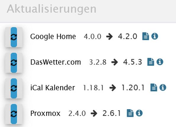

<p dir="auto">folgende Konstellation habe ich:</p>
<pre><code>code_text
Systeminformationen
IOB-124
Plattform
linux
Betriebssystem
linux
Architektur
x64
CPUs
Geschwindigkeit
2196 MHz
Modell
Intel(R) Celeron(R) CPU J3455 @ 1.50GHz
RAM
4 GB
System-Betriebszeit
18:13:32
Node.js
v22.22.3 (Empfohlene Version v18.20.8)
time
1781602744884
timeOffset
-120
NPM
10.9.8
Anzahl der Adapter
615
Datenträgergröße
39.08 GB
freier Festplattenspeicher
16.58 GB
Aktive Instanzen
38
Pfad
/opt/iobroker/
Betriebszeit
18:03:27
Hostname
IOB-124
nodejs -vdr@IOB-124:~$ nodejs -v
v22.22.3
dr@IOB-124:~$ npm -v
10.9.8
Process exited with code 0
Weniger Protokolle
Detailliert
$ iobroker upgrade ical@1.20.1
Update ical from @1.18.1 to @1.20.1
Installing iobroker.ical@1.20.1... (System call)
Updating objects from io-package.json for adapter "ical" with version "1.18.1"
upload [14] ical.admin /opt/iobroker/node_modules/iobroker.ical/admin/i18n/de/translations.json i18n/de/translations.json application/json
upload [13] ical.admin /opt/iobroker/node_modules/iobroker.ical/admin/i18n/en/translations.json i18n/en/translations.json application/json
upload [12] ical.admin /opt/iobroker/node_modules/iobroker.ical/admin/i18n/es/translations.json i18n/es/translations.json application/json
upload [11] ical.admin /opt/iobroker/node_modules/iobroker.ical/admin/i18n/fr/translations.json i18n/fr/translations.json application/json
upload [10] ical.admin /opt/iobroker/node_modules/iobroker.ical/admin/i18n/it/translations.json i18n/it/translations.json application/json
upload [9] ical.admin /opt/iobroker/node_modules/iobroker.ical/admin/i18n/nl/translations.json i18n/nl/translations.json application/json
upload [8] ical.admin /opt/iobroker/node_modules/iobroker.ical/admin/i18n/pl/translations.json i18n/pl/translations.json application/json
upload [7] ical.admin /opt/iobroker/node_modules/iobroker.ical/admin/i18n/pt/translations.json i18n/pt/translations.json application/json
upload [6] ical.admin /opt/iobroker/node_modules/iobroker.ical/admin/i18n/ru/translations.json i18n/ru/translations.json application/json
upload [5] ical.admin /opt/iobroker/node_modules/iobroker.ical/admin/i18n/uk/translations.json i18n/uk/translations.json application/json
upload [4] ical.admin /opt/iobroker/node_modules/iobroker.ical/admin/i18n/zh-cn/translations.json i18n/zh-cn/translations.json application/json
upload [3] ical.admin /opt/iobroker/node_modules/iobroker.ical/admin/ical.png ical.png image/png
upload [2] ical.admin /opt/iobroker/node_modules/iobroker.ical/admin/img/info-big.png img/info-big.png image/png
upload [1] ical.admin /opt/iobroker/node_modules/iobroker.ical/admin/jsonConfig.json jsonConfig.json application/json
upload [0] ical.admin /opt/iobroker/node_modules/iobroker.ical/admin/words.js words.js application/javascript
2026-06-16 11:37:09.400 - info: host.IOB-124 iobroker upgrade ical@1.20.1
2026-06-16 11:37:17.360 - info: host.IOB-124 iobroker Update ical from @1.18.1 to @1.20.1
2026-06-16 11:37:18.627 - info: host.IOB-124 iobroker NPM version: 10.9.8
2026-06-16 11:37:18.628 - info: host.IOB-124 iobroker Installing iobroker.ical@1.20.1... (System call)
2026-06-16 11:37:48.762 - info: host.IOB-124 iobroker Updating objects from io-package.json for adapter "ical" with version "1.18.1"
2026-06-16 11:37:49.407 - info: host.IOB-124 iobroker upload [14] ical.admin /opt/iobroker/node_modules/iobroker.ical/admin/i18n/de/translations.json i18n/de/translations.json application/json
2026-06-16 11:37:49.435 - info: host.IOB-124 iobroker upload [13] ical.admin /opt/iobroker/node_modules/iobroker.ical/admin/i18n/en/translations.json i18n/en/translations.json application/json
2026-06-16 11:37:49.446 - info: host.IOB-124 iobroker upload [12] ical.admin /opt/iobroker/node_modules/iobroker.ical/admin/i18n/es/translations.json i18n/es/translations.json application/json
2026-06-16 11:37:49.465 - info: host.IOB-124 iobroker upload [11] ical.admin /opt/iobroker/node_modules/iobroker.ical/admin/i18n/fr/translations.json i18n/fr/translations.json application/json
2026-06-16 11:37:49.478 - info: host.IOB-124 iobroker upload [10] ical.admin /opt/iobroker/node_modules/iobroker.ical/admin/i18n/it/translations.json i18n/it/translations.json application/json
2026-06-16 11:37:49.493 - info: host.IOB-124 iobroker upload [9] ical.admin /opt/iobroker/node_modules/iobroker.ical/admin/i18n/nl/translations.json i18n/nl/translations.json application/json
2026-06-16 11:37:49.502 - info: host.IOB-124 iobroker upload [8] ical.admin /opt/iobroker/node_modules/iobroker.ical/admin/i18n/pl/translations.json i18n/pl/translations.json application/json
2026-06-16 11:37:49.514 - info: host.IOB-124 iobroker upload [7] ical.admin /opt/iobroker/node_modules/iobroker.ical/admin/i18n/pt/translations.json i18n/pt/translations.json application/json
2026-06-16 11:37:49.522 - info: host.IOB-124 iobroker upload [6] ical.admin /opt/iobroker/node_modules/iobroker.ical/admin/i18n/ru/translations.json i18n/ru/translations.json application/json
2026-06-16 11:37:49.535 - info: host.IOB-124 iobroker upload [5] ical.admin /opt/iobroker/node_modules/iobroker.ical/admin/i18n/uk/translations.json i18n/uk/translations.json application/json
2026-06-16 11:37:49.544 - info: host.IOB-124 iobroker upload [4] ical.admin /opt/iobroker/node_modules/iobroker.ical/admin/i18n/zh-cn/translations.json i18n/zh-cn/translations.json application/json
2026-06-16 11:37:49.558 - info: host.IOB-124 iobroker upload [3] ical.admin /opt/iobroker/node_modules/iobroker.ical/admin/ical.png ical.png image/png
2026-06-16 11:37:49.566 - info: host.IOB-124 iobroker upload [2] ical.admin /opt/iobroker/node_modules/iobroker.ical/admin/img/info-big.png img/info-big.png image/png
2026-06-16 11:37:49.574 - info: host.IOB-124 iobroker upload [1] ical.admin /opt/iobroker/node_modules/iobroker.ical/admin/jsonConfig.json jsonConfig.json application/json
2026-06-16 11:37:49.588 - info: host.IOB-124 iobroker upload [0] ical.admin /opt/iobroker/node_modules/iobroker.ical/admin/words.js words.js application/javascript
2026-06-16 11:37:50.644 - info: host.IOB-124 iobroker exit 0
</code></pre>
<p dir="auto"><img src="/assets/uploads/files/1781603943882-1f32f8c6-fdb1-4b54-a40c-6ae7c2bf7ecd-image.jpeg" alt="1f32f8c6-fdb1-4b54-a40c-6ae7c2bf7ecd-image.jpeg" class=" img-fluid img-markdown" /><br />
Jedoch kann ich kein Update mehr fahren! Wiso ?</p>
<p dir="auto">Kann jemand das Problem identifizieren?</p>
<p dir="auto">Danke.</p>
<p dir="auto">VG</p>

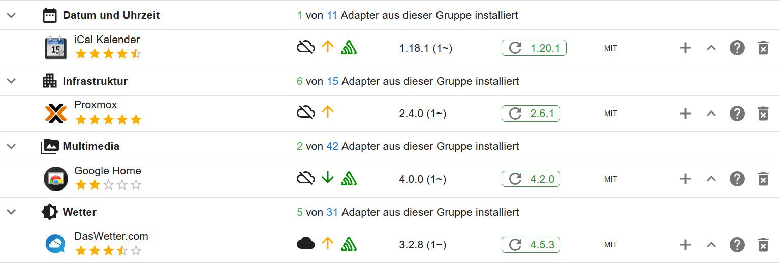

dr@IOB-124:/$ iob upgrade chromecast --debug
This upgrade of "chromecast" will introduce the following changes:
-&gt; 4.2.0:
Adapter requires node.js &gt;= 22 now
Adapter requires admin &gt;= 7.7.22 now
Logging technical deatils reduced to debug level
Dependencies have been updated
-&gt; 4.1.1:
Linting has been updated to @iobroker/eslint-config
-&gt; 4.1.0:
Adapetr requires node.js &gt;= 20 now
Adapter requires js-controller &gt;= 6.0.11 now
Adapter requires admin &gt;= 7.6.17 now
Would you like to upgrade chromecast from @4.0.0 to @4.2.0 now? [(y)es, (n)o]: y
Update chromecast from @4.0.0 to @4.2.0
NPM version: 10.9.8
Installing iobroker.chromecast@4.2.0... (System call)
npm error code EBADENGINE
npm error engine Unsupported engine
npm error engine Not compatible with your version of node/npm: fluidd@1.27.1
npm error notsup Not compatible with your version of node/npm: fluidd@1.27.1
npm error notsup Required: {"node":"^18 || ^20"}
npm error notsup Actual:   {"npm":"10.9.8","node":"v22.22.3"}
npm error A complete log of this run can be found in: /home/iobroker/.npm/_logs/2026-06-16T15_32_50_824Z-debug-0.log
Adapter "system.adapter.vis.0" restarted.
Updating objects from io-package.json for adapter "chromecast" with version "4.0.0"
upload [13] chromecast.admin /opt/iobroker/node_modules/iobroker.chromecast/admin/chromecast.png chromecast.png image/png
upload [12] chromecast.admin /opt/iobroker/node_modules/iobroker.chromecast/admin/home.png home.png image/png
upload [11] chromecast.admin /opt/iobroker/node_modules/iobroker.chromecast/admin/i18n/de/translations.json i18n/de/translations.json application/json
upload [10] chromecast.admin /opt/iobroker/node_modules/iobroker.chromecast/admin/i18n/en/translations.json i18n/en/translations.json application/json
upload [9] chromecast.admin /opt/iobroker/node_modules/iobroker.chromecast/admin/i18n/es/translations.json i18n/es/translations.json application/json
upload [8] chromecast.admin /opt/iobroker/node_modules/iobroker.chromecast/admin/i18n/fr/translations.json i18n/fr/translations.json application/json
upload [7] chromecast.admin /opt/iobroker/node_modules/iobroker.chromecast/admin/i18n/it/translations.json i18n/it/translations.json application/json
upload [6] chromecast.admin /opt/iobroker/node_modules/iobroker.chromecast/admin/i18n/nl/translations.json i18n/nl/translations.json application/json
upload [5] chromecast.admin /opt/iobroker/node_modules/iobroker.chromecast/admin/i18n/pl/translations.json i18n/pl/translations.json application/json
upload [4] chromecast.admin /opt/iobroker/node_modules/iobroker.chromecast/admin/i18n/pt/translations.json i18n/pt/translations.json application/json
upload [3] chromecast.admin /opt/iobroker/node_modules/iobroker.chromecast/admin/i18n/ru/translations.json i18n/ru/translations.json application/json
upload [2] chromecast.admin /opt/iobroker/node_modules/iobroker.chromecast/admin/i18n/zh-cn/translations.json i18n/zh-cn/translations.json application/json
upload [1] chromecast.admin /opt/iobroker/node_modules/iobroker.chromecast/admin/index_m.html index_m.html text/html
upload [0] chromecast.admin /opt/iobroker/node_modules/iobroker.chromecast/admin/words.js words.js application/javascript
dr@IOB-124:/$
</code></pre>

<p dir="auto"><a class="plugin-mentions-user plugin-mentions-a" href="/user/blrd" aria-label="Profile: BLRD">@<bdi>BLRD</bdi></a> <a href="/post/1344747">sagte</a>:</p>
<p dir="auto">+-- canvas@2.9.1 (git+ssh://git@github.com/Automattic/node-canvas.git#9d8da5bf1a272ee3e14637feeef545b622822a03)<br />
+-- fluidd@1.27.1 (git+ssh://git@github.com/fluidd-core/fluidd.git#cad1a10630e1304124d10f5ecf0b78f4e0d4ca6c)</p>
</blockquote>
<p dir="auto">Schmeiß die mal raus. Auf der ersten Ebene sollte nichts liegen, was nicht iobroker.XYZ heißt.</p>

<p dir="auto">weil das Update immer noch angezeigt wird.</p>
<p dir="auto"><img src="/assets/uploads/files/1781615874980-78748188-3291-47e4-8798-ac774ab551a1-image.jpeg" alt="78748188-3291-47e4-8798-ac774ab551a1-image.jpeg" class=" img-fluid img-markdown" /></p>
<p dir="auto">Rest folgt.</p>

This upgrade of "daswetter" will at least introduce the following changes:
-&gt; 4.5.3:
solved lint errors and warnings based on adapter checker
dependency updates and fixes based on adapter checker recommendations
-&gt; 4.5.1:
bug fix: wind url was not set if wind speed was zero
bug fix: save selected icon type (svg, png or gif) in admin
-&gt; 4.5.0:
show symbol description beside the symbol in admin as preview
see issue #480: set minimum interval for data request to 60 minutes to avoid too many requests
new icons (png only) added (thanks to forum member Negalein)
see issue #478. bug fix copy current data at midnight
see issue #492: rate limiter: check expired time of last request before new request
see issue #490: icon file extension selectable in admin (svg, png or gif)
-&gt; 4.4.1:
*Attention:** The folder structure for the icons has changed. A few icon sets are already available, but others are still missing. If anyone would like to contribute their icons, please contact me.
new folder structure for weather, wind and moon icons
-&gt; 4.3.0:
41 icons for DasWetter@4.x (galeria7)
-&gt; 4.2.0:
translations of symbol descriptions
some new datapoints (time and date) to identify forecast periods
see issue #462: sun and moon times now without date part (time-only)
Add bundesland / state as search option and move some debug to info logs
-&gt; 4.1.0:
see issue #457: forecast download for daily and hourly can now be disabled to reduce number of DP's
see issue #456: combination of postcode and free text search for location API added, if location not found by postcode a free text search is executed
see issue #458: unit for pressure changed to millibar / hPa
see issue #459: bug fix to be able to edit custom path for moon symbols
if API provides night specific symbol description, it will be shown now
datapoint descriptions changed
BE CAREFUL: THIS IS A MAJOR UPGRADE, WHICH WILL MOST LIKELY INTRODUCE BREAKING CHANGES!
Would you like to upgrade daswetter from @3.2.8 to @4.5.3 now? [(y)es, (n)o]: y
Update daswetter from @3.2.8 to @4.5.3
NPM version: 10.9.8
Installing iobroker.daswetter@4.5.3... (System call)
Updating objects from io-package.json for adapter "daswetter" with version "3.2.8"
Update "system.adapter.daswetter.0"
upload [493] daswetter.admin /opt/iobroker/node_modules/iobroker.daswetter/admin/daswettercom.png daswettercom.png image/png
upload [450] daswetter.admin /opt/iobroker/node_modules/iobroker.daswetter/admin/icons/tiempo-weather/galeria1/10.png icons/tiempo-weather/galeria1/10.png image/png
upload [400] daswetter.admin /opt/iobroker/node_modules/iobroker.daswetter/admin/icons/tiempo-weather/galeria3/19.png icons/tiempo-weather/galeria3/19.png image/png
upload [350] daswetter.admin /opt/iobroker/node_modules/iobroker.daswetter/admin/icons/tiempo-weather/galeria5/PNG/White/1.png icons/tiempo-weather/galeria5/PNG/White/1.png image/png
upload [300] daswetter.admin /opt/iobroker/node_modules/iobroker.daswetter/admin/icons/tiempo-weather/galeria5/SVG/White/15.svg icons/tiempo-weather/galeria5/SVG/White/15.svg image/svg+xml
upload [250] daswetter.admin /opt/iobroker/node_modules/iobroker.daswetter/admin/icons/tiempo-weather/galeria6/5.png icons/tiempo-weather/galeria6/5.png image/png
upload [200] daswetter.admin /opt/iobroker/node_modules/iobroker.daswetter/admin/icons/viento-wind/Beaufort-White/41.png icons/viento-wind/Beaufort-White/41.png image/png
upload [150] daswetter.admin /opt/iobroker/node_modules/iobroker.daswetter/admin/icons/viento-wind/Beaufort-White/87.png icons/viento-wind/Beaufort-White/87.png image/png
upload [100] daswetter.admin /opt/iobroker/node_modules/iobroker.daswetter/admin/icons/viento-wind/galeria2-Beaufort/104.png icons/viento-wind/galeria2-Beaufort/104.png image/png
upload [90] daswetter.admin /opt/iobroker/node_modules/iobroker.daswetter/admin/icons/viento-wind/galeria2-Beaufort/2.png icons/viento-wind/galeria2-Beaufort/2.png image/png
upload [80] daswetter.admin /opt/iobroker/node_modules/iobroker.daswetter/admin/icons/viento-wind/galeria2-Beaufort/29.png icons/viento-wind/galeria2-Beaufort/29.png image/png
upload [70] daswetter.admin /opt/iobroker/node_modules/iobroker.daswetter/admin/icons/viento-wind/galeria2-Beaufort/38.png icons/viento-wind/galeria2-Beaufort/38.png image/png
upload [60] daswetter.admin /opt/iobroker/node_modules/iobroker.daswetter/admin/icons/viento-wind/galeria2-Beaufort/47.png icons/viento-wind/galeria2-Beaufort/47.png image/png
upload [50] daswetter.admin /opt/iobroker/node_modules/iobroker.daswetter/admin/icons/viento-wind/galeria2-Beaufort/56.png icons/viento-wind/galeria2-Beaufort/56.png image/png
upload [40] daswetter.admin /opt/iobroker/node_modules/iobroker.daswetter/admin/icons/viento-wind/galeria2-Beaufort/65.png icons/viento-wind/galeria2-Beaufort/65.png image/png
upload [30] daswetter.admin /opt/iobroker/node_modules/iobroker.daswetter/admin/icons/viento-wind/galeria2-Beaufort/74.png icons/viento-wind/galeria2-Beaufort/74.png image/png
upload [20] daswetter.admin /opt/iobroker/node_modules/iobroker.daswetter/admin/icons/viento-wind/galeria2-Beaufort/83.png icons/viento-wind/galeria2-Beaufort/83.png image/png
upload [19] daswetter.admin /opt/iobroker/node_modules/iobroker.daswetter/admin/icons/viento-wind/galeria2-Beaufort/84.png icons/viento-wind/galeria2-Beaufort/84.png image/png
upload [18] daswetter.admin /opt/iobroker/node_modules/iobroker.daswetter/admin/icons/viento-wind/galeria2-Beaufort/85.png icons/viento-wind/galeria2-Beaufort/85.png image/png
upload [17] daswetter.admin /opt/iobroker/node_modules/iobroker.daswetter/admin/icons/viento-wind/galeria2-Beaufort/86.png icons/viento-wind/galeria2-Beaufort/86.png image/png
upload [16] daswetter.admin /opt/iobroker/node_modules/iobroker.daswetter/admin/icons/viento-wind/galeria2-Beaufort/87.png icons/viento-wind/galeria2-Beaufort/87.png image/png
upload [15] daswetter.admin /opt/iobroker/node_modules/iobroker.daswetter/admin/icons/viento-wind/galeria2-Beaufort/88.png icons/viento-wind/galeria2-Beaufort/88.png image/png
upload [14] daswetter.admin /opt/iobroker/node_modules/iobroker.daswetter/admin/icons/viento-wind/galeria2-Beaufort/89.png icons/viento-wind/galeria2-Beaufort/89.png image/png
upload [13] daswetter.admin /opt/iobroker/node_modules/iobroker.daswetter/admin/icons/viento-wind/galeria2-Beaufort/9.png icons/viento-wind/galeria2-Beaufort/9.png image/png
upload [12] daswetter.admin /opt/iobroker/node_modules/iobroker.daswetter/admin/icons/viento-wind/galeria2-Beaufort/90.png icons/viento-wind/galeria2-Beaufort/90.png image/png
upload [11] daswetter.admin /opt/iobroker/node_modules/iobroker.daswetter/admin/icons/viento-wind/galeria2-Beaufort/91.png icons/viento-wind/galeria2-Beaufort/91.png image/png
upload [10] daswetter.admin /opt/iobroker/node_modules/iobroker.daswetter/admin/icons/viento-wind/galeria2-Beaufort/92.png icons/viento-wind/galeria2-Beaufort/92.png image/png
upload [9] daswetter.admin /opt/iobroker/node_modules/iobroker.daswetter/admin/icons/viento-wind/galeria2-Beaufort/93.png icons/viento-wind/galeria2-Beaufort/93.png image/png
upload [8] daswetter.admin /opt/iobroker/node_modules/iobroker.daswetter/admin/icons/viento-wind/galeria2-Beaufort/94.png icons/viento-wind/galeria2-Beaufort/94.png image/png
upload [7] daswetter.admin /opt/iobroker/node_modules/iobroker.daswetter/admin/icons/viento-wind/galeria2-Beaufort/95.png icons/viento-wind/galeria2-Beaufort/95.png image/png
upload [6] daswetter.admin /opt/iobroker/node_modules/iobroker.daswetter/admin/icons/viento-wind/galeria2-Beaufort/96.png icons/viento-wind/galeria2-Beaufort/96.png image/png
upload [5] daswetter.admin /opt/iobroker/node_modules/iobroker.daswetter/admin/icons/viento-wind/galeria2-Beaufort/97.png icons/viento-wind/galeria2-Beaufort/97.png image/png
upload [4] daswetter.admin /opt/iobroker/node_modules/iobroker.daswetter/admin/icons/viento-wind/galeria2-Beaufort/98.png icons/viento-wind/galeria2-Beaufort/98.png image/png
upload [3] daswetter.admin /opt/iobroker/node_modules/iobroker.daswetter/admin/icons/viento-wind/galeria2-Beaufort/99.png icons/viento-wind/galeria2-Beaufort/99.png image/png
upload [2] daswetter.admin /opt/iobroker/node_modules/iobroker.daswetter/admin/index_m.html index_m.html text/html
upload [1] daswetter.admin /opt/iobroker/node_modules/iobroker.daswetter/admin/jsonConfig.json5 jsonConfig.json5 application/json5
upload [0] daswetter.admin /opt/iobroker/node_modules/iobroker.daswetter/admin/words.js words.js application/javascript
-&gt; 4.2.0:
-&gt; 4.1.1:
-&gt; 4.1.0:
NPM version: 10.9.8

ioBroker-Adapter Versions and update status
Used repository: stable
Adapter    "admin"        : 7.8.23   , installed 7.8.23
Adapter    "alexa2"       : 3.27.4   , installed 3.27.4
Adapter    "backitup"     : 3.3.17   , installed 3.3.17
Adapter    "chromecast"   : 4.2.0    , installed 4.0.0  [Updatable]
Adapter    "cloud"        : 6.0.1    , installed 6.0.1
Adapter    "daswetter"    : 4.5.3    , installed 3.2.8  [Updatable]
Adapter    "discovergy"   : 0.6.0    , installed 0.6.0
Adapter    "echarts"      : 3.1.0    , installed 3.1.0
Adapter    "email"        : 2.0.4    , installed 2.0.4
Adapter    "enigma2"      : 2.3.0    , installed 2.3.0
Adapter    "fb-checkpresence": 1.4.2 , installed 1.4.2
Adapter    "ford"         : 1.0.4    , installed 1.0.5
Adapter    "fritzbox"     : 0.7.0    , installed 0.7.0
Adapter    "fritzdect"    : 2.6.2    , installed 2.6.2
Adapter    "history"      : 4.0.0    , installed 4.0.0
Adapter    "homee"        : 1.2.0    , installed 1.2.0
Adapter    "ical"         : 1.20.1   , installed 1.18.1 [Updatable]
Adapter    "icons-addictive-flavour-png": 0.1.0, installed 0.1.0
Adapter    "icons-fatcow-hosting": 0.1.0, installed 0.1.0
Adapter    "icons-icons8" : 0.0.1    , installed 0.0.1
Adapter    "icons-material-png": 0.1.0, installed 0.1.0
Adapter    "icons-material-svg": 0.1.0, installed 0.1.0
Adapter    "icons-open-icon-library-png": 0.1.2, installed 0.1.3
Adapter    "iot"          : 6.0.3    , installed 6.0.3
Adapter    "iqontrol"     : 3.0.0    , installed 3.0.0
Adapter    "jarvis"       : 3.1.8    , installed 3.2.0-rc.5
Adapter    "javascript"   : 9.0.18   , installed 9.0.18
Controller "js-controller": 7.1.2    , installed 7.1.2
Adapter    "lovelace"     : 5.0.5    , installed 5.0.5
Adapter    "mihome-vacuum": 5.2.0    , installed 5.2.0
Adapter    "moma"         : 1.2.9    , installed 1.2.9
Adapter    "net-tools"    : 1.2.3    , installed 1.2.3
Adapter    "netatmo"      : 3.1.0    , installed 3.1.0
Adapter    "nina"         : 0.0.25   , installed 0.0.26
Adapter    "node-red"     : 6.0.7    , installed 6.0.7
Adapter    "onvif"        : 1.1.4    , installed 1.1.4
Adapter    "pi-hole"      : 2.0.0    , installed 2.0.0
Adapter    "pi-hole2"     : 1.1.1    , installed 1.1.1
Adapter    "ping"         : 1.7.9    , installed 1.7.9
Adapter    "pollenflug"   : 2.0.0    , installed 2.0.0
Adapter    "proxmox"      : 2.6.1    , installed 2.4.0  [Updatable]
Adapter    "shelly"       : 10.6.1   , installed 10.6.1
Adapter    "simple-api"   : 3.0.7    , installed 3.0.7
Adapter    "socketio"     : 7.1.3    , installed 7.1.3
Adapter    "sonoff"       : 3.3.0    , installed 3.3.0
Adapter    "synology"     : 3.1.0    , installed 3.1.0
Adapter    "tankerkoenig" : 3.4.0    , installed 3.4.0
Adapter    "upnp"         : 1.1.0    , installed 1.1.0
Adapter    "vis-2"        : 2.13.8   , installed 2.13.8
Adapter    "vis-google-fonts": 1.0.4 , installed 1.0.4
Adapter    "vis-hqwidgets": 1.6.1    , installed 1.6.1
Adapter    "vis-jqui-mfd" : 1.1.3    , installed 1.1.3
Adapter    "vis-keyboard" : 0.0.3    , installed 0.0.3
Adapter    "weatherunderground": 3.7.0, installed 3.7.0
Adapter    "web"          : 8.0.0    , installed 8.0.0
Adapter    "wled"         : 0.7.3    , installed 0.7.3
Adapter    "ws"           : 4.1.0    , installed 4.1.0
Adapter    "zigbee"       : 3.3.5    , installed 3.3.5

Jedoch ohne Erfolg!
Danke</code></pre>
