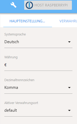

                                        wie stelle ich um? löschen darf ich default ja nicht?
                                        Homoran Thomas Braun 2 Replies Last reply Reply Quote 0
                                        • Homoran
                                          Homoran Global Moderator Administrators @Humidor last edited by
                                          @Humidor https://www.iobroker.net/#de/documentation/admin/settings.md?haupteinstellungen
                                          • Thomas Braun
                                            Thomas Braun Most Active @Humidor last edited by
                                            @Humidor
                                            Humidor 1 Reply Last reply Reply Quote 0
